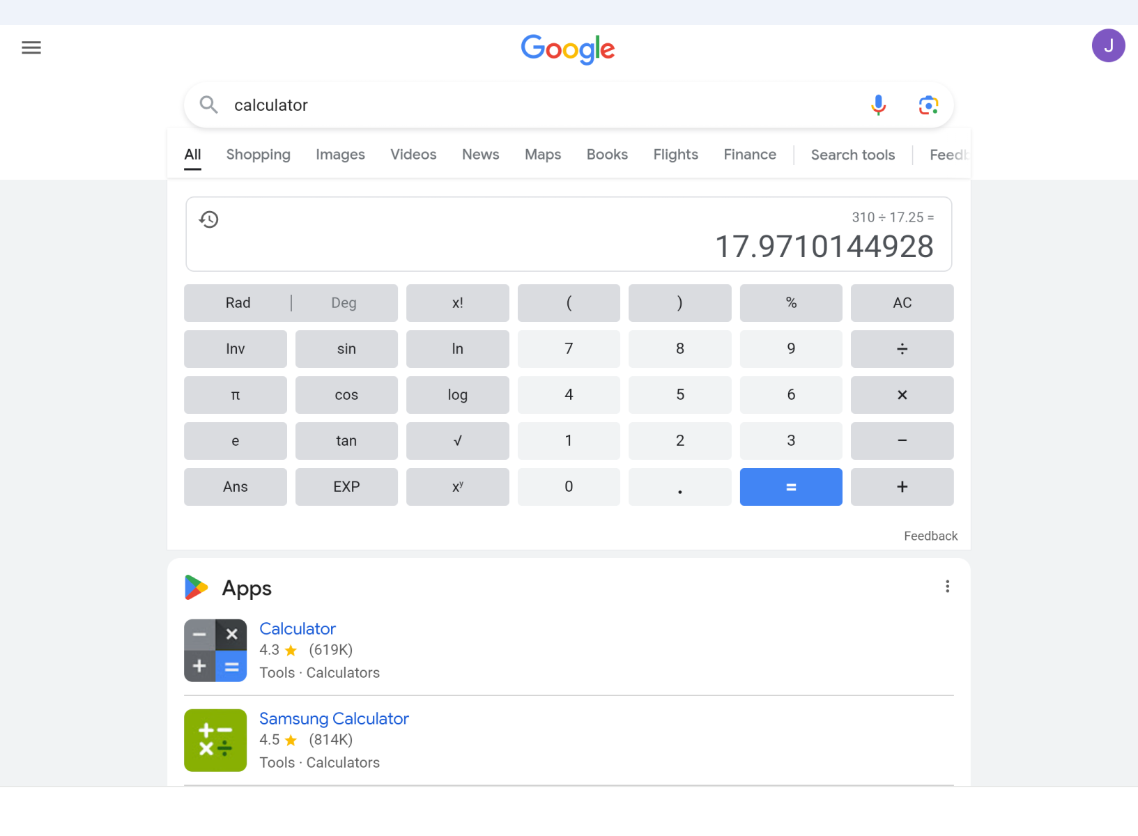

Hey....ya know...... I can make my calculator show "Shell Oil"
gotta turn it upside down.....
