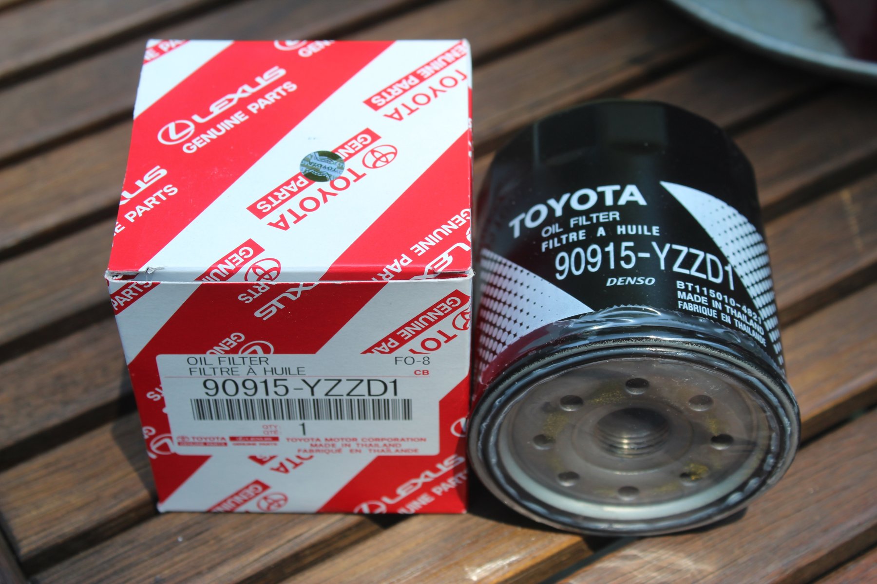

Castrol, and several others are all more than good enough oils. Just use good filters, and do the manufactures oil change intervals, and you'll be fine. Heck even wally world super tech oil is fine.
I use toyota filter's in my tractor. Actually mobil, and k&n filters are very good, if not better. They are all I used in my tundra.

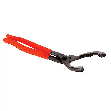

You gotta get yourself a filter wrench. Those metal ones that slip around filter with a handle work best.
Make sure you use a little oil on the new filters rubber o ring before installing.
i have a filter wrench, but not the right one for this application apparently
it was for the old '79 corolla i had decades ago that had A BIG FATTY filter on the side of that RWD
maybe need a cup wrench?
What Lisle seal puller? Lisle the name of the company...they make/sell all sorts of tools. I use a Lisle oil wrap around oil filter wrench when removing those can filters.
