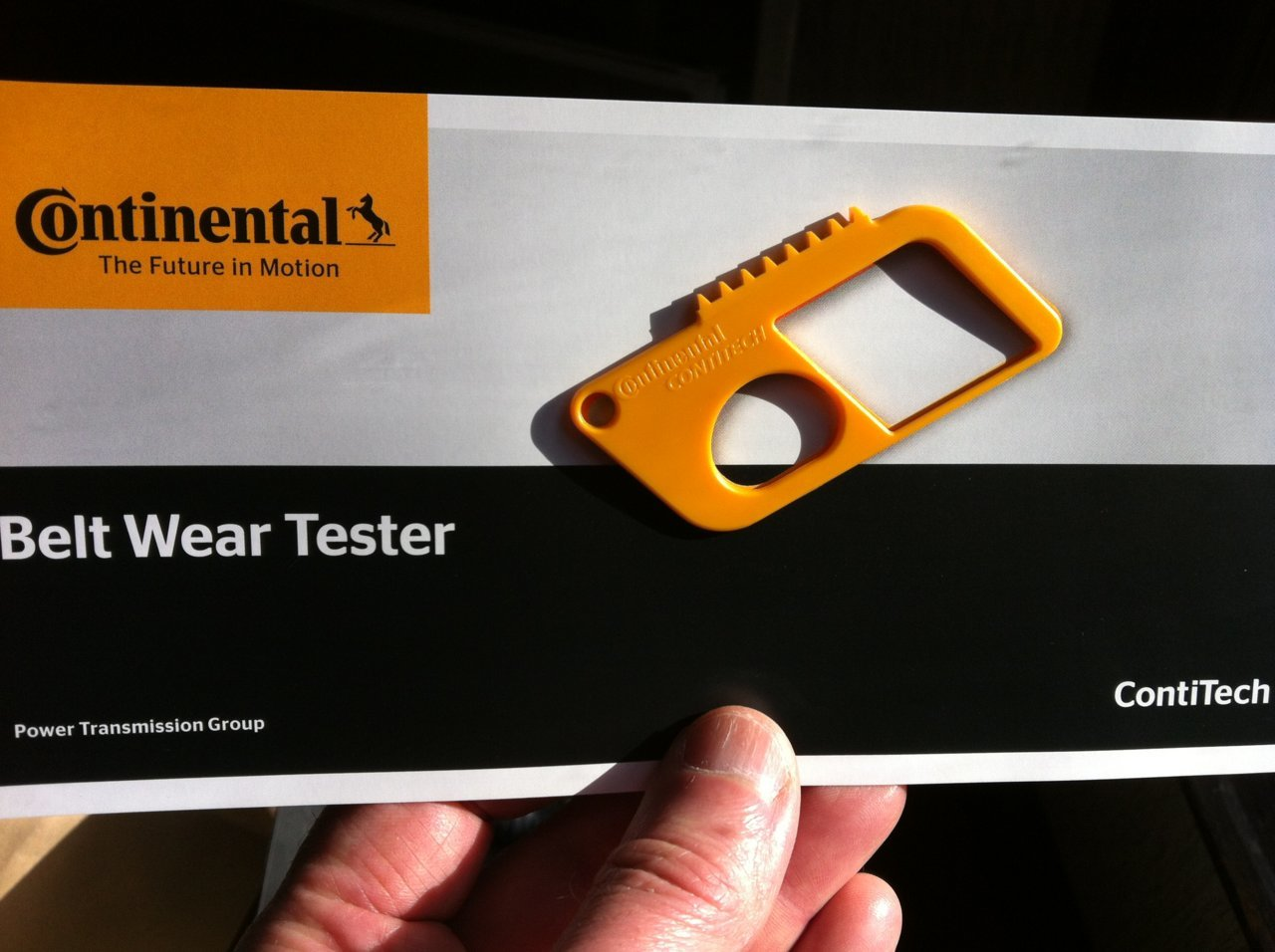

All.....you really don't need a tool (gage) to see if the belt is worn.
Look at the pulleys. If the crest (point) of the grooves is shiny, then the belt is worn. This comes from the belt sitting deeper in the grooves with the pulley crests being driven by the valley of the belt.
The belt is designed to drive on the sides of the V.
Other clues to belt replacement are shiny (glazing) belt (drive side or back side), cracks (anywhere) and slipping (of course). Generally, these indicators are evident before slipping begins.
One more tip. While the belt is off, take a couple minutes to inspect and clean the pulley grooves.

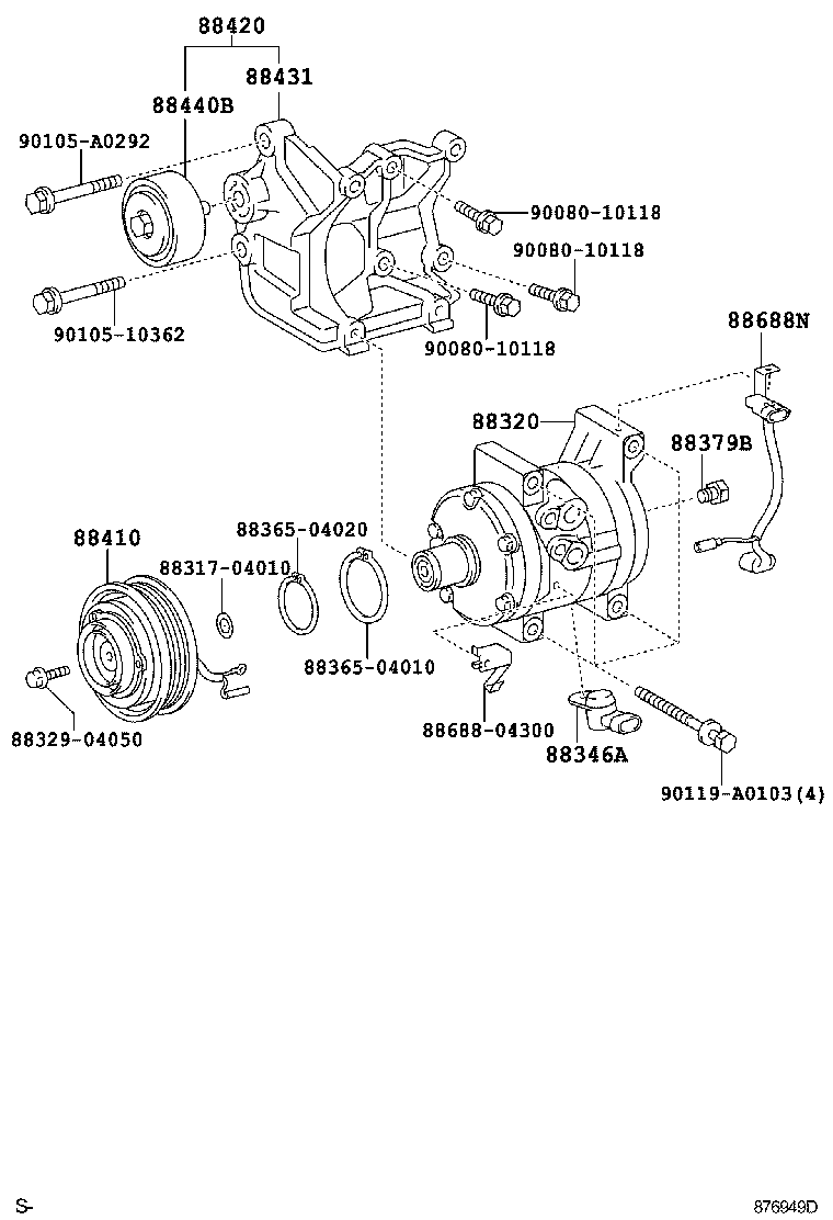

... peeking around behind the HUGE fan shroud i spot Another Pulley, the AC idler pulley buried down on the driver side
do these pulley things develop the squeaky at 13yrs and 85k miles?
MSRP is 75$ on that pulley
this is for the v6
seems that stuffs are removed to access this easily?
Yes, on the Gem2 V-6 (4.0L) to remove/replace the tensioner, the AC needs to be unbolted at least. Its a difficult task. Access is limited and the bolts are very tight.
I tried to replace the tensioner on my truck. I was not successful removing the AC bolts. So, I do a regular inspection at each oil change. Basically, I untension the belt and rotate the tension pulley by hand noting any grinding or unusual movement.
