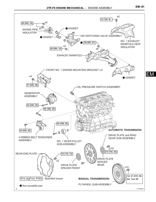

How challenging is this task to do
What all needs removed for access
It must take good time if dealer has 1.5 hours or so for this task

2 day job here at least
Gotta remove belly pan to get at it underneath
Remove fan and shroud to reach in there
This is 4cylnder
Not quite roomy as the six cylinder is
Actually the 4 cylinder is is easier than a 6. Never had to remove a fan shroud either. Must be ones first big job. At least its a very simple one.
