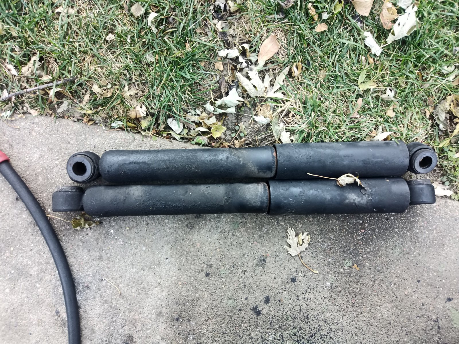

time for an upgrade from the Yota rear shocks...

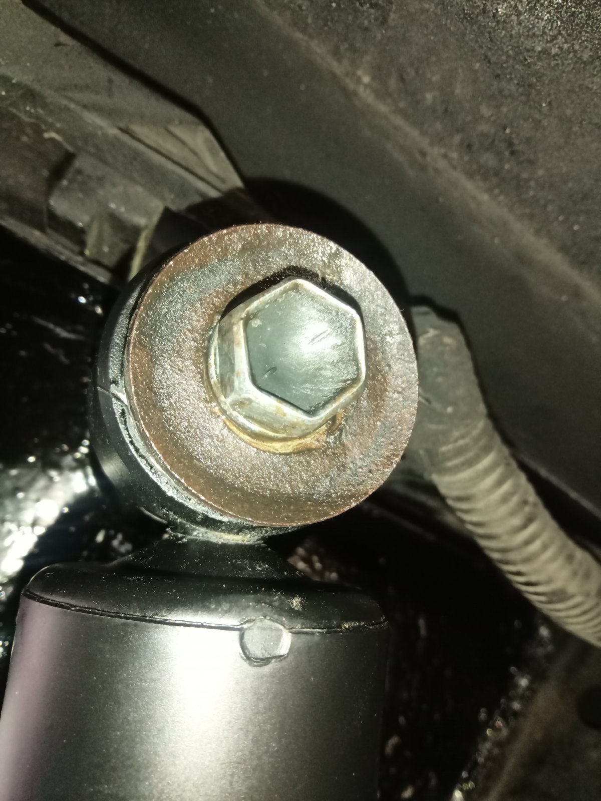

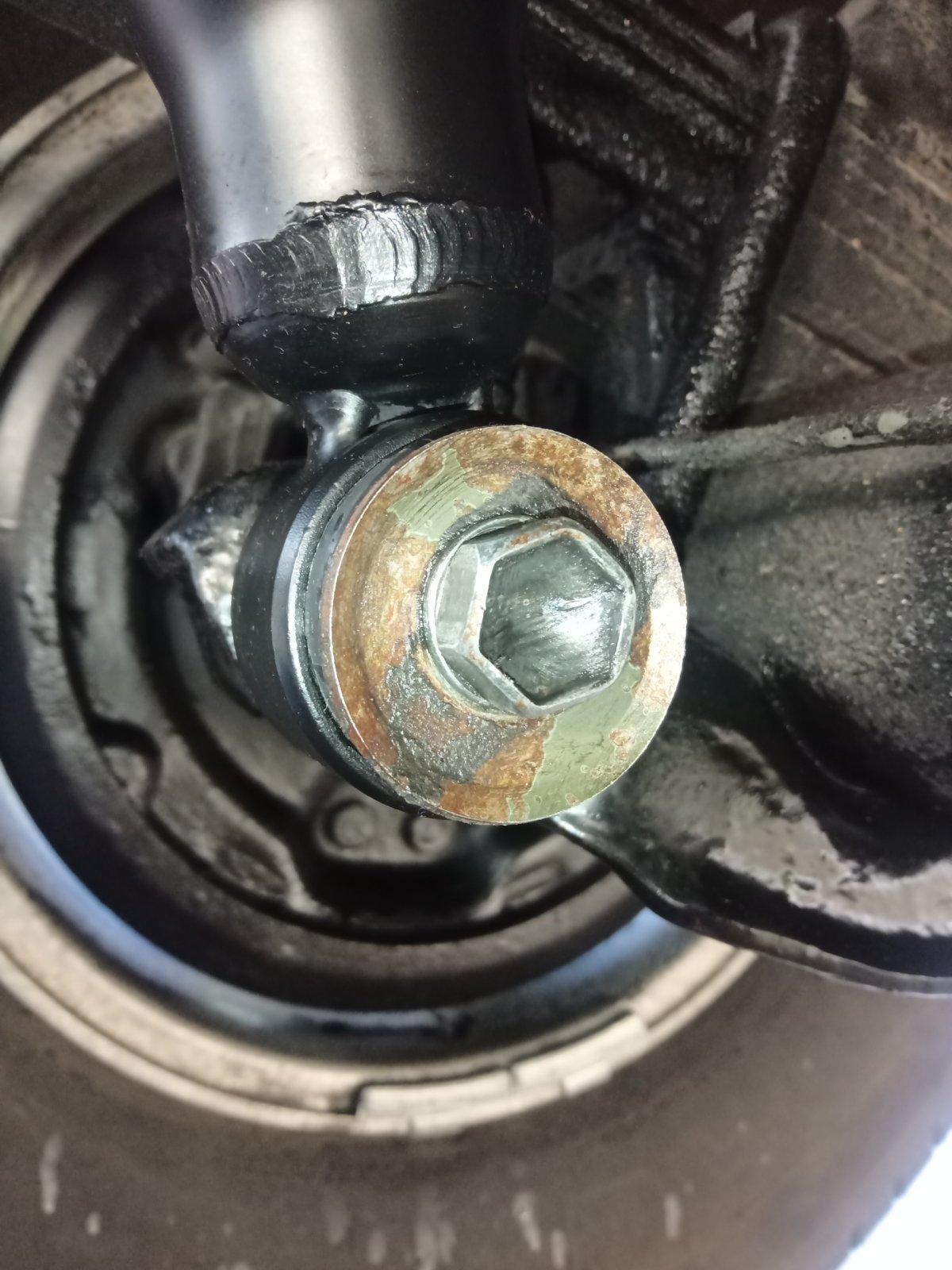

Would ace is the place sell these type of curved washers with the two different sized holes? And 1st time perfect kosher fit
I could try curbside delivery if they have in stock order ahead deal
We have ace , lowes, fastenal, home cheapo, and tractor supply here. If you can't find what you need, you likely don't need it.
So if I go to any of their web stores with the Toyota part#s I won't run into a hassle getting exactly what I need at possibly a much better price?

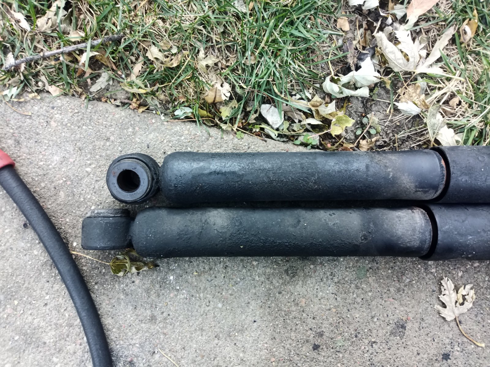

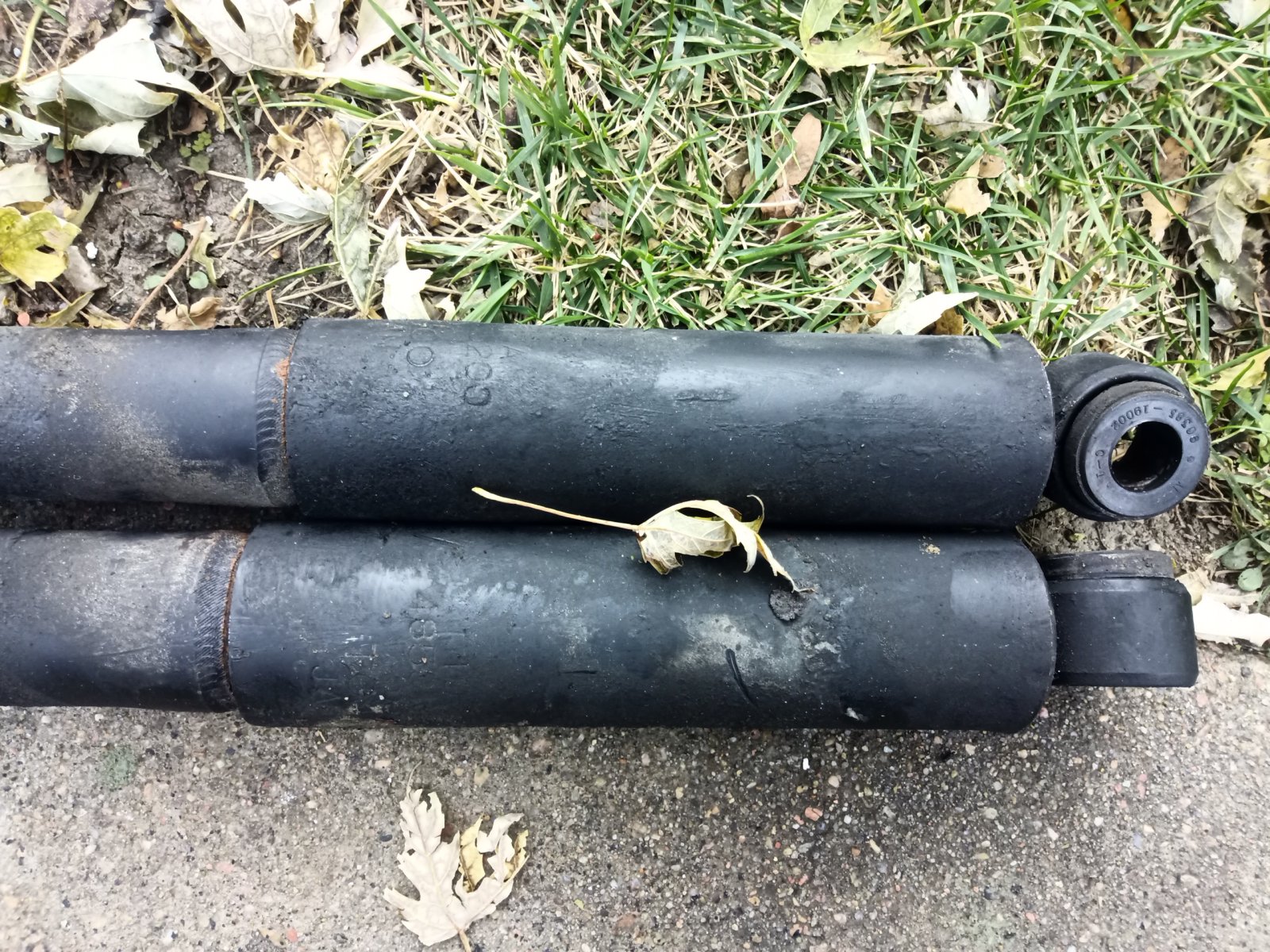

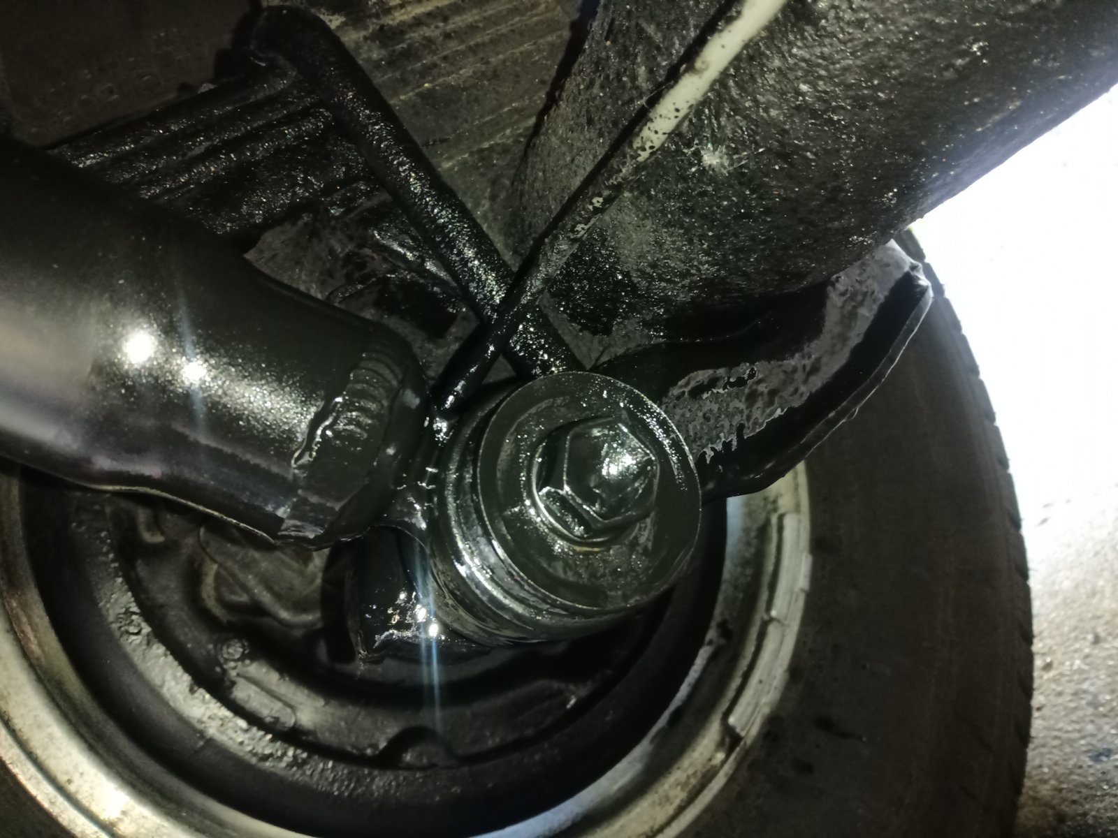

so i am really hoping that there are NO issues installing this passenger rear shock and the aftermath thereof
Toyota OEM shocks are two different sizes, 2 different part #s
the same goes for Bilstein rear shocks, 2 different part #s
KYB, on the other hand, are both the same part# for my rig
AAP double checked when i ordered them
so i hope they and KYB are not sticking their finger where that sun does not shine o_O
They most likely will not have a cross-reference to part numbers of any manufacturer. Best bet is to the physical store with washers in hand. Play bin match to the washer in your hand.
BTW, nice job. I bet it feels good to have it finished and riding smooth. ;)
FWIW. Washers are pretty simple items. Only 5 things needed to define a washer; Outside diameter, Inside diameter, Thickness, Material, Grade. Match these features and the washer will satisfy the need.

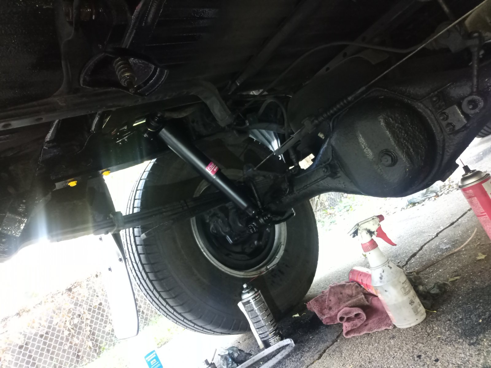

Have you ever air-hosed the dirt out of your right rear shock cavity?
There was an insane amount of dirt buildup in mine today after a year even though I picked and blew out 24 years of hardened sediment and cleaned out that cavity just a year ago

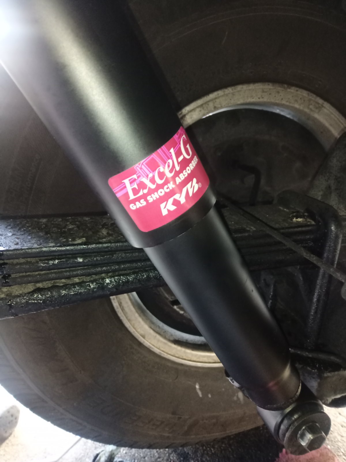

Got the other side done and torqued to spec
Anxious to give it a roll tomorrow on the broken roads
Not an easy task with the bad arm up over the muffler and the 1/2 inch extension just barely clearing that exhaust hangar :eek:
