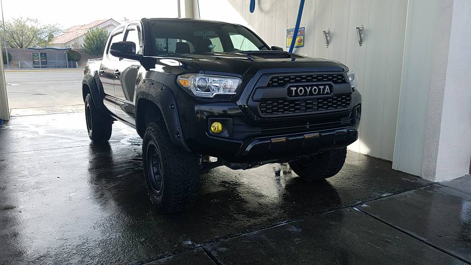

Yes it will be fine. Let’s see some pictures.

How your tires are staying on your rims is a miracle.I'm currently running 265/70/17 on 17x12.5 pro comp vertigo's, and a pro comp 2.25" lift in the front.
