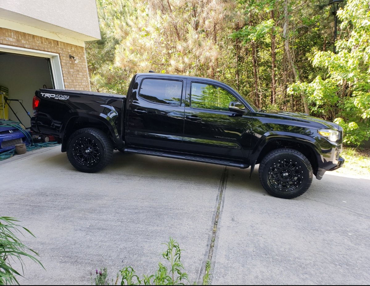

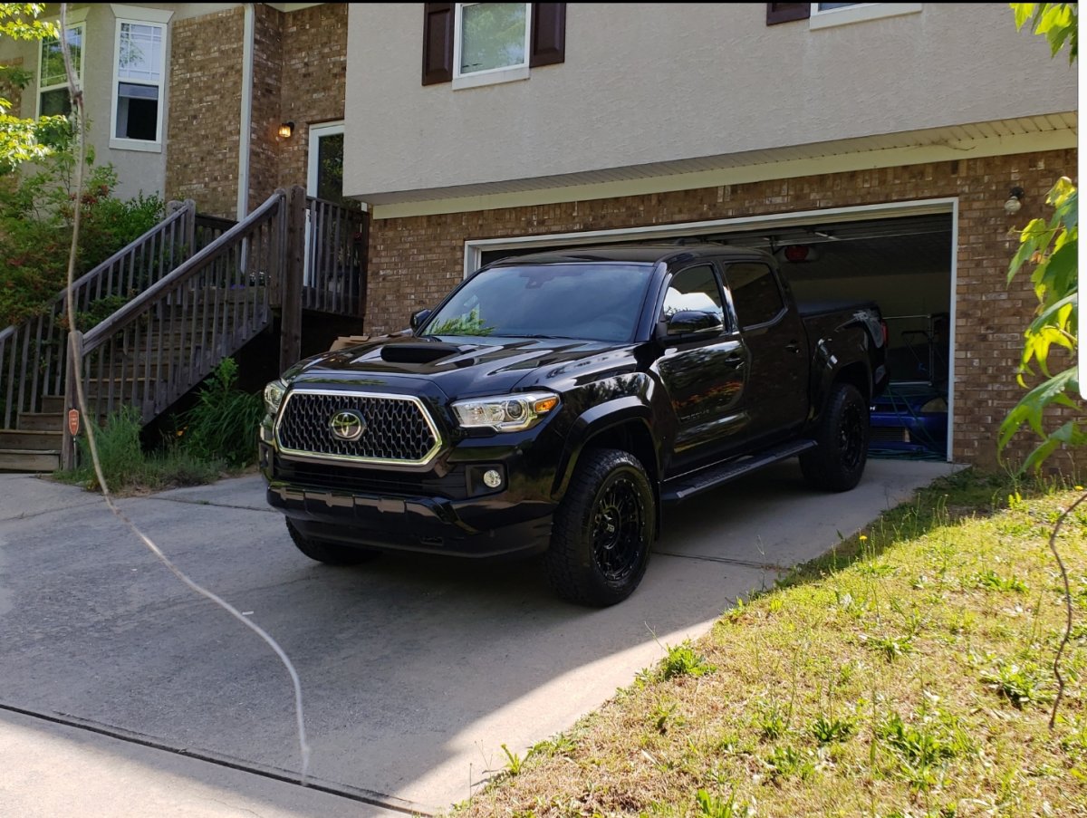

Looks cleanJust installed 18" wheels on 265/60r18's

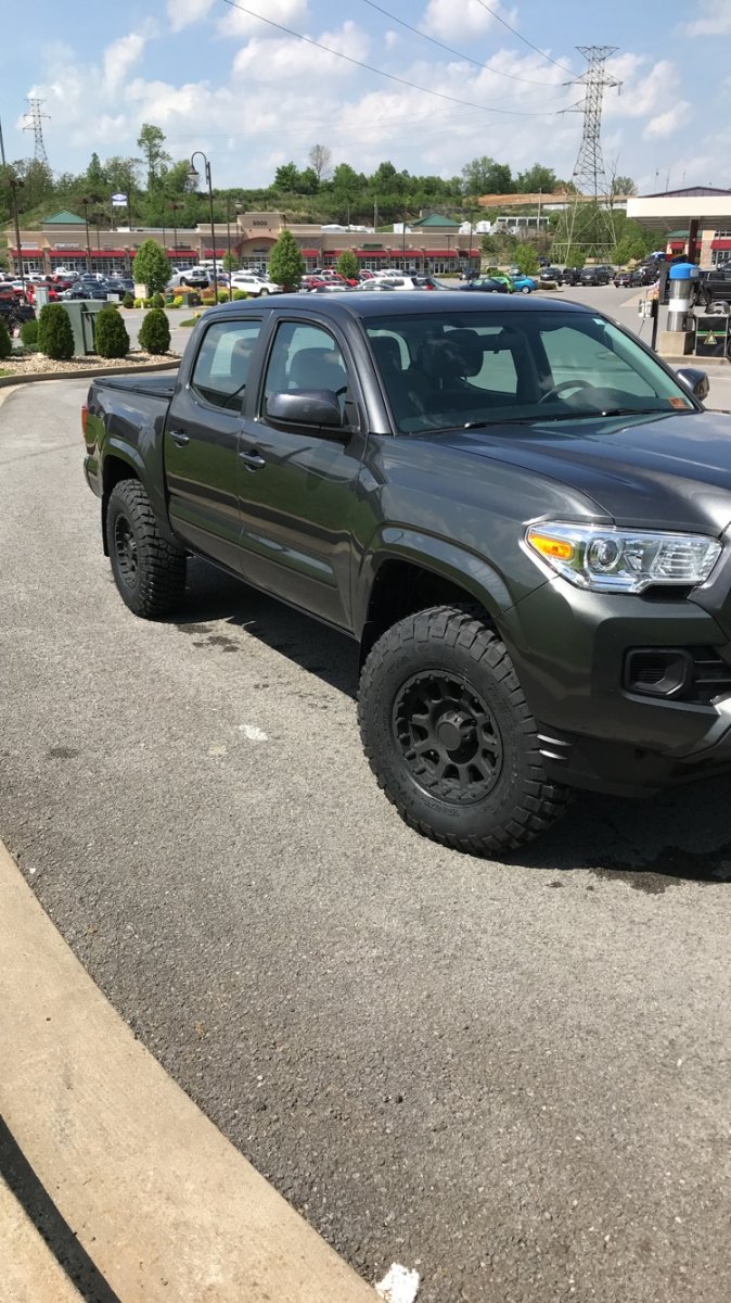

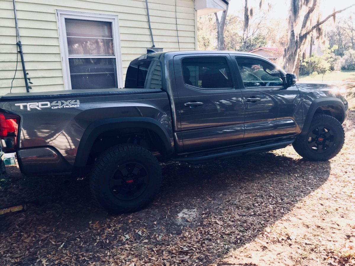

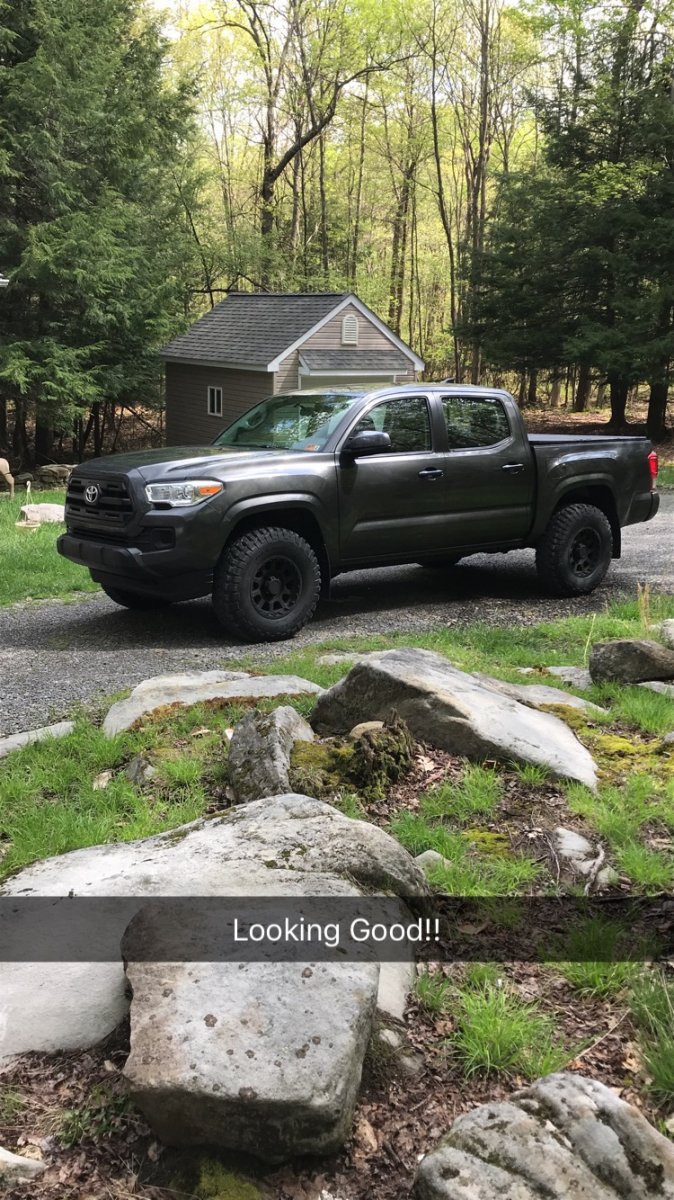

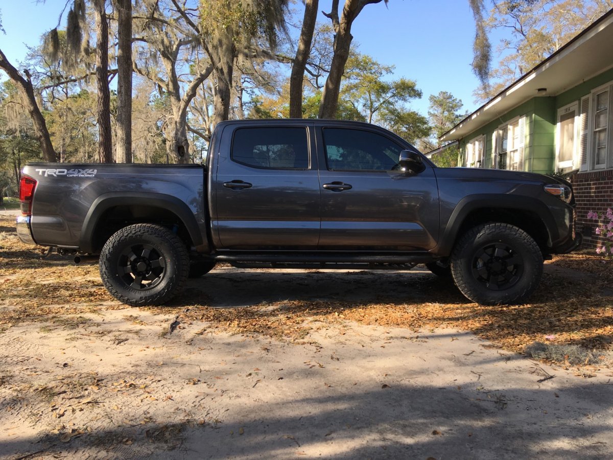

265/75/16 is the biggest you can go with no lift/trimming/rubbing according to Discount Tire.
I have Pro Comp 7032 16x8 4.5 backspace/0 offset with BFG T/A KO2 265/75/16. They stick out about 1-1 1/2" more than stock and don't rub at all
