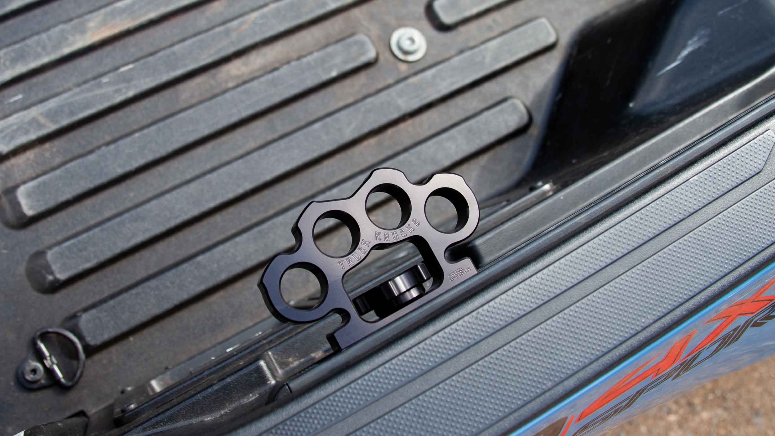

Installed a couple of the Dodge Sprinter D-rings P/N 5170492AA on the bed cubby bolts:

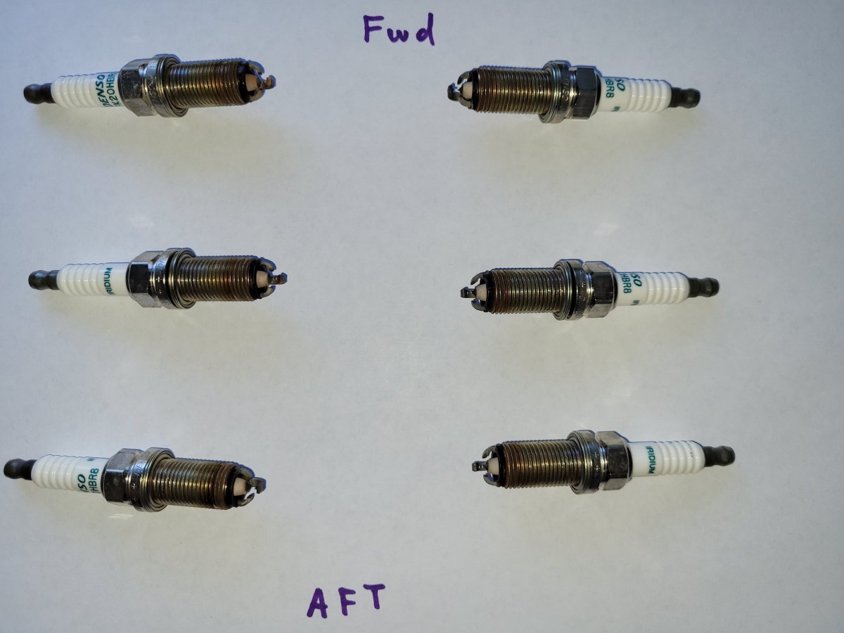

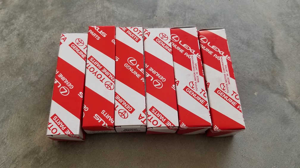

I did the "dreaded" sparkplug change. My '16 had the original factory plugs that I let go 103,000 miles. I finally changed them this weekend. The passenger side was much easier than the driver side.

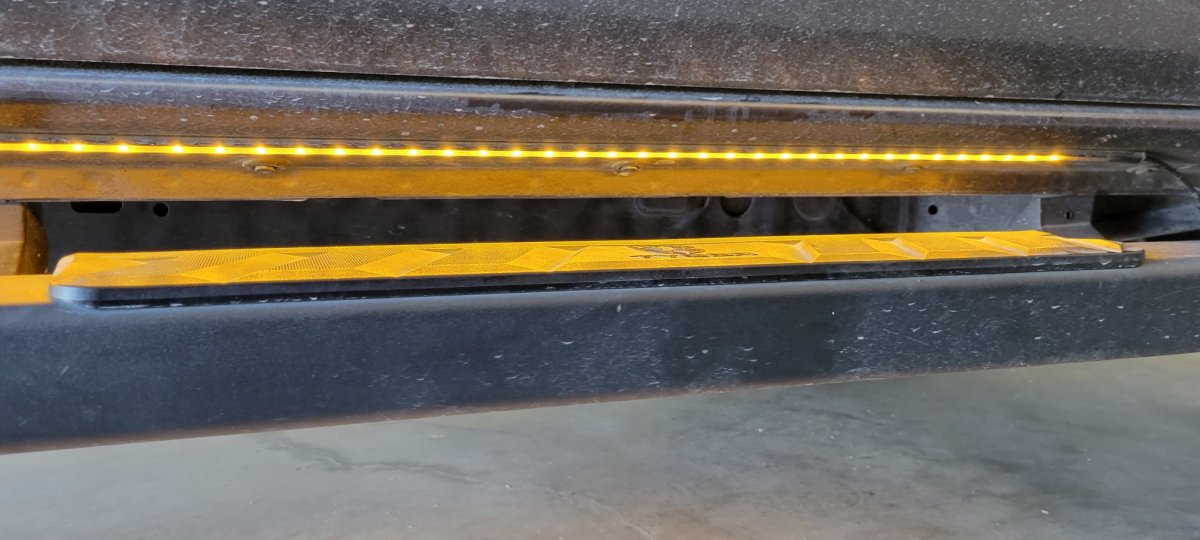

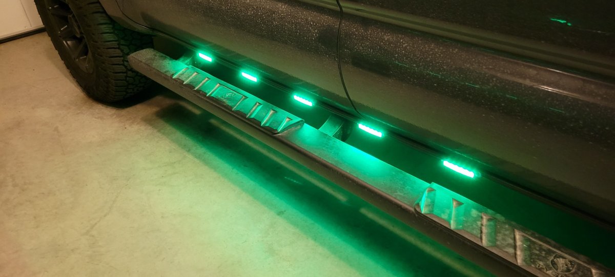

20220327_171045_copy_2016x908.jpg 20220410_161445_copy_2016x908.jpg Swapped out the flickering amber strip lights (puddle lights) and made lights bars for each side and mounted green LEDs.
