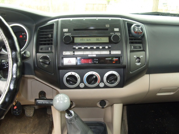

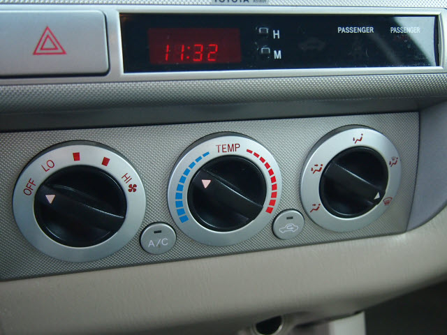

Ripped out my stereo, A/C vents, HVAC unit, painted all flat black with a Matte Clear Coat to finish. I really don't like chrome. Had to disassemble the stereo just to get the faceplate off :whistling2:
I'll post pics when I reassemble & reinstall.

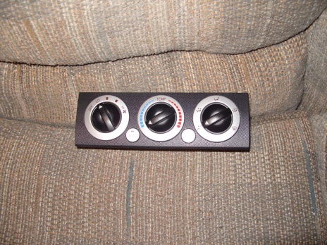

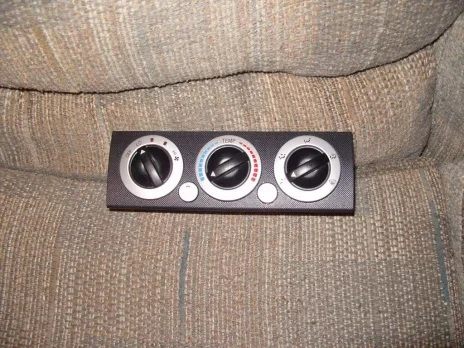

HVAC done...before & after

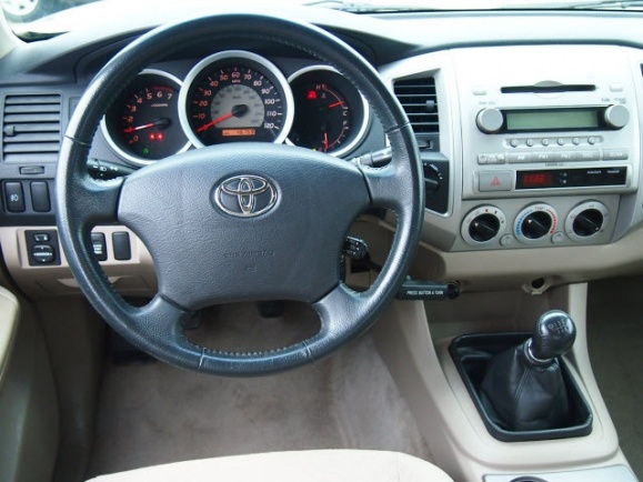

Done :thumbsup:
Before & after pics!

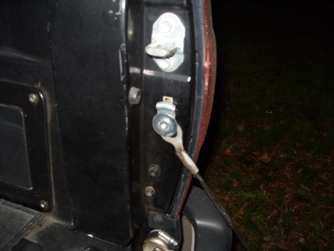

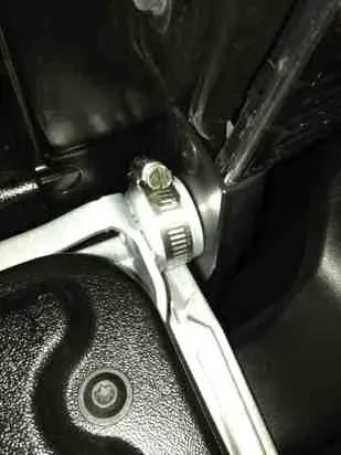

Did the hoseclamp tailgate anti theft thing. Whoever thought of that is a genius, even scooped the hoseclamp from work for the bubble. Will do the trick til i get the pop n lock that fits the b/u cam.ImageUploadedByTaco Forum1367978260.500881.jpg
You might want to add the washers to the cables for added security. Takes a T40 Tork bit which I keep in the cab so if I need to take the tailgate off for some dumb reason I can.
I went to Ace hardware and got one I think it's 1/2~3/4". I just took the bolt in and used it to get one that would fit and was big. Used blue Loctite on bolt since you can't tighten them down all the way or the cable will bind. And greased it enough so cable will move.
I also used a Key Hose clamp 3/4"~1 3/4" keep the key in the cab as well. got that at Advanced auto for like $3 for 2 clamps and 6 keys, uses the same key so I don't have to worry about losing one. I then used heat shrink tubing on the clamp so not to scratch the paint.
