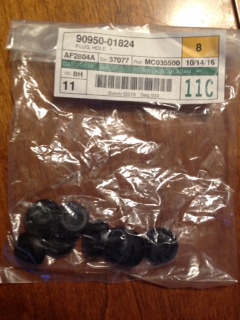

Yes and i have a fix for you. Its the a arms in the front end. They have holes in them which act like a harmonica at certain speeds. Buy this rubber plug kit and it should solve your problem.Enter this on Amazon 90950-01824

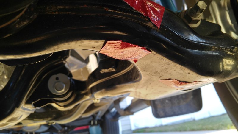

fixed the howling on my 2016 Tacoma Sport by putting duck tape on the holes on the lower control arm
Does anyone have a photo of what holes to plug. On my 2017 there are holes without plugs but they are very small.
