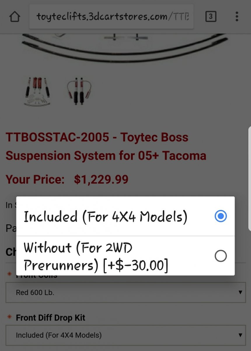

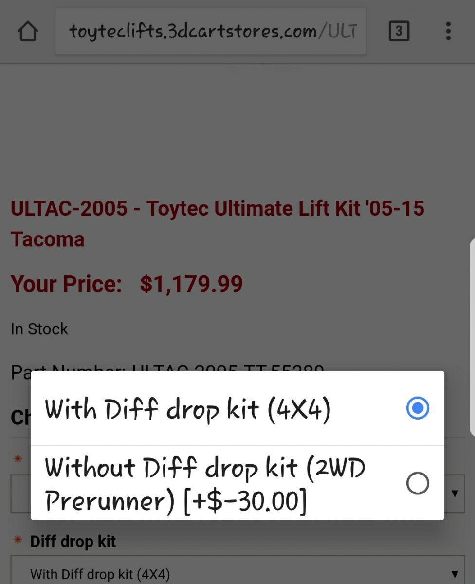

    TacoKen Well-Known Member
    I am using the diff drop that came with the Toytec Boss kit. Why would you NOT use it as part of the complete kit?

  7. TacoKen
    The Toytec diff drop is specifically made for the kit. Why would a manufacturer add it if not needed or more importantly do damage? That makes no sense to me.

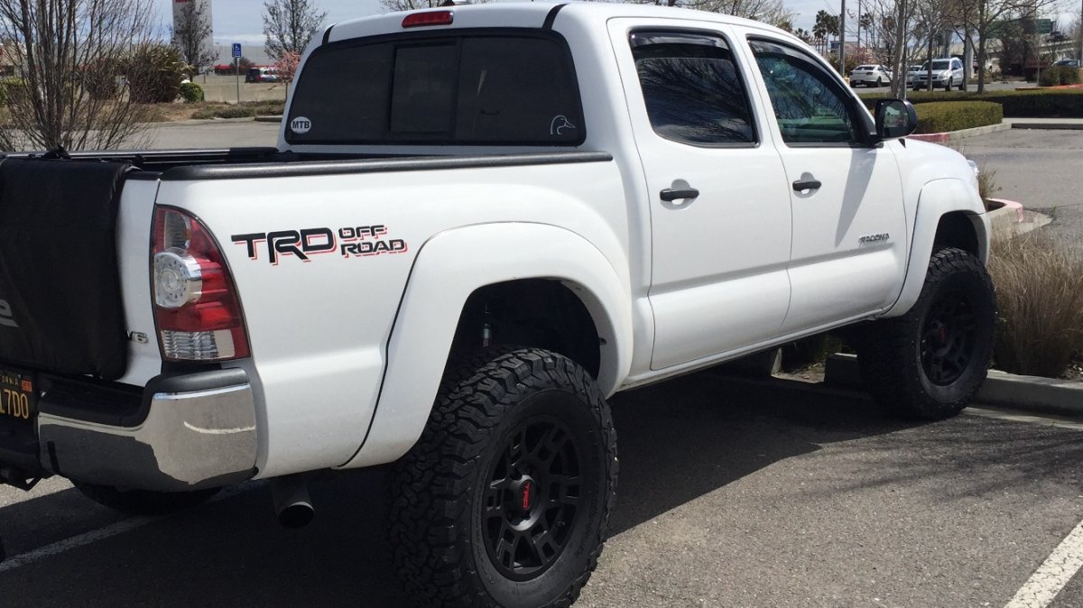

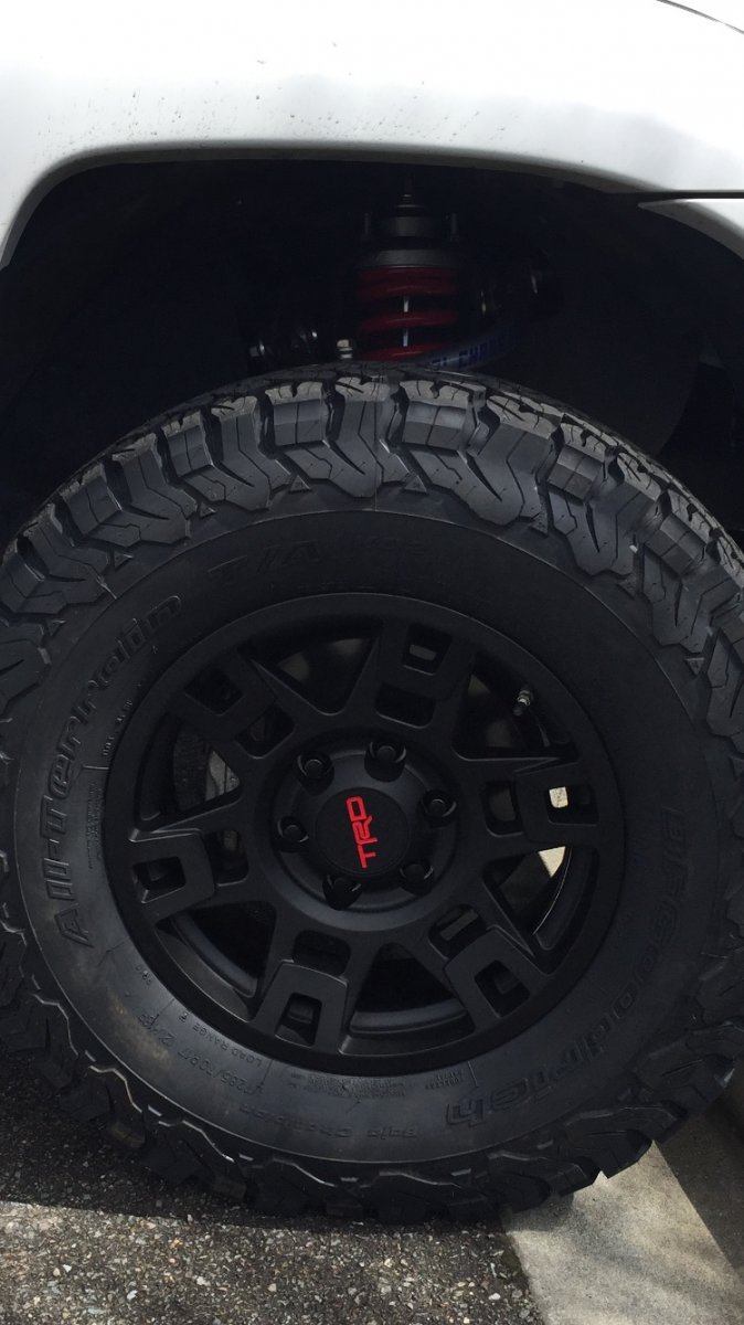

  11. OP
    rellinwood
    rellinwood Active Member
    Thanks for the help and advice. I’m in love!!!! IMG_9854.jpg IMG_9853.jpg IMG_9857.jpg

  17. TacoKen
    So, they just include them in their kit because why?
  18. Bojangles
    Bojangles Well-Known Member
    Like i said earlier, money.
    Its an option
    OR17TRD likes this.
  19. TacoKen
  20. Bojangles
  21. TacoKen
    Yes, unless you delete it, it comes with the kit.
