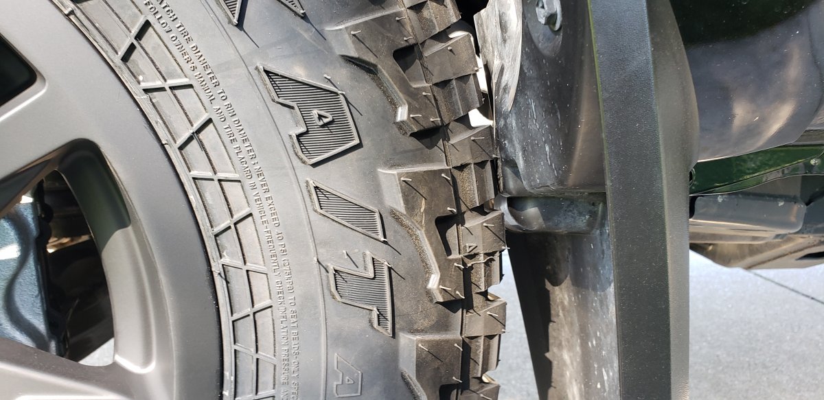

I have 265/70r17 with 4m offset on stock suspension. I rub on mud flaps at almost full lock. I imagine you would rub at full lock. Minor plastic trimming or heat gun to reshape mud flaps/fender liner. 20201005_143640.jpg
