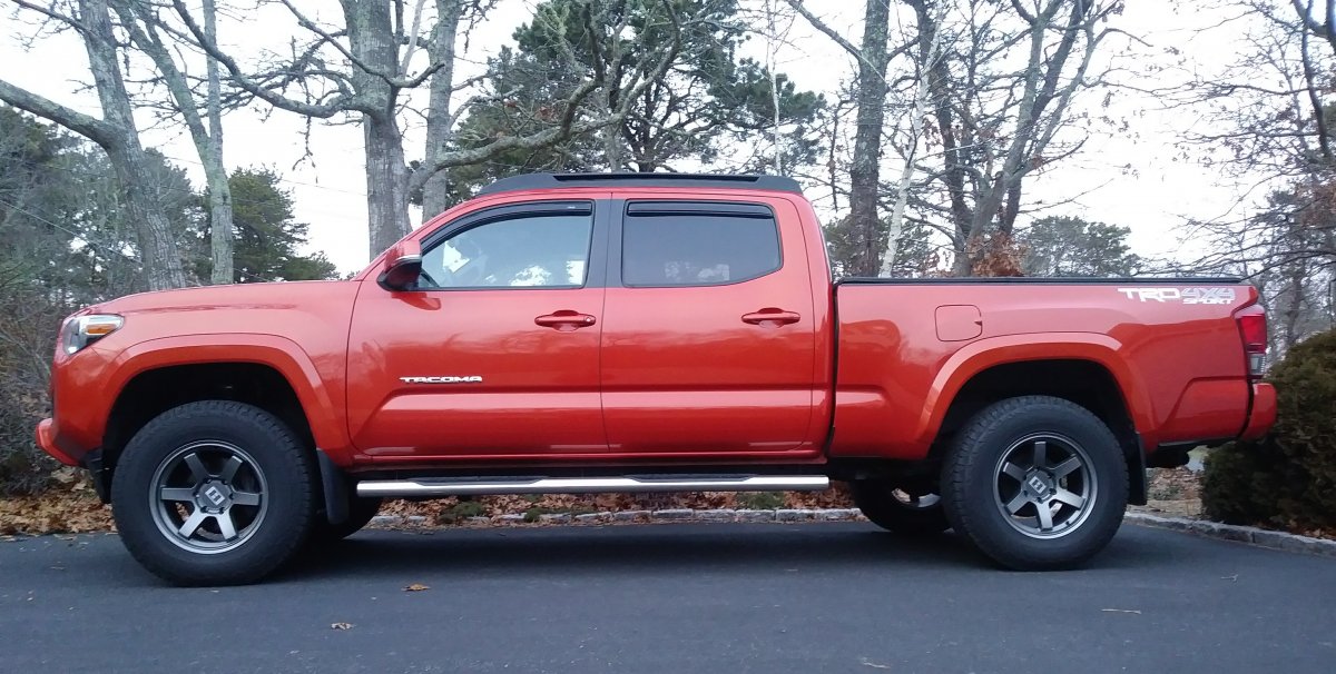

The best clearance I had with 265/70/17 on stock suspension was with 17 x 8 with plus 10 offset. Near perfect but I think 8.5 with plus 15 would be spot on perfect. Now I have 5100's at 0.65 to level with 17 x 7.5 4runner trails at plus 25 and big 265/70/17. Clearance is fine but would like a little more width and a little wider stance.
HI Guys, i have 2020 Tacoma TRD Sport. they are 17" stock, and i would like to keep it that way, maybe a Leveling kit. but i want a bigger tire with no rub. any suggestions ?
also, whats a good leveling kit ?

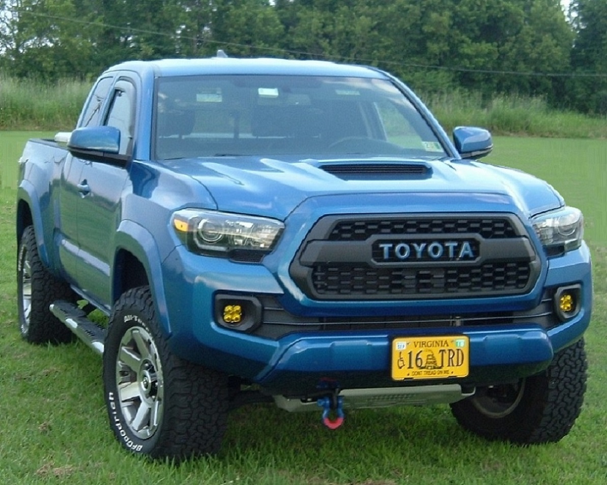

I went with Bilstein adjustable front shocks. I have 265/70/17 BFG tires so only set shocks to 1st adjustment and have plenty of room. Can go up another inch if needed with the shocks. Rides much better than stock Sport shocks. I put them on front and rear. The rear shocks are only good enough to add a 1" block. Rear shocks are not adjustable.james river 5.JPG
I went with Bilstein adjustable front shocks. I have 265/70/17 BFG tires so only set shocks to 1st adjustment and have plenty of room. Can go up another inch if needed with the shocks. Rides much better than stock Sport shocks. I put them on front and rear. The rear shocks are only good enough to add a 1" block. Rear shocks are not adjustable.View attachment 28765
Are those the T4R trail team wheels?
Yes off 2014 4runner trail with 2017 caps. Liked these better than the 2017 but my 2014 caps were rough so swapped caps and sold the 2017 wheels. Got around $280 in the wheels. Wanted the 7.5" widths instead of 7" Pro type.

Did you notice any difference in trucks performance with out spoiler in front ? I like the skidplate !
