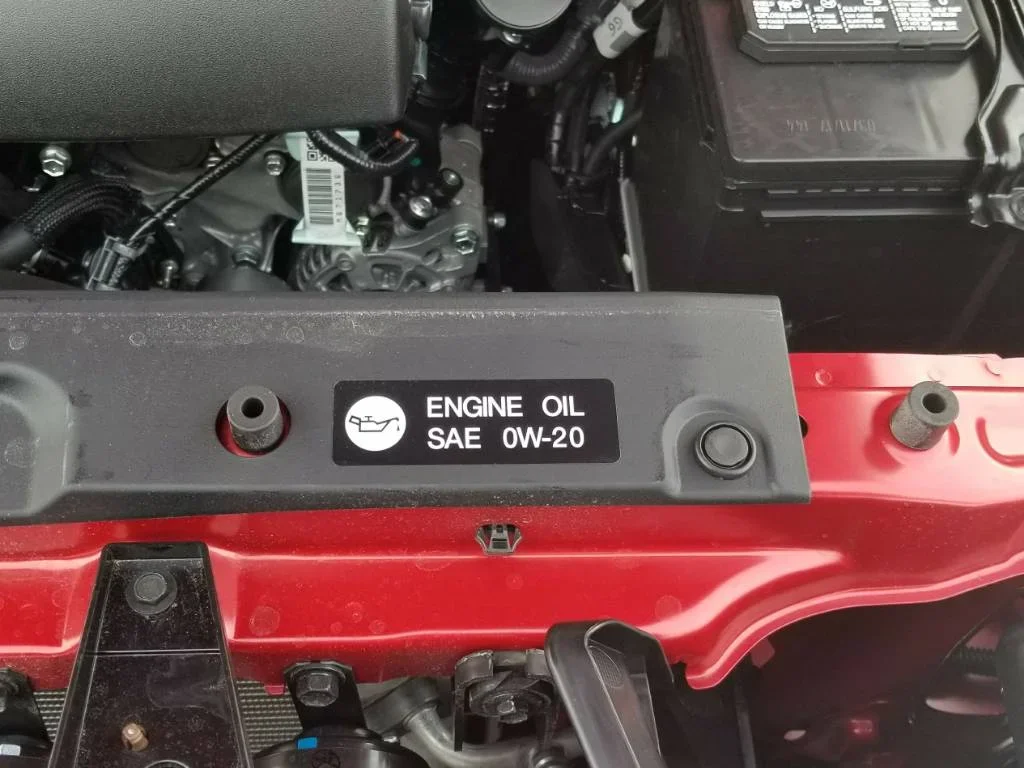

What you are stating.
The 2016 and 2017 Tacoma manufactures suggestion for OEM oil is 5w30 and the 2018 with the same engine is 0w20?
What’s up with that?
Beats me. That's what the 2018 says to feed it with. Didn't know 16 and 17 were different...
2008 calls for 5w30 and 0w30 - meets that spec at the most important area ,normal warmed up running conditions as 30 weight
at start up running zero weight has to lend to less motor wear & it is a 30 weight when needed
If 2018 calls for 0W20 ,it's the 20 weight aspect you have to wonder about If Toyota tightened up the tolerances then a 20 weight is needed
it's said the engineers do the test's - invest the money .& what they recommend is best .

IMO if it calls for 0w20 use it
hot weather 5w20 would logically be ok
If anyone lives in southern Missouri, I get synthetic 0w20 for free. Only 2-3 gallons of leftovers at a time when I haul it.
As best I can tell, the 4.0 specified 5W-30, the 3.5 specifies 0W-20. For what it is worth, the 5.7 in the Tundra specified 0W-20 from its intro in 2007.
