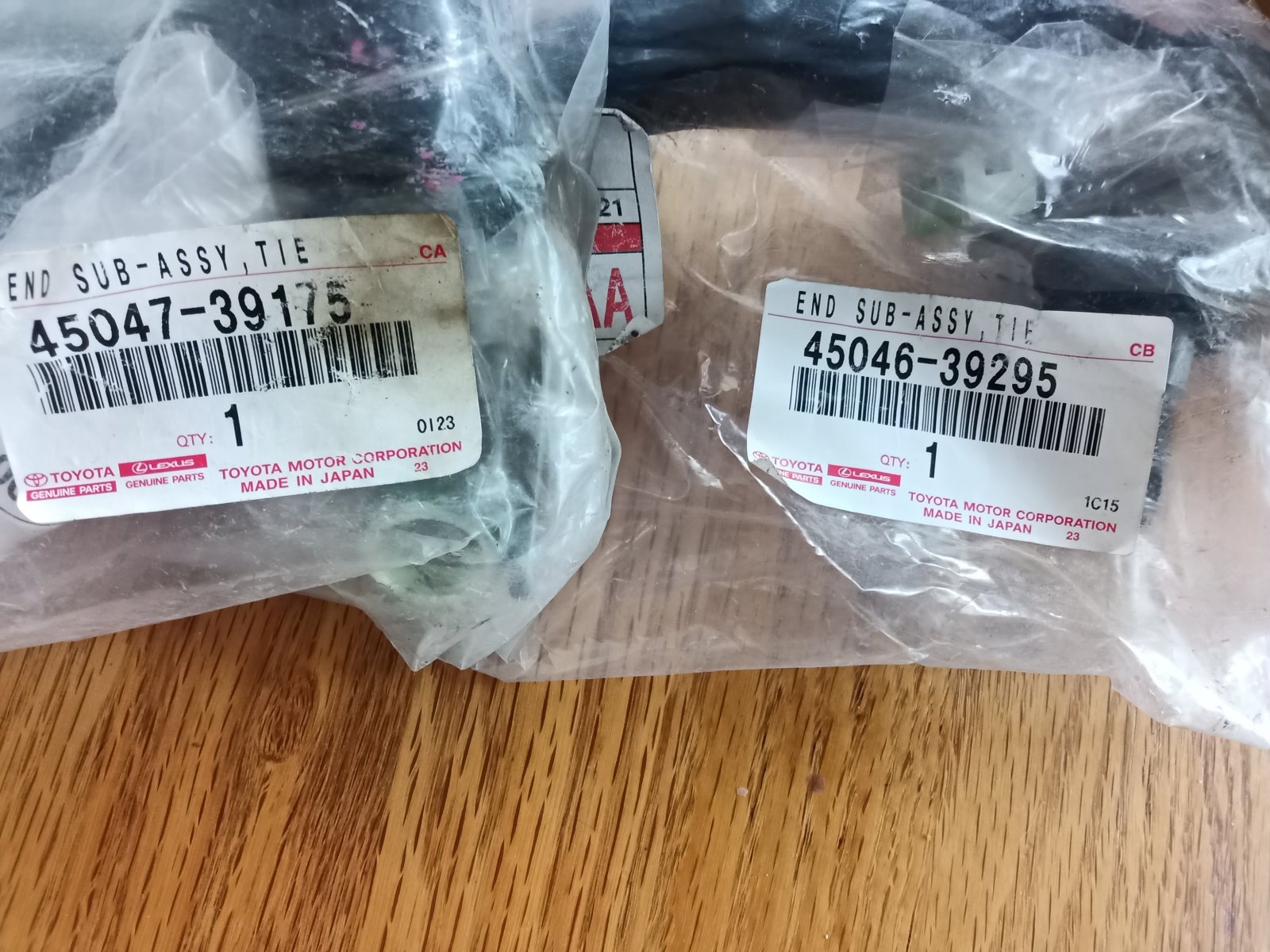

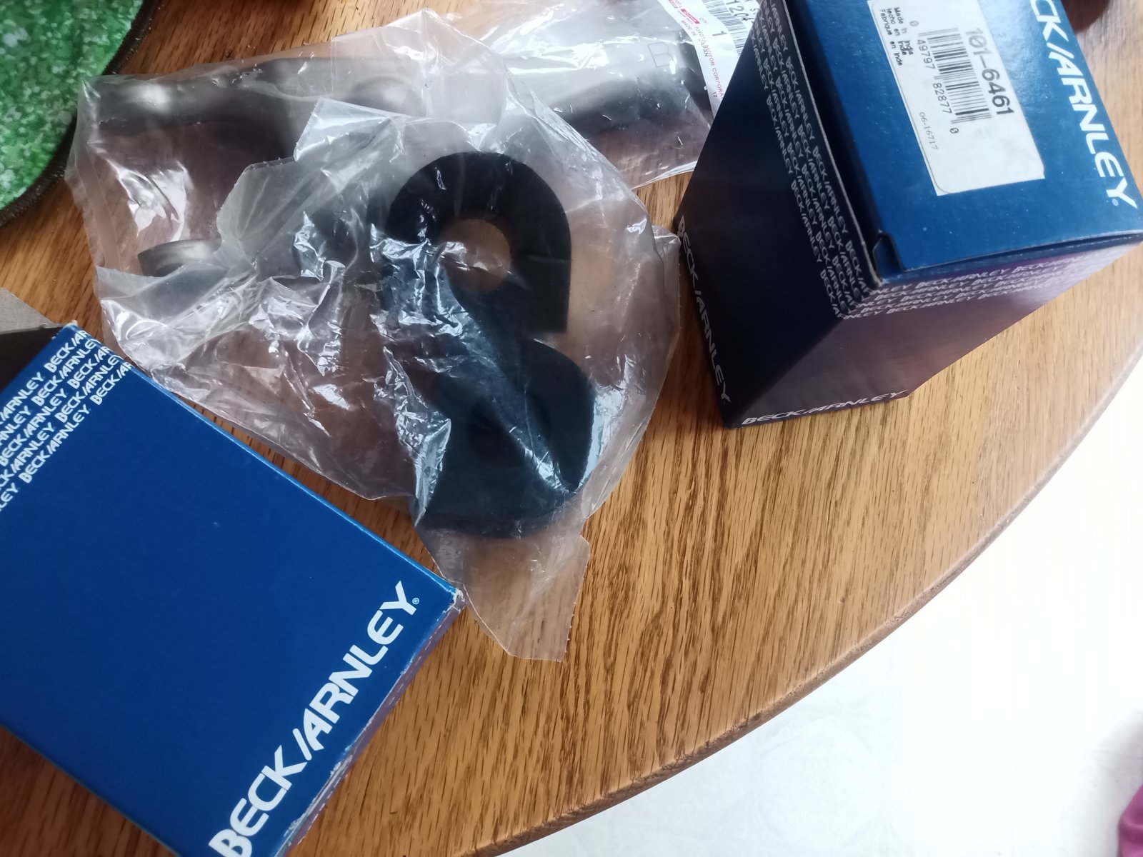

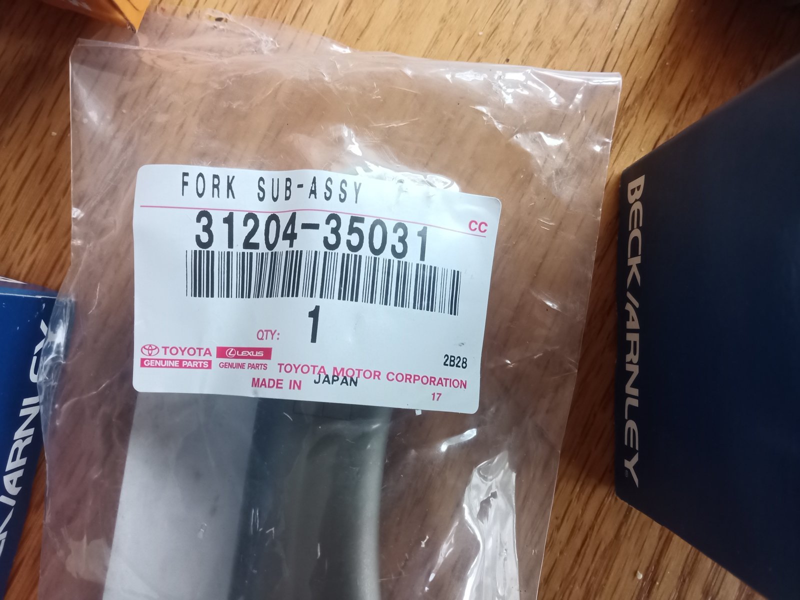

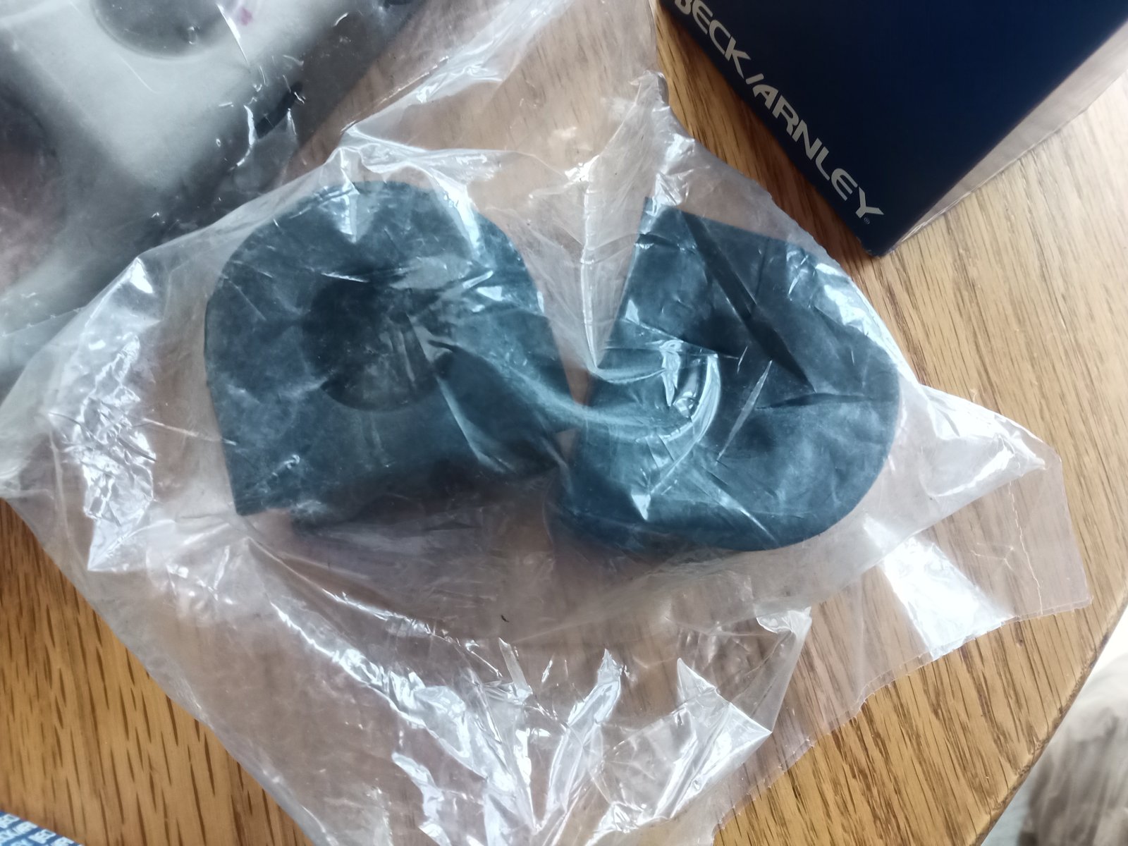

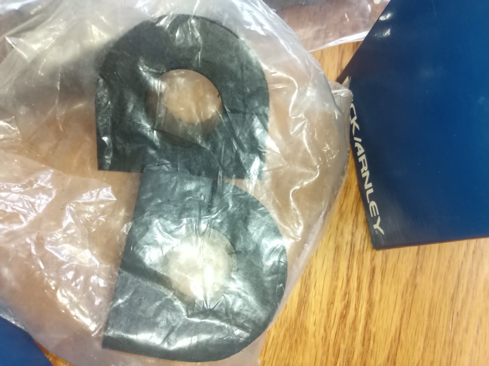

Genuine not available

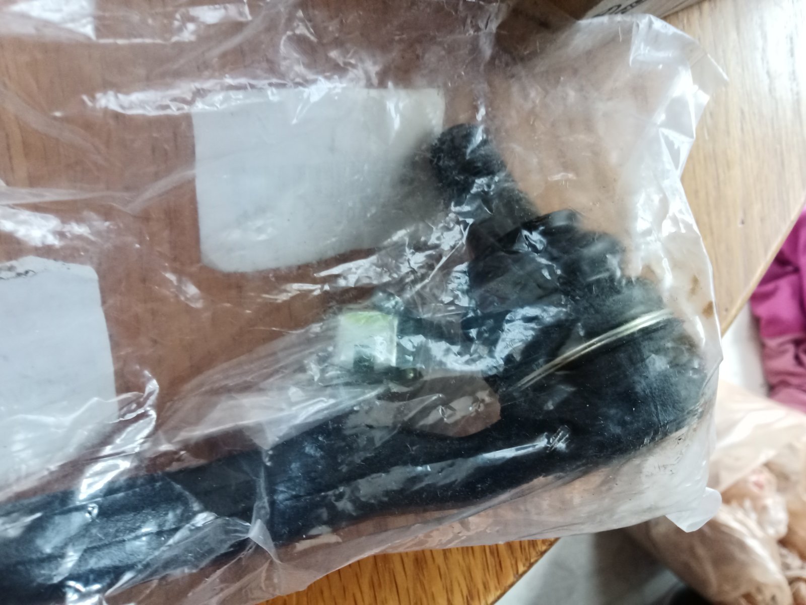

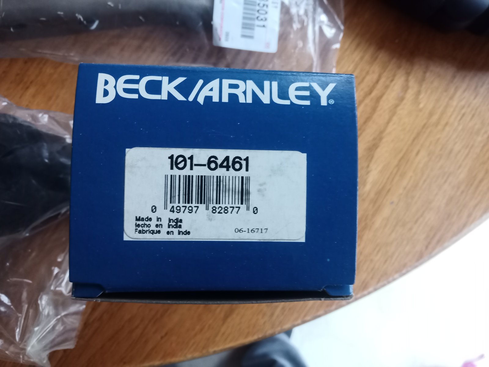

So these would have to do for the stabilizer
IMG_20231127_103636_564.jpgIMG_20231127_103659_392.jpgIMG_20231127_103716_091.jpgIMG_20231127_103740_360.jpg
i've had those tie ends for more than 2 years in packages ready to put on
it is now that time to get them put on :)
i also found i have 2 new wheel bearings that i did not know i had lmao
and 3 NEW grease caps for the front hubs o_O bot at a sale in Miami 2 years ago
i recently used one to replace a buggard one
WHY did i feel the need to buy 4 back then??
