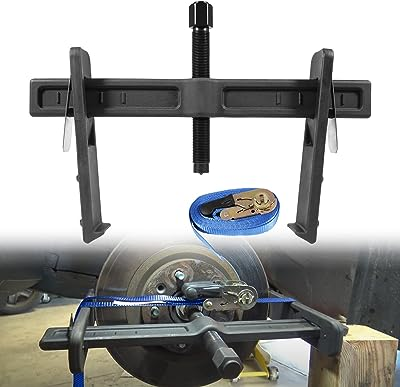

Thats great.....assuming you have one of those and a 1/2" Impact......
For those without and without jack screws......its BFH. The banging imparts a vibration allowing the rust penetrant to work into the mated surfaces. eventually, a small movement can be witnessed between the lug bolts and the mating holes. This is a good indicator things are working.
One of thee and a 1/2" cordless impact and it's no big deal to remove stuck rotors.
