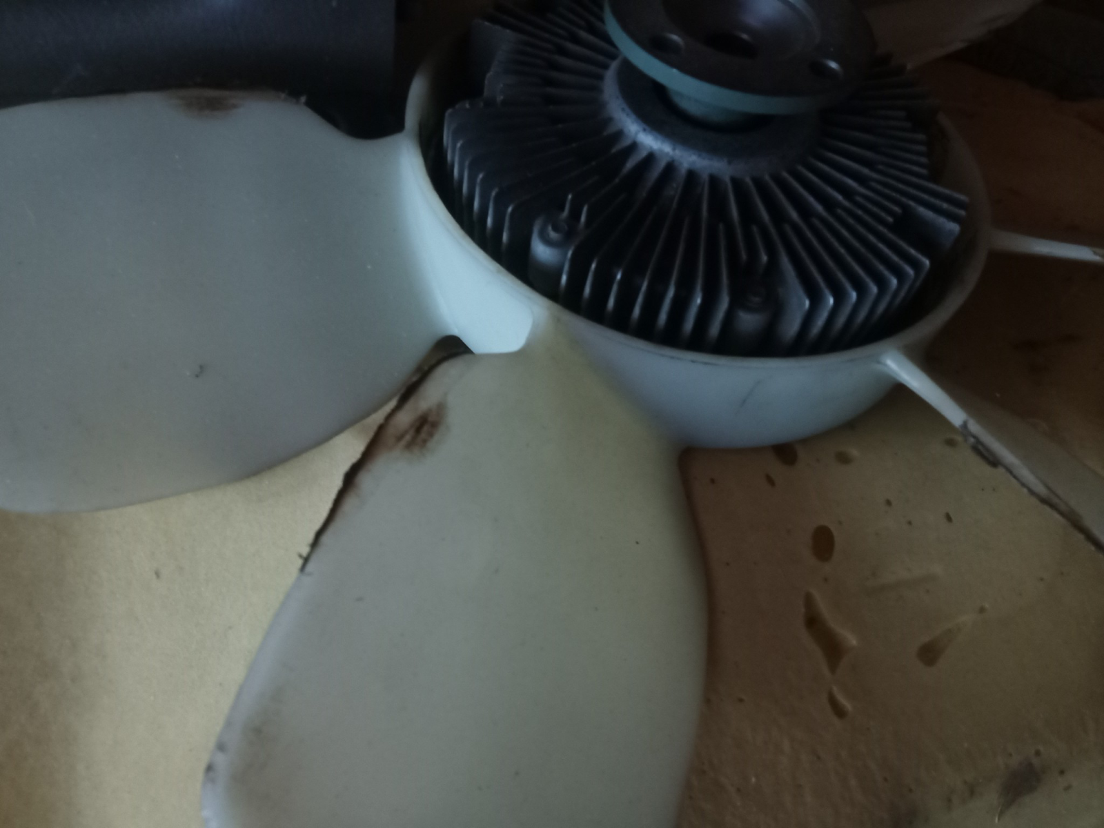

This is what that diagnosed clutch throw out bearing did to the fan blade
Glad I checked the oil after that hot run, saw this and grabbed the flashlight to take a good long gander to see what was doing this
from a service maintenance and check back in October '20 i recall having the professional carefully listening for this odd rattle
when the clutch pedal was depressed the noise dissipated and then would slightly come back when pedal was released
this led to diagnosis of the clutch throwout bearing making the chatter...

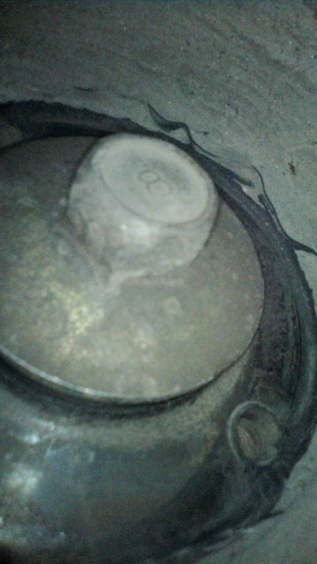

old pic of vulcanized failure from April 2o21...

clutch throwout bearing chatter can come all the way to the front of the engine, the master Yota diagnostic tech told i

This shouldn't cause damage to the crankshaft. Yes, it could possibly damage the drive pulley on the end of the crankshaft. Simple part that can be replaced with some effort. Same for the pulley on the AC compressor.
The rubber in the AC pulley is there to absorb or to ease the shock of the clutch engaging the compressor when the engine is at high rpm.
Yes, the rubber is vulcanized to the metal parts. No, do not use any sort of "rust preventative" on the rubber.

the OEM coating on this pricey part has deteriorated quite a bit over the past 25+ months
is it going to fail again!? :confused:
Everything fails.
Just a matter of time. Shoot even mountains fail to become boulders, then rocks, then stones, then gravel, then sand.............
