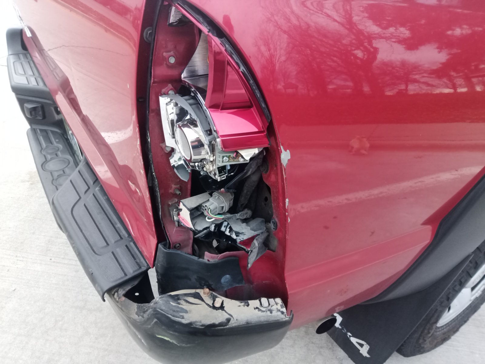

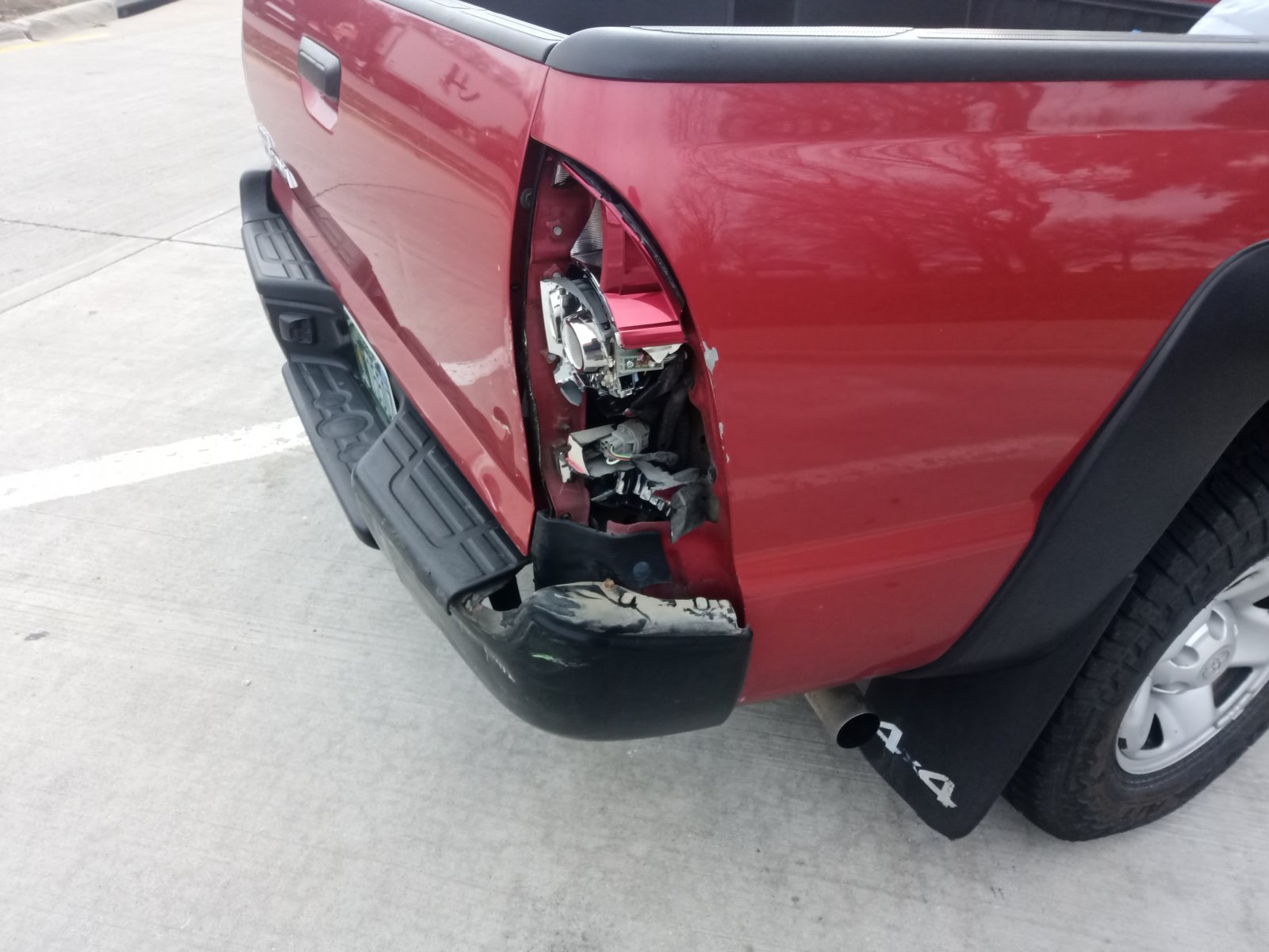

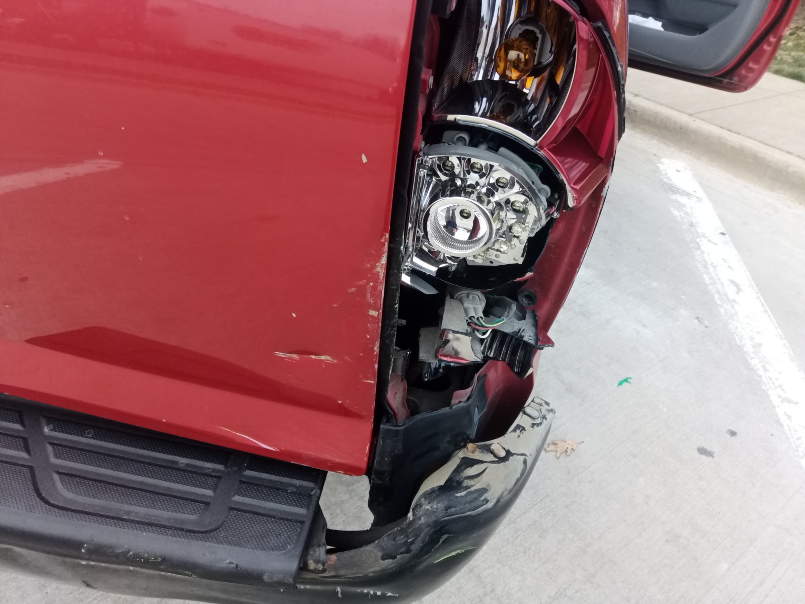

GLA!... how much is this gonna cost?
What happened? I think I can see an old person in the reflection of the last photo.
out-of-state roadtrip (Illinois) to visit some relatives and old friends of a long-time friend that passed years ago
backed up traffic, sitting stationary, at a red light in the dark at 5:30pm
a guy in his commericial truck (Chevy Colorado) heading back to the office or on call to a jobsite was also sitting stopped behind
then the BANG
he said there was someone behind that had been riding his a$$ too close for comforts and to avoid them rear ending him he tried to maneuver into the right turning lane to avoid gitting hit from behind and clipped the back of the Taco :eek: from his driver front left corner
no bodily injuries

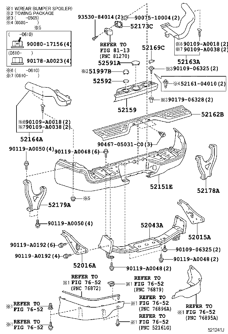

Same for the gen3 bumper...it's to save one money....you just remove a couple bolts, pop the plastic retaining rivets, to replace the broken piece. I took my rear bumper apart to cosmoline the steel section underneath where all the salt, and sand collects.

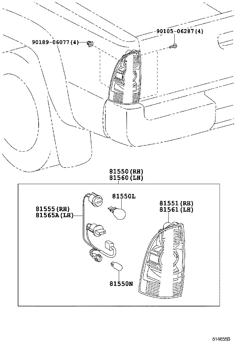

Hmmmm.... the only damage I see is the taillight. Those are about $200, then install. Although, these are held in with just a couple of screws and 1/4 turn sockets. Maybe a 15 minute job to pull the broken light and install the replacement.

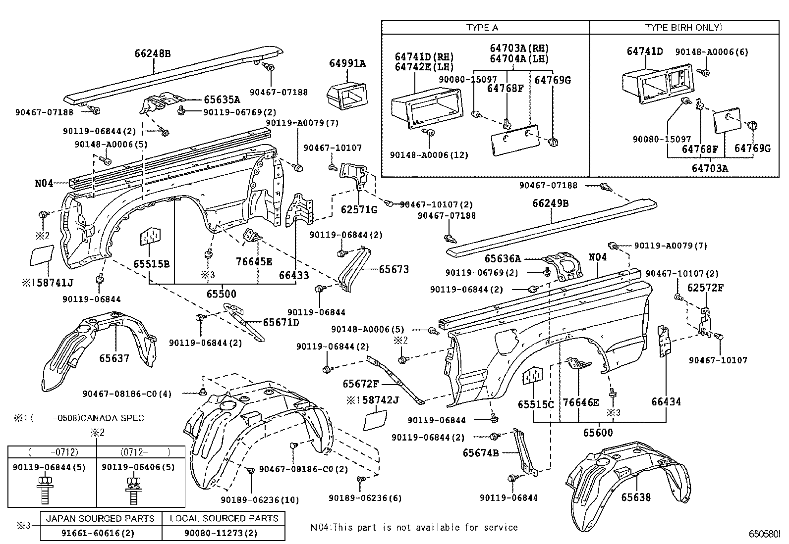

Body shop said the bed has to be pulled to remove and fix the side panel and whatever part got jammed behind the taillight assembly
Something structural?
Back to my original comment.
Let the other guy be responsible for the costs. His insurance premiums are not your problem or concern.
i have no clue how the bed side-panels are constructed on these trucks and what is behind it all :confused:
something damaged broke back behind there that likely doubled the repair bill in an instant
