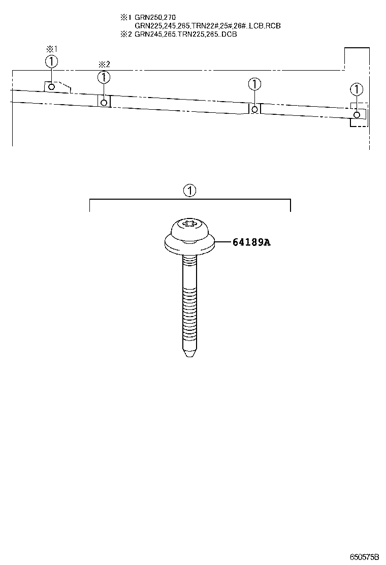

found the rear body mounting bolts to be replaced in the event this box does have to be removed for proper repair
17$ each MSRP and need six
except another diagram notes 8 bolts?

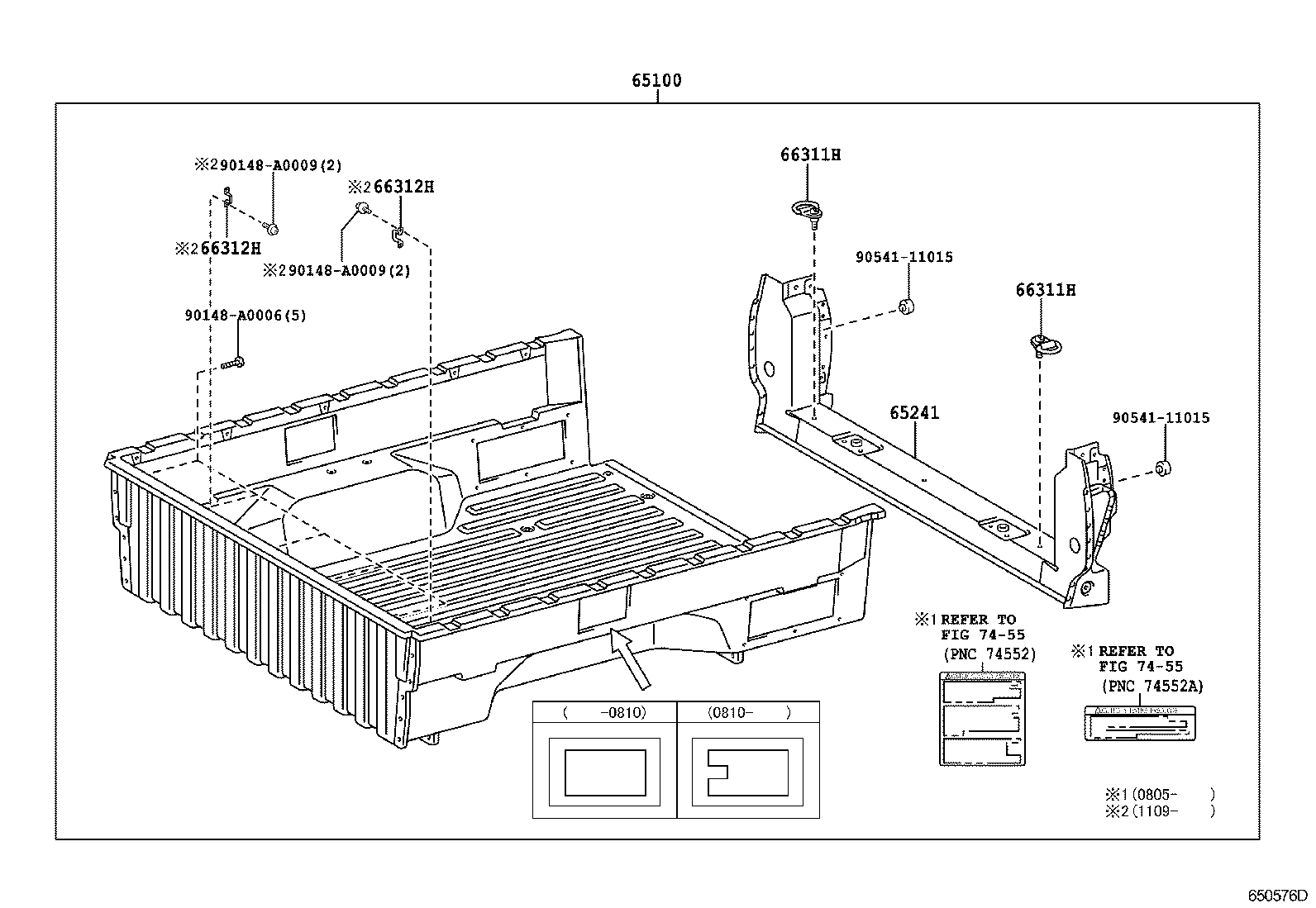

I need to go back to the body shop tomorrow that did the estimate and inquire exactly why?? Does the bed need pulled off the frame rto properly repair what again??
It was not clearly explained to me on Friday or I was unable to comprehend

was now informed that the box does NOT need to be removed for proper repair
