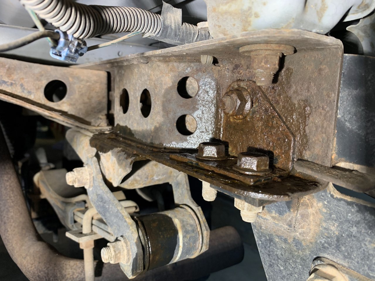

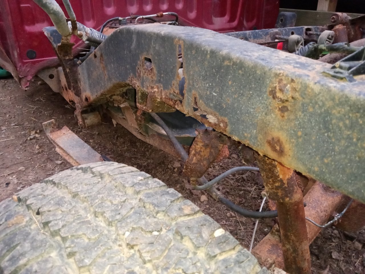

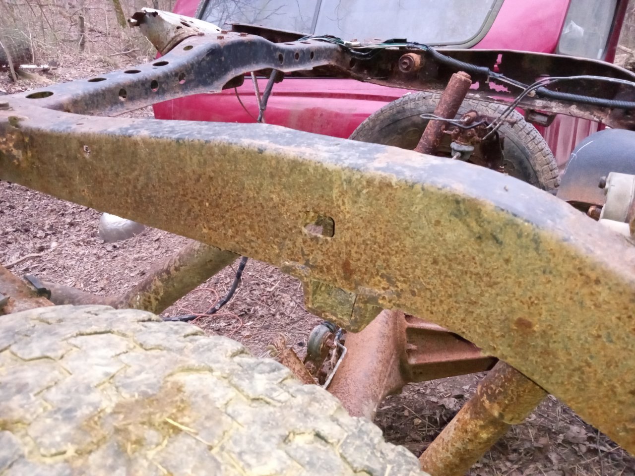

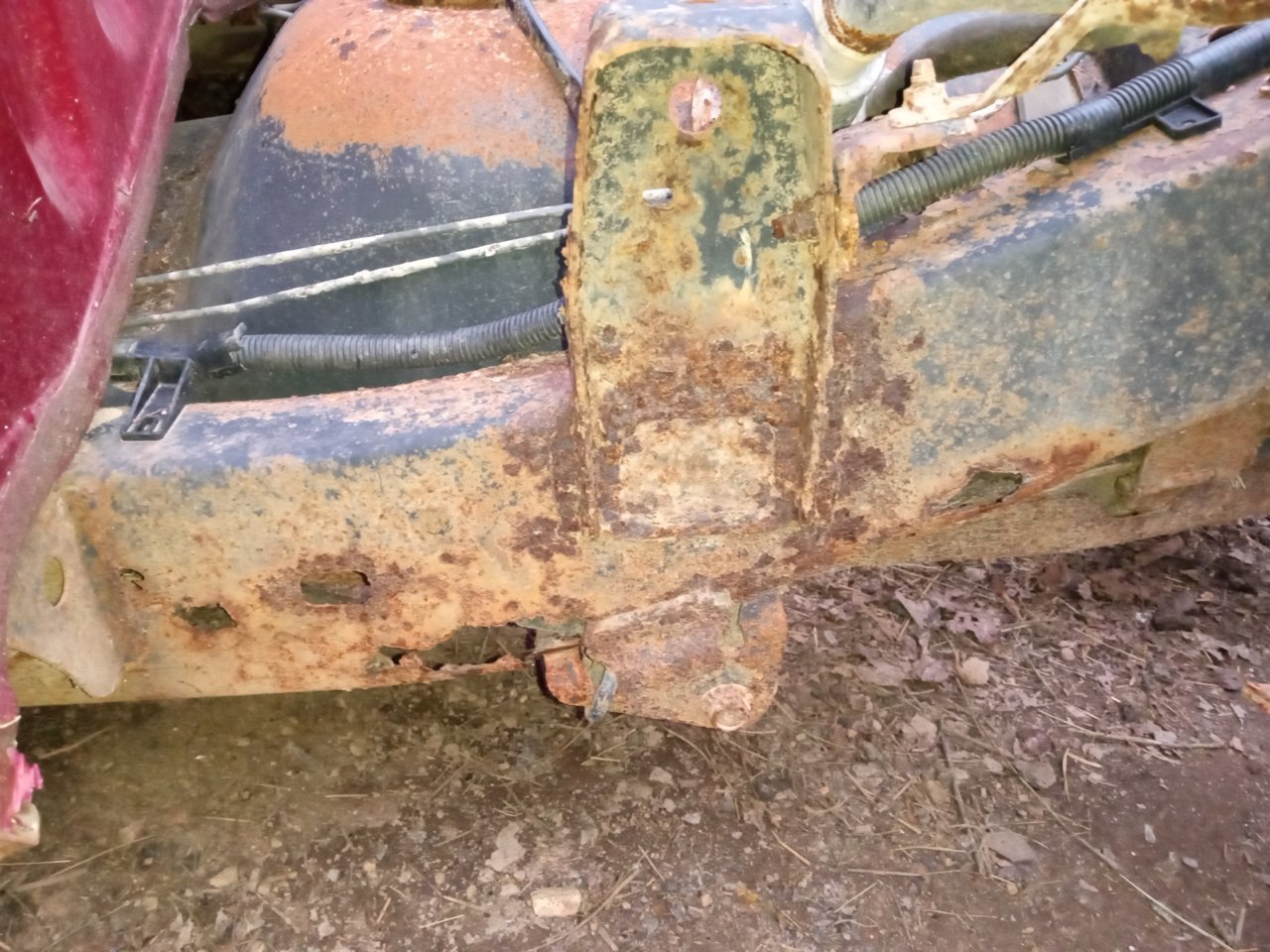

is this nothing more than just surface rust?

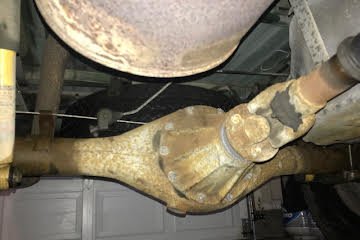

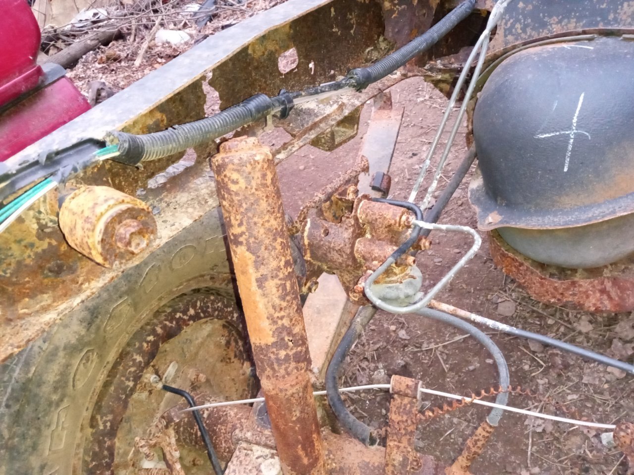

~ 9 years and 252k miles in MA
do these guys not ever wash and rinse routinely underneath it all as best they can
check on them drain holes for blockage

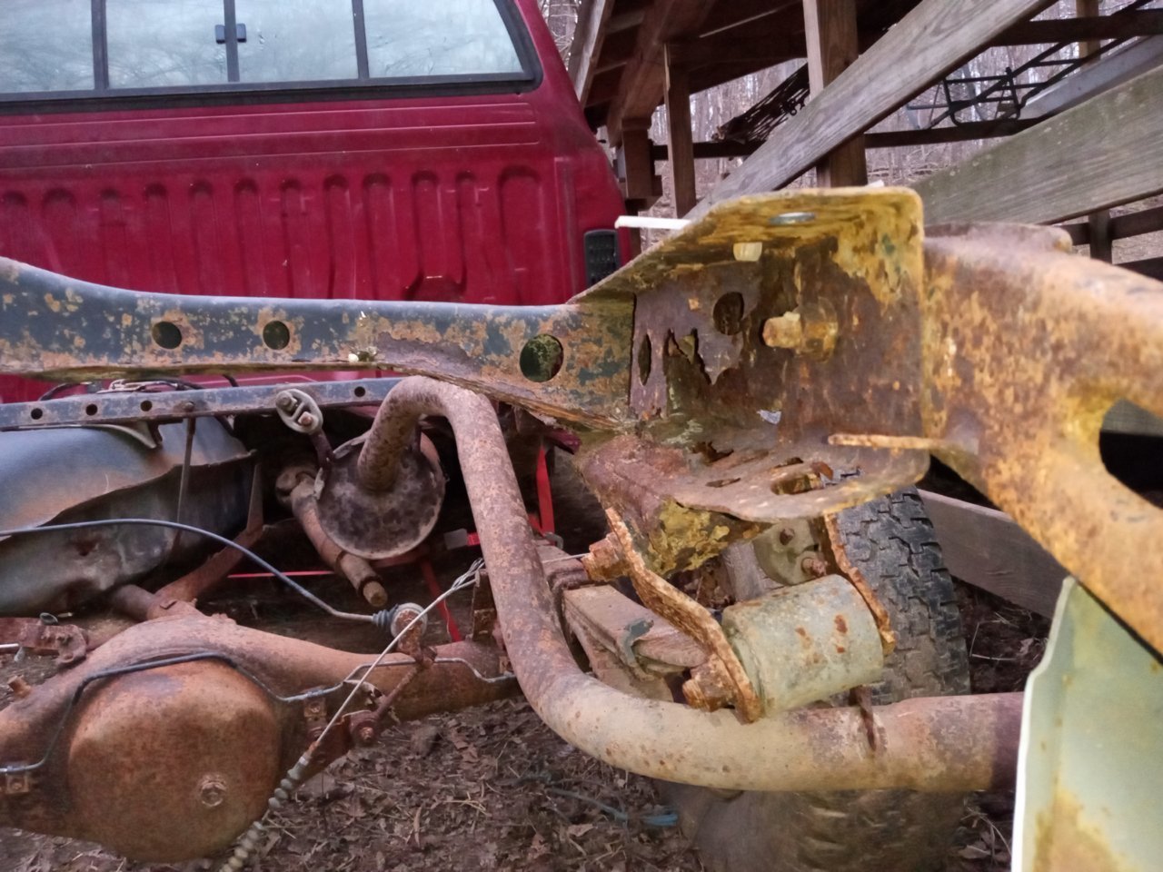

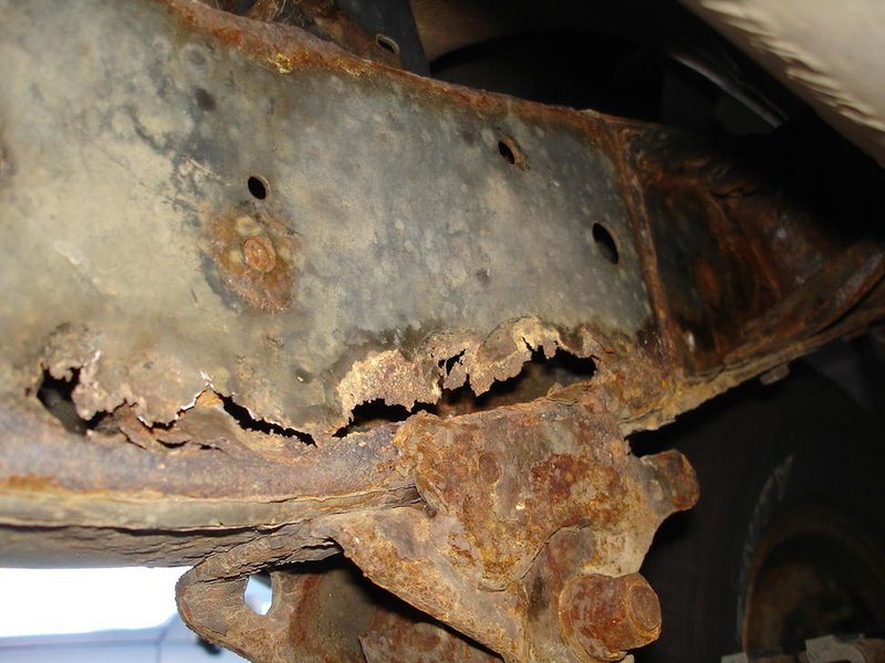

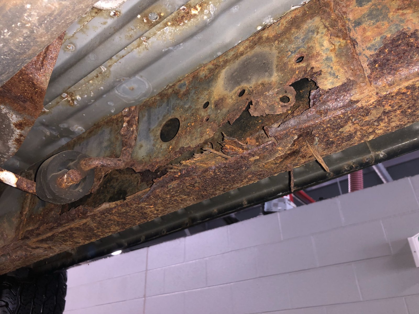

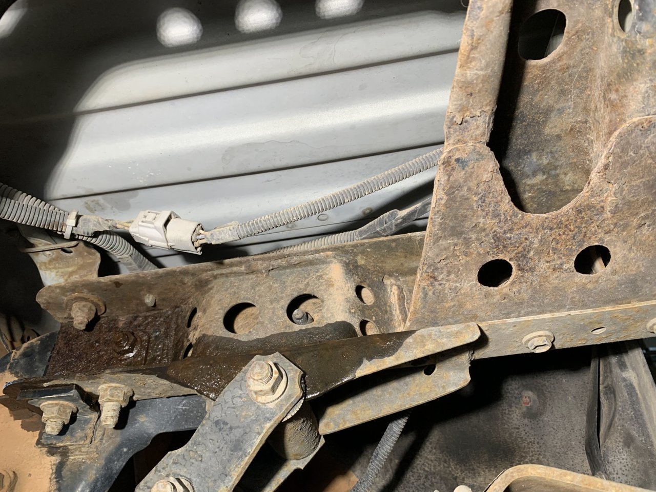

Ontario Canada
5yr old replacement frame
Claims to have been routinely undercoated twice a year

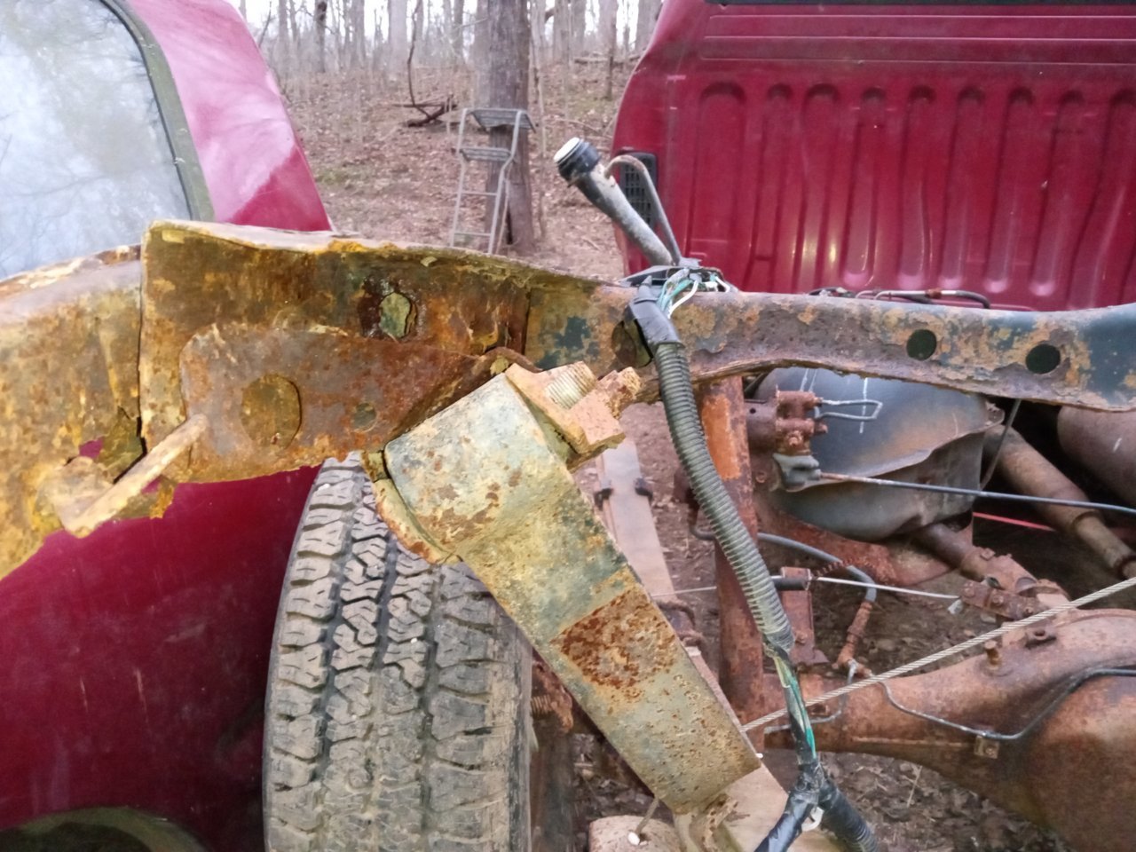

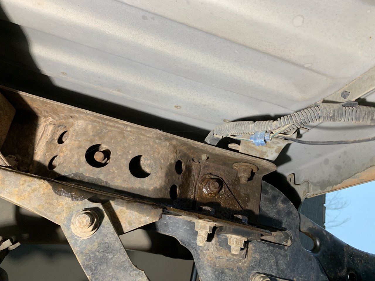

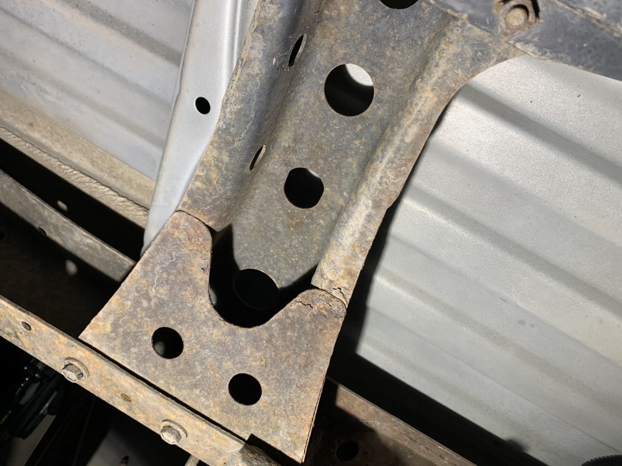

i think Toyota did absolute NO salt-spray testing in their labs whilst developing the protective frame coating used...
What protective coating? They sourced their frames from Dana who sent them out only with black chassis paint. Toyota just stuck their cabs, and beds on them. Its only the latest gen3 tacoma's toyota is finally doing a bit more on these frames in the problematic sections.
whatever black coating they use on the steel frame that is supposed to keep it from rusting
its not yer normal chassis paint for sure from my experimenting with eastWood chassis paint for the past several years

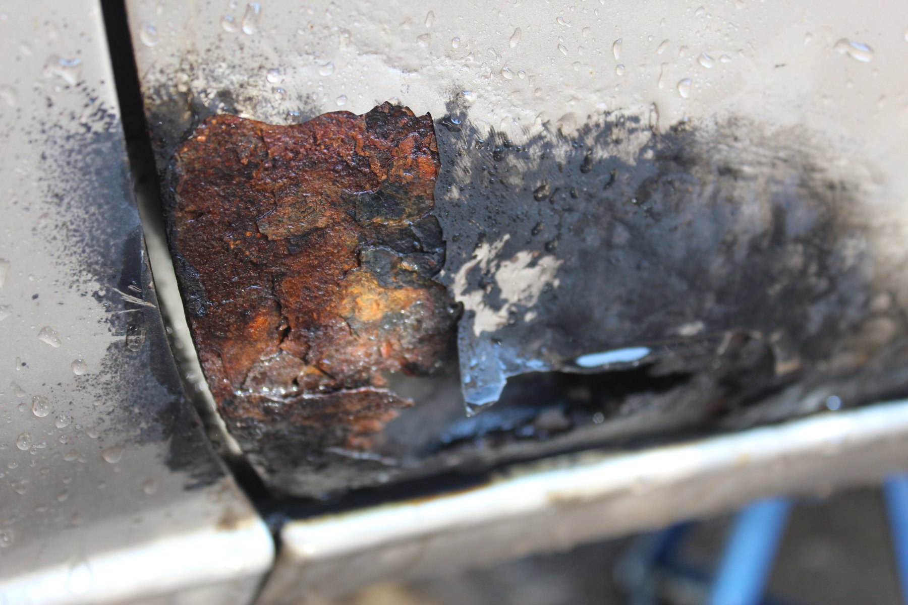

that previous picture is of some buteful work done by a Yota body shop some 20 years ago when they reskinned the driver door after some Denver lady made a Uturn right into me whilst i was sitting parked at a red light :(
its the only time i recall being hit by another driver!
Eastwood chassis paints are nothing special, they're just paint, like John Deere chassis black paint. The toyota black frame paint is just thicker, but its still paint.
