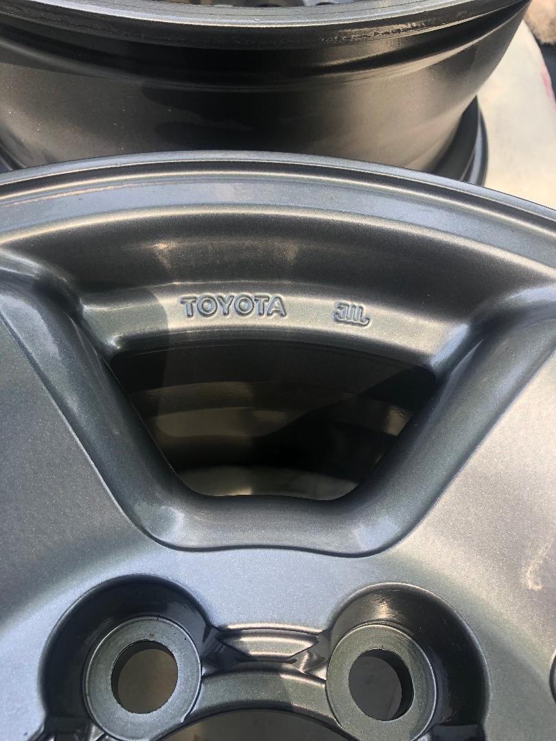

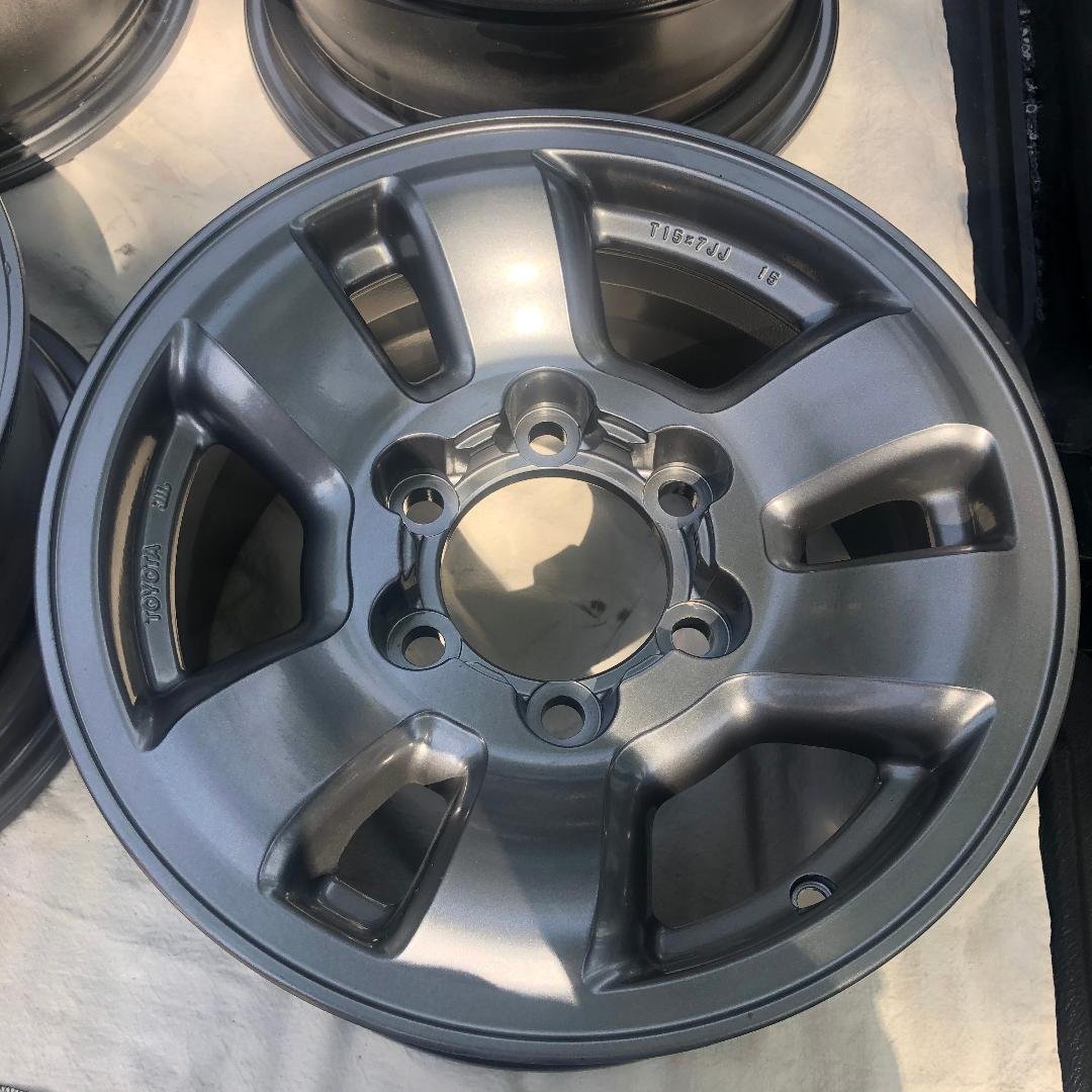

my nearly 300k wheels have SO MANY scars and chips in them
plus the original outer weights made for some nice scarring corrosion marks

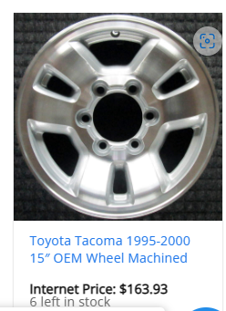

That very wheel is available on wheelsameica.com for $164/ea. Those you've pictured have been painted.

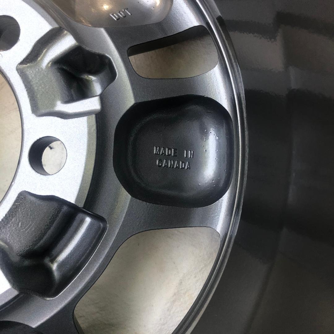

is that wheel Toyota stamped and made in Canada?
i cannot zoom in much to see any deets
C'mon...... I've given you the website, the item that matches, the price, stock on hand.......
You could take an initiative to contact wheelsamerica.com for more details.
I'm not gonna buy and mount 'em for ya...................
