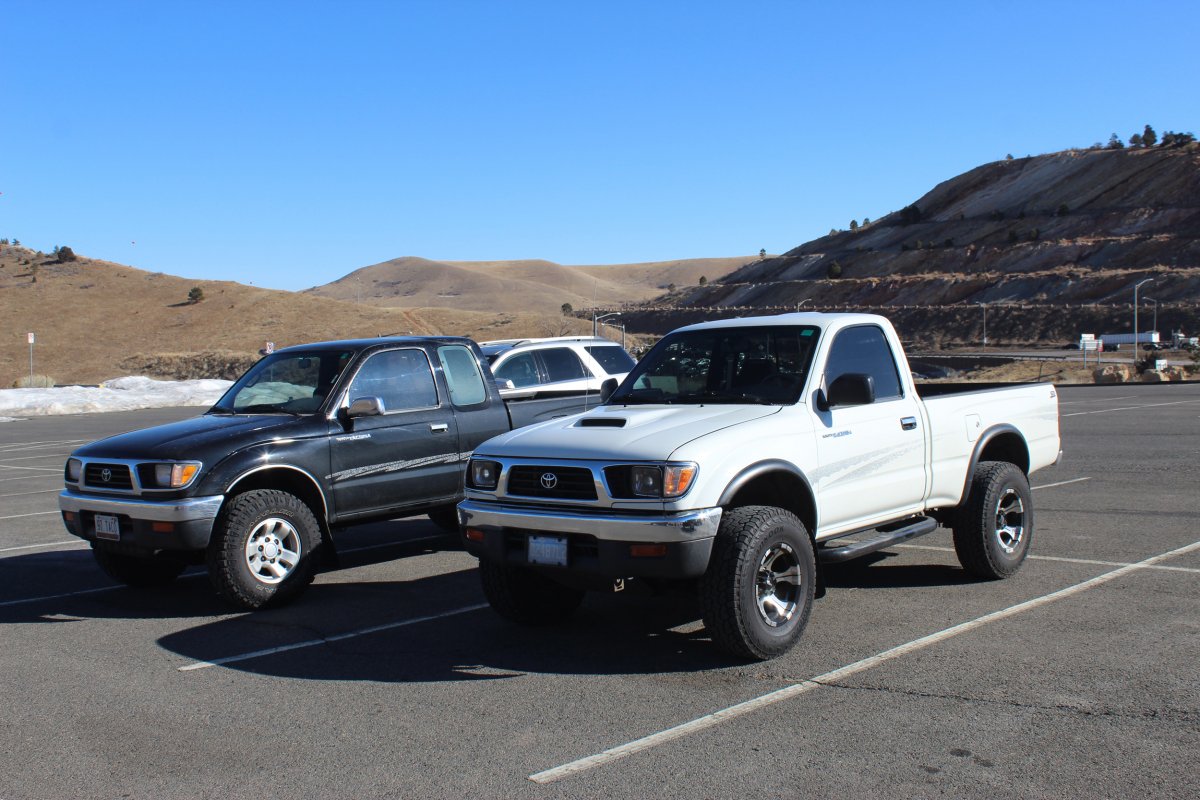

taco john in Denver had some HG issues on his rig in the 400k miles and decided on a replacement engine with lower miles rather than fixing it
its probably the only 'tarnish' on his superCharged '97 v6 single cab for making it to a million miles, he currently has over 710k, when he goes to Toyota for the accolades and acknowledgment of merit
i met up with him outside of Denver in January-'20
... shoulda washed my truck before this pic :( it was a dirty drive across Nebraska on US-34 to Denver that winter day
