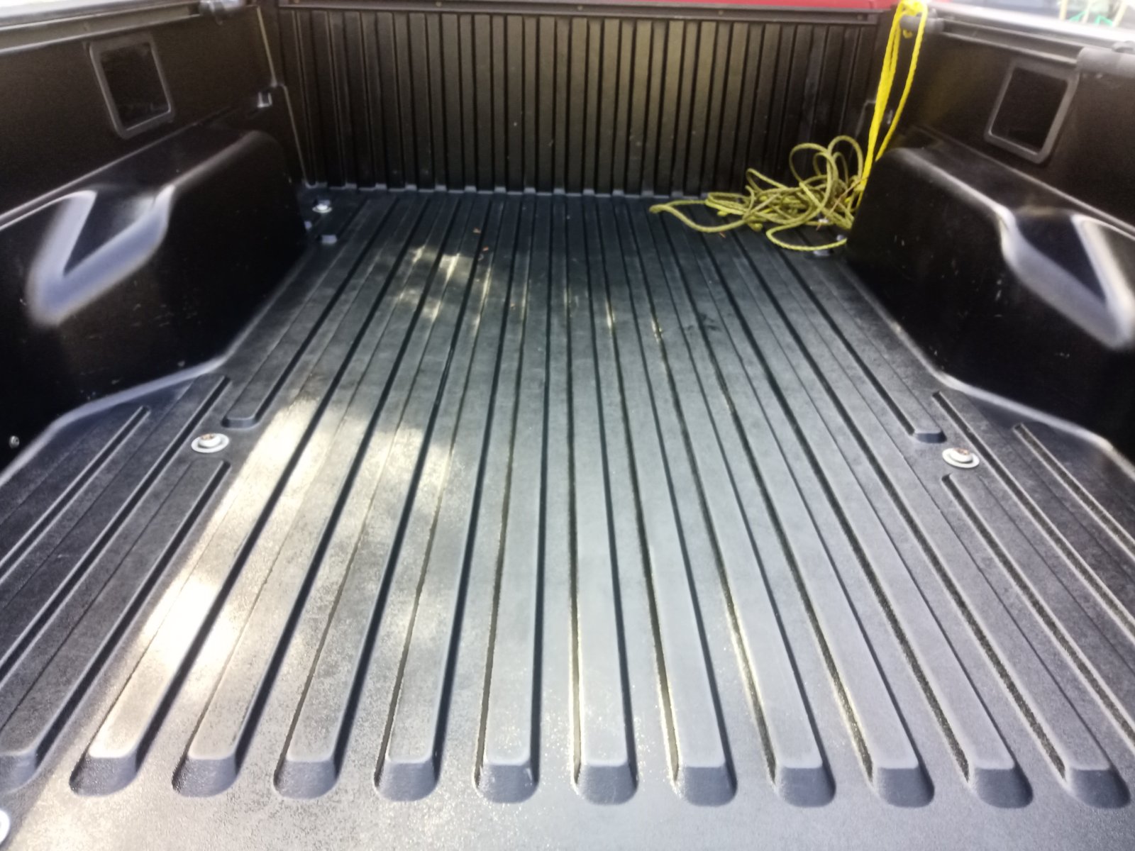

Appears hard and shiny/slippery. I'd get a bed mat if carrying anything. My gen3 bed came some sort of coating, but its more on the wrinkle finish side. Without a mat anything not tied down will slide everywhere.
Yeah I have some scratches on my bed walls, and tailgate, but under the mat...zero. At least it's one place in the truck that can't rust.
yes, no rusty crusty!
BUT?!!??!?
can these composite bed actually CRACK and then leak and or CRACK get much worse that it all needs replaced
