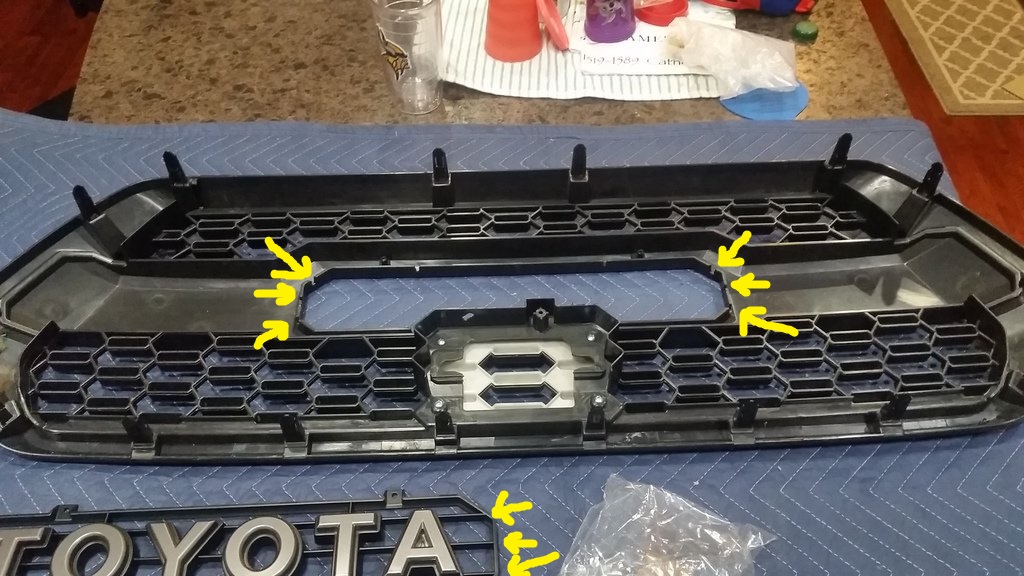

    Simple to remove the complete assembly off the truck. Lay it face down on a piece of carpet. Remove all the trim ring screws first. Then slowly unlock the clips from the trim ring and grill. After you install the new grill be patient and make sure every clip locks. If not you will see gaps after you install the assembly on the truck. Also test fit the center section. If yours is a 2 piece like mine you may need to take a razor knife and trim the areas that are cutout on the ends. I had to do this so the screws would pull the section in flush. If you don't have the 2 piece grille then this is not an issue.
    See the attached pic. The yellow arrows show where some trim work was needed in the grooves of the larger grille so the insert would sit flush after it was assembled.

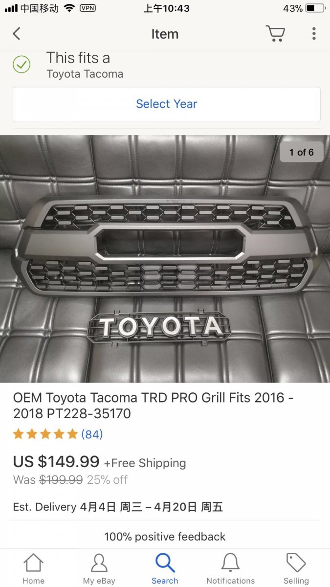

    A604EA02-741E-42E9-B4A8-226EB43F4249.jpeg Just got one of these, letters are molded in a center piece and screwed into the grille, don’t trust the one comes with separate letters and need to be stuck to the grille with some tape.

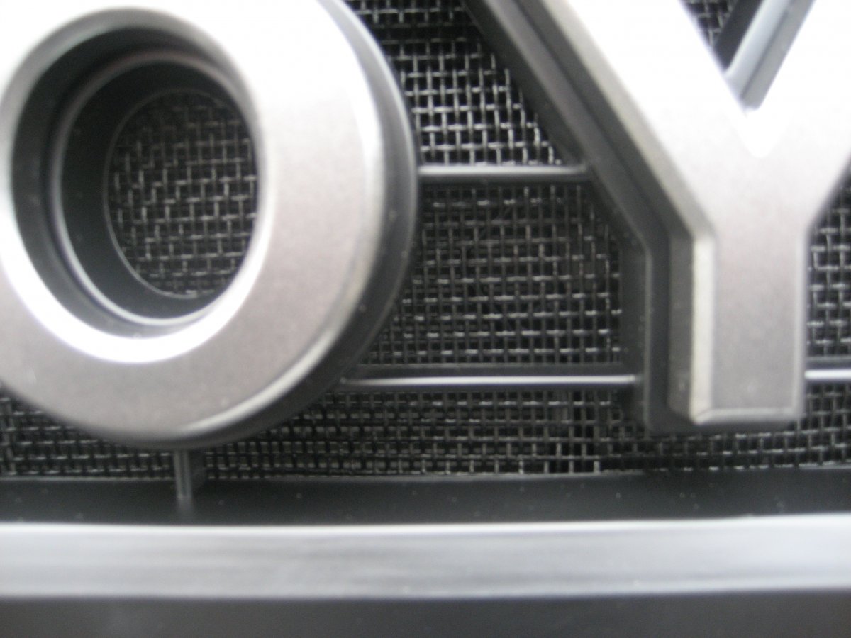

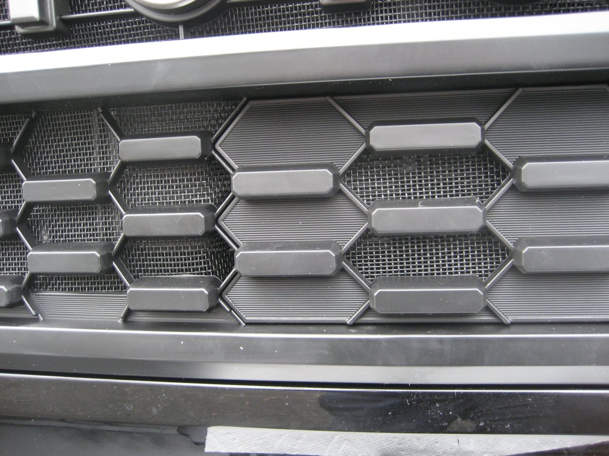

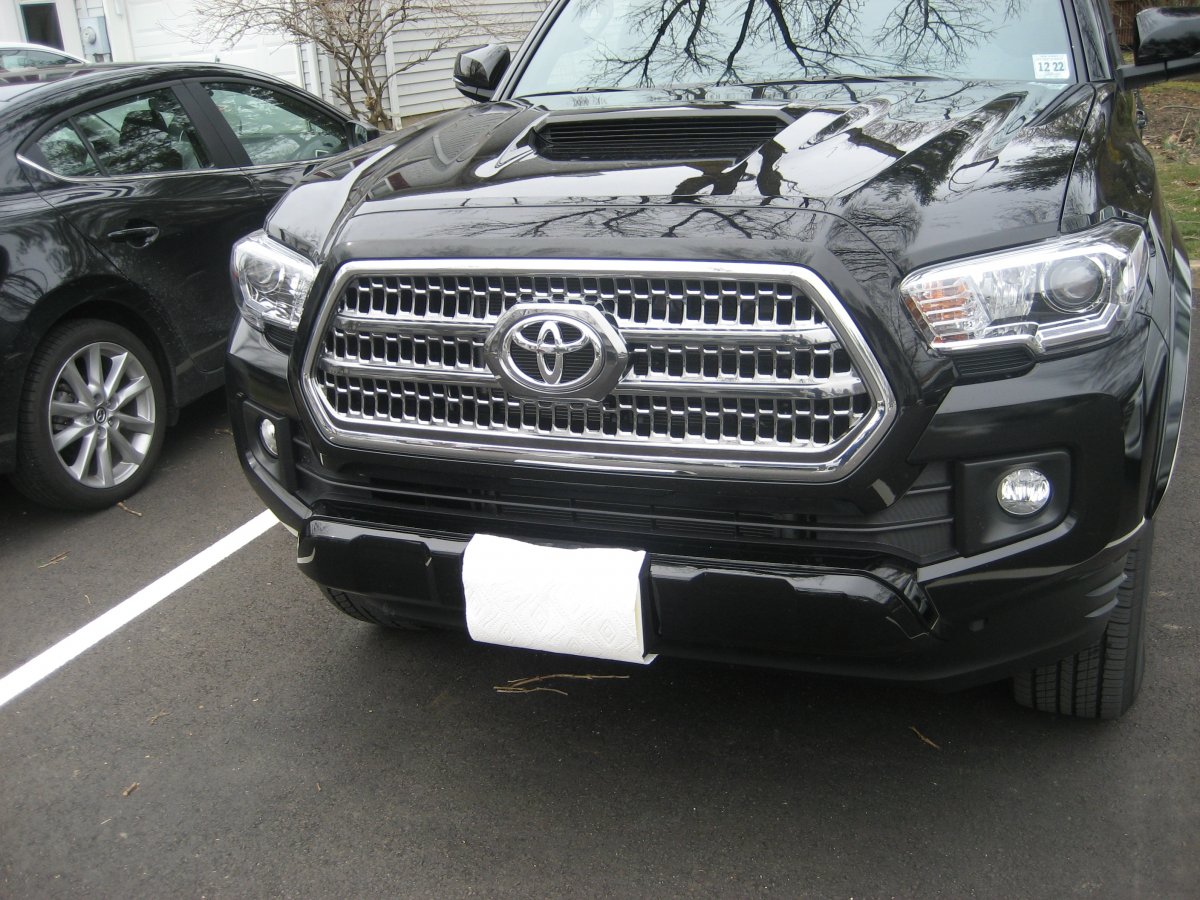

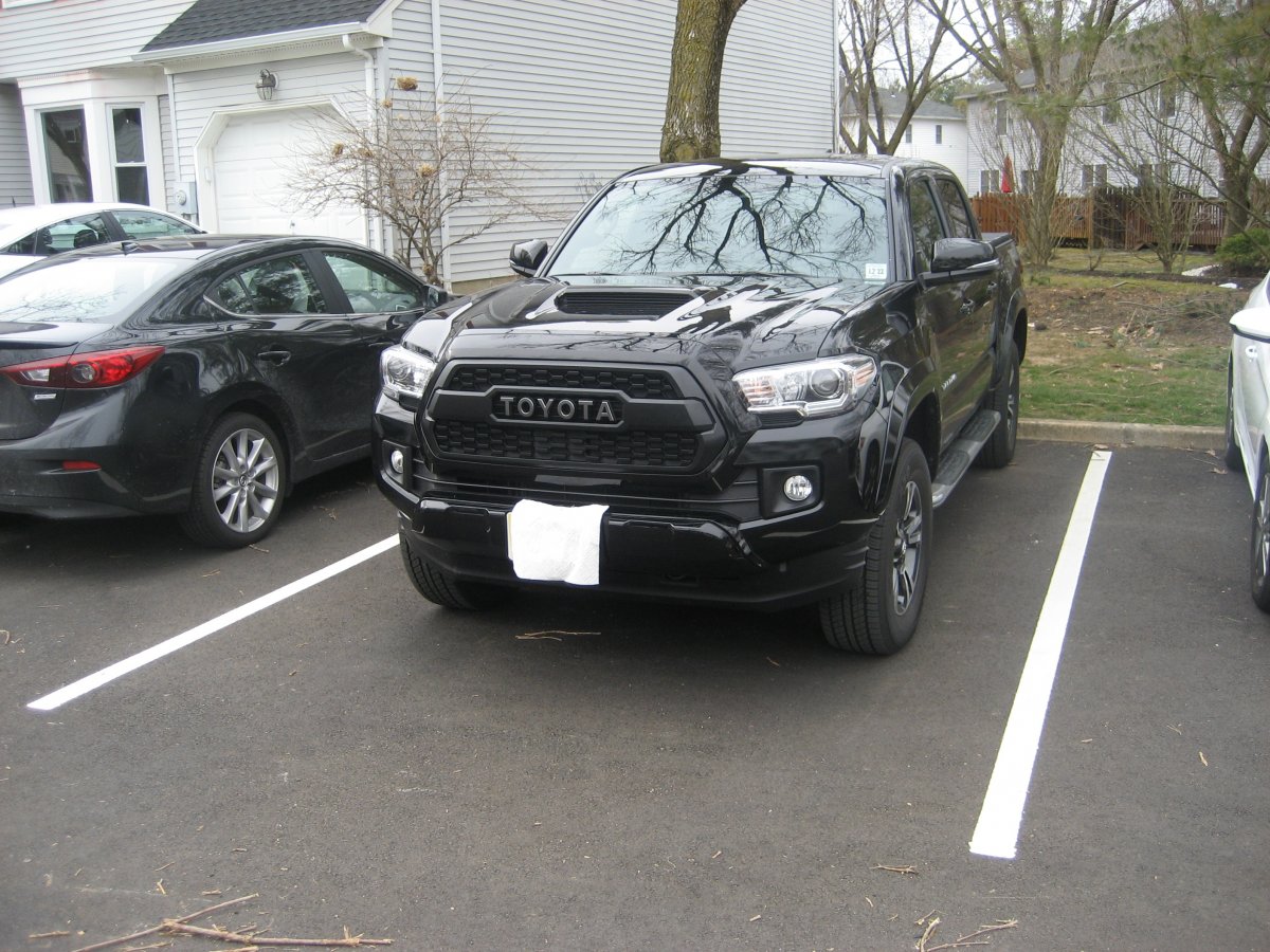

  6. Hello everyone,,Another EBAY grill,,135 bucks,,,,,,check it out . Before and after,,,with the soft Black Bug screen on the inside IMG_0148.JPG IMG_0147.JPG IMG_0145.JPG IMG_0143.JPG

    I have been considering the same thing. A lot of open space for summer creatures to fly into. Where did you buy the mesh material. Did you simply use tie straps to hold it in place.
  8. OR17TRD
    Air flow

  10. Good old Walmart,, rolls come in different lengths..Cut it to fit and used Clear silicone,,airflow did come to mind,,Did this to my Ford,,didn`t seem to affect it even when weather was hot in mid summer
    Bogunn and OR17TRD like this.
  11. Bogunn
    Yeah. That was my concern too when I saw that. I’d definitely keep an eye on the heat gauge.

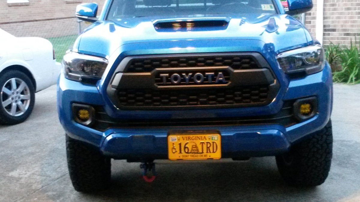

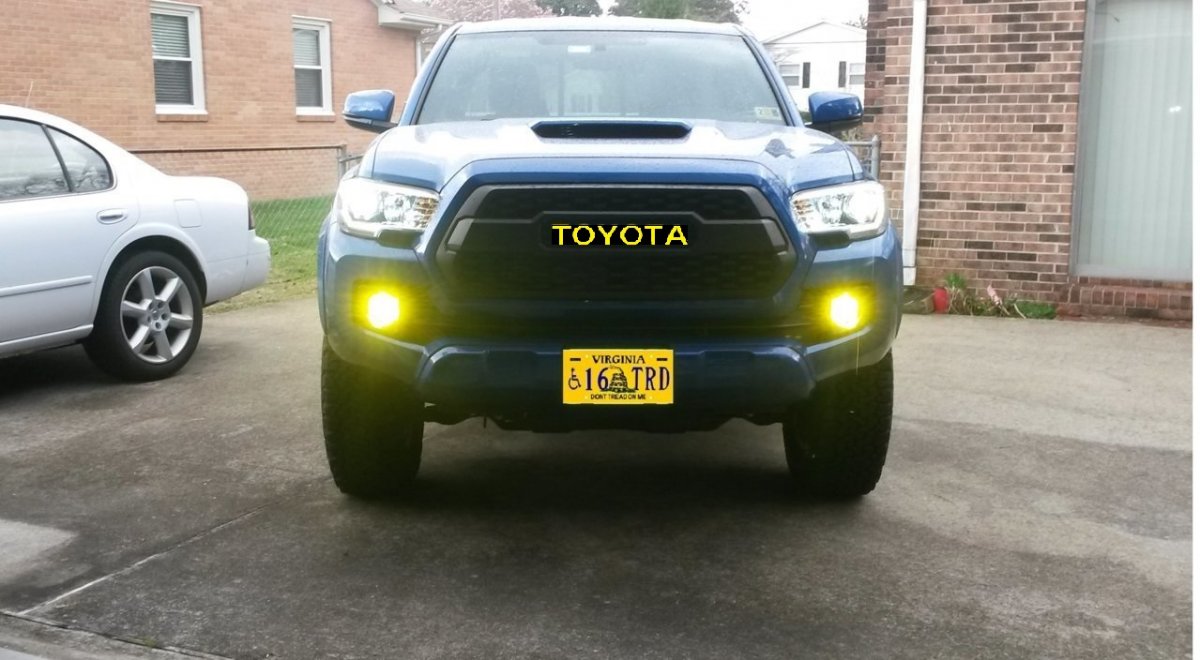

    Considering a grille letter color change to match new plates and fogs

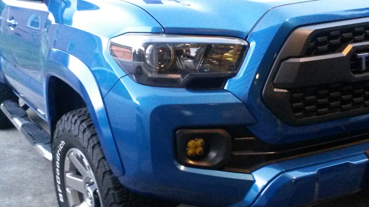

    20180601_202247.jpg Pro headlights.jpg Added the headlights to match the grille
