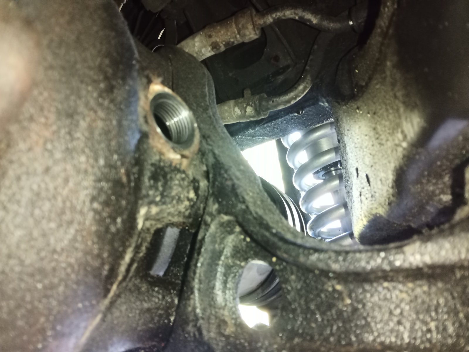

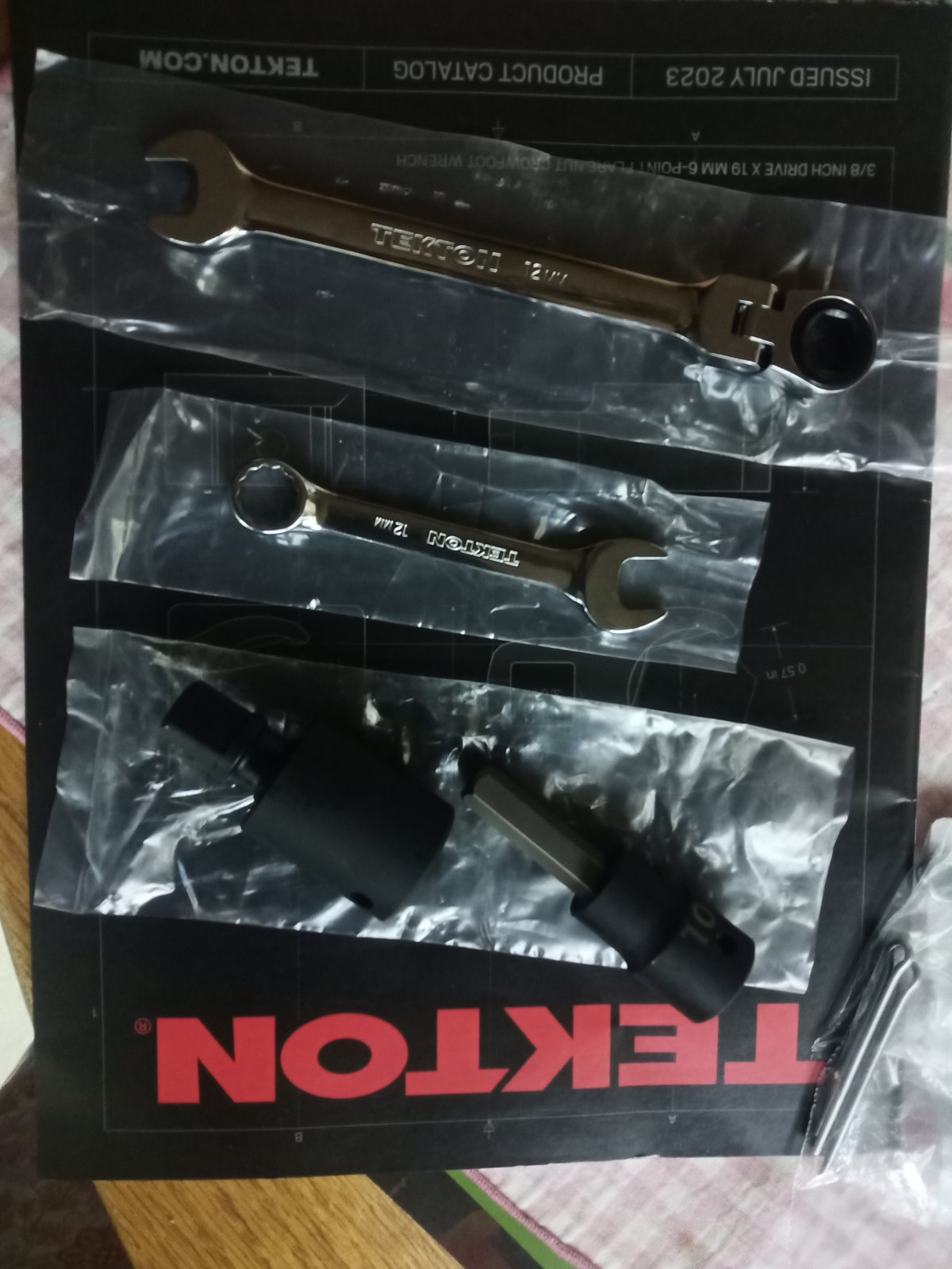

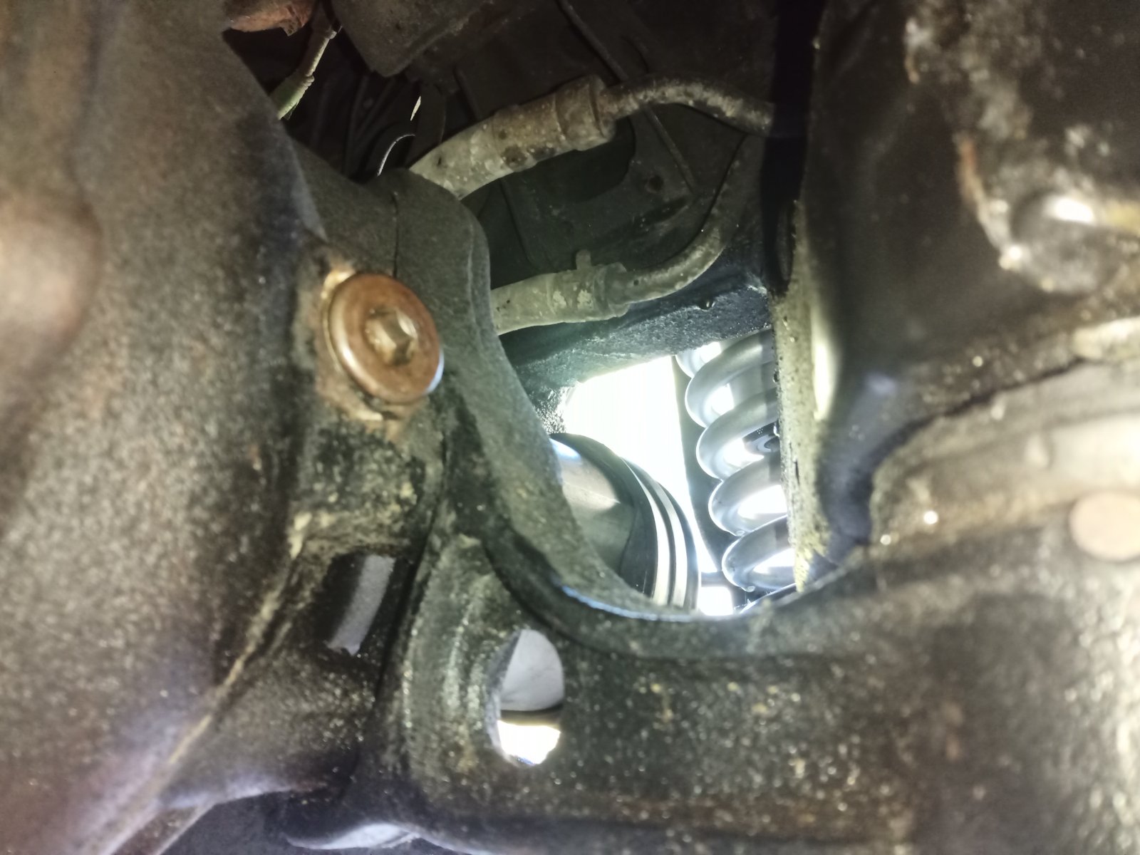

New tools arrived to get at this front diff and check level first + scope the situation

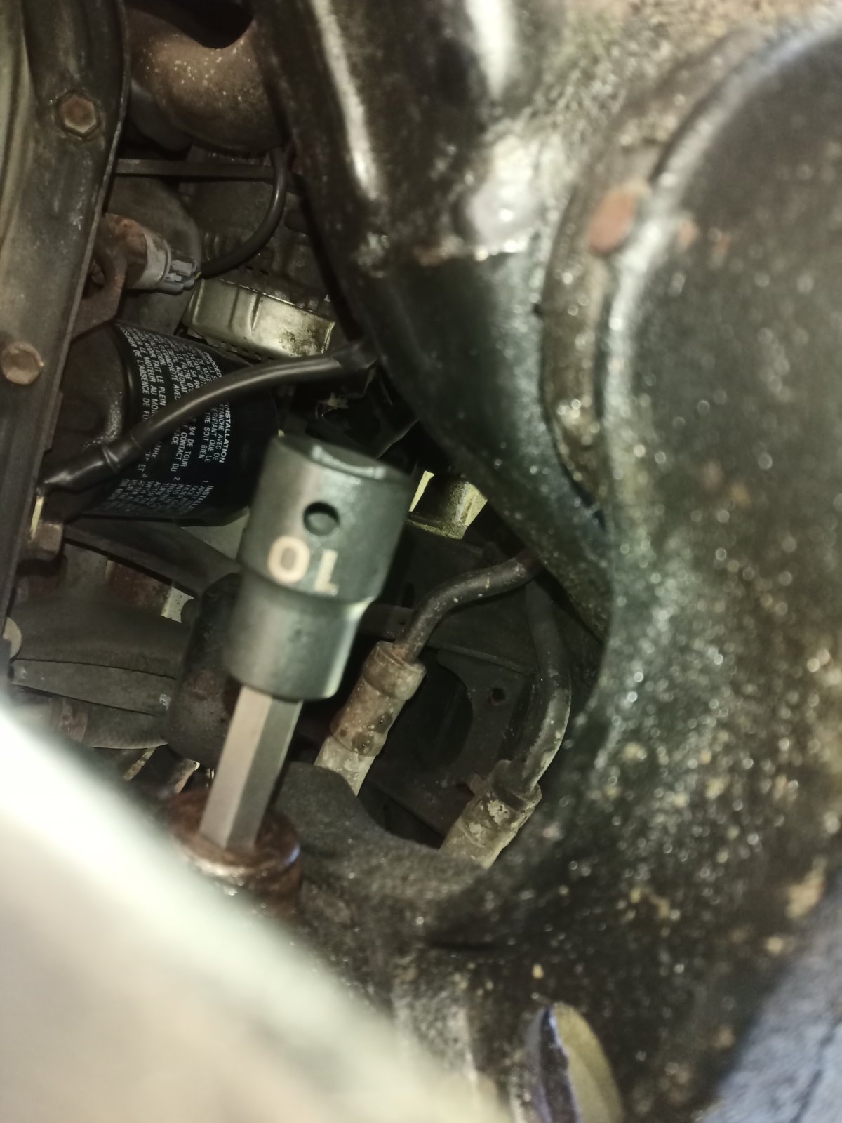

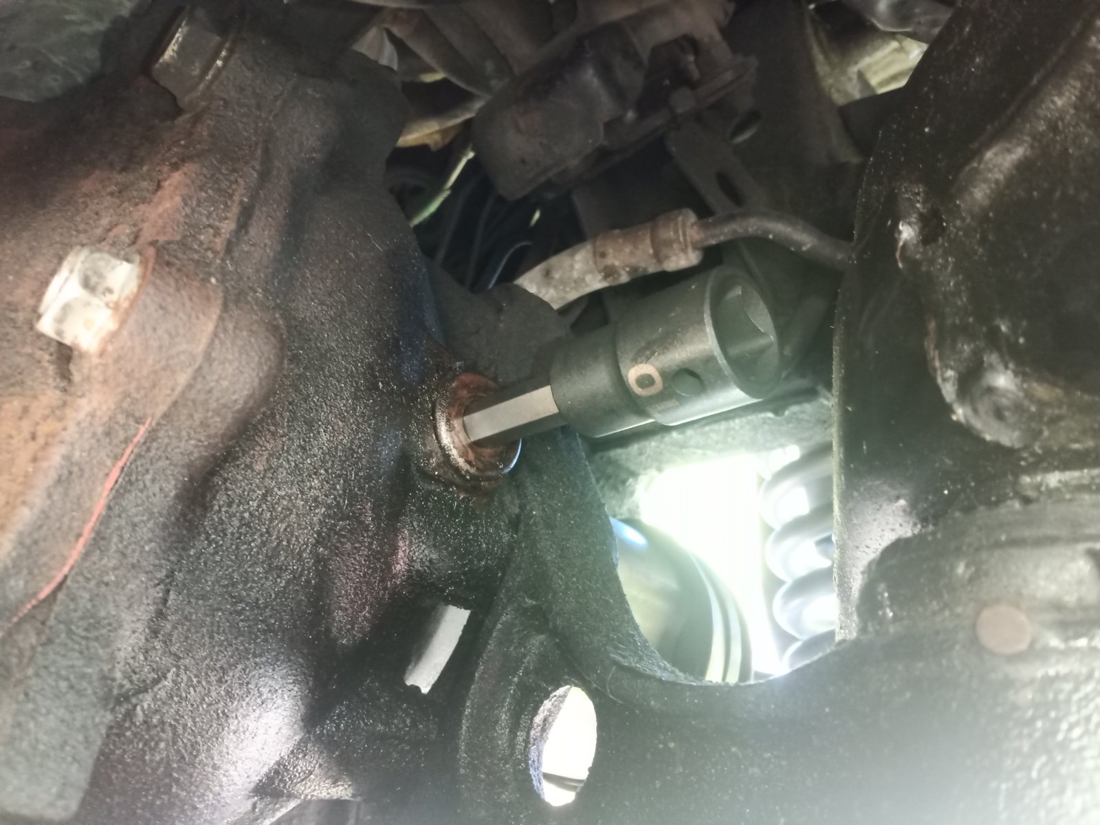

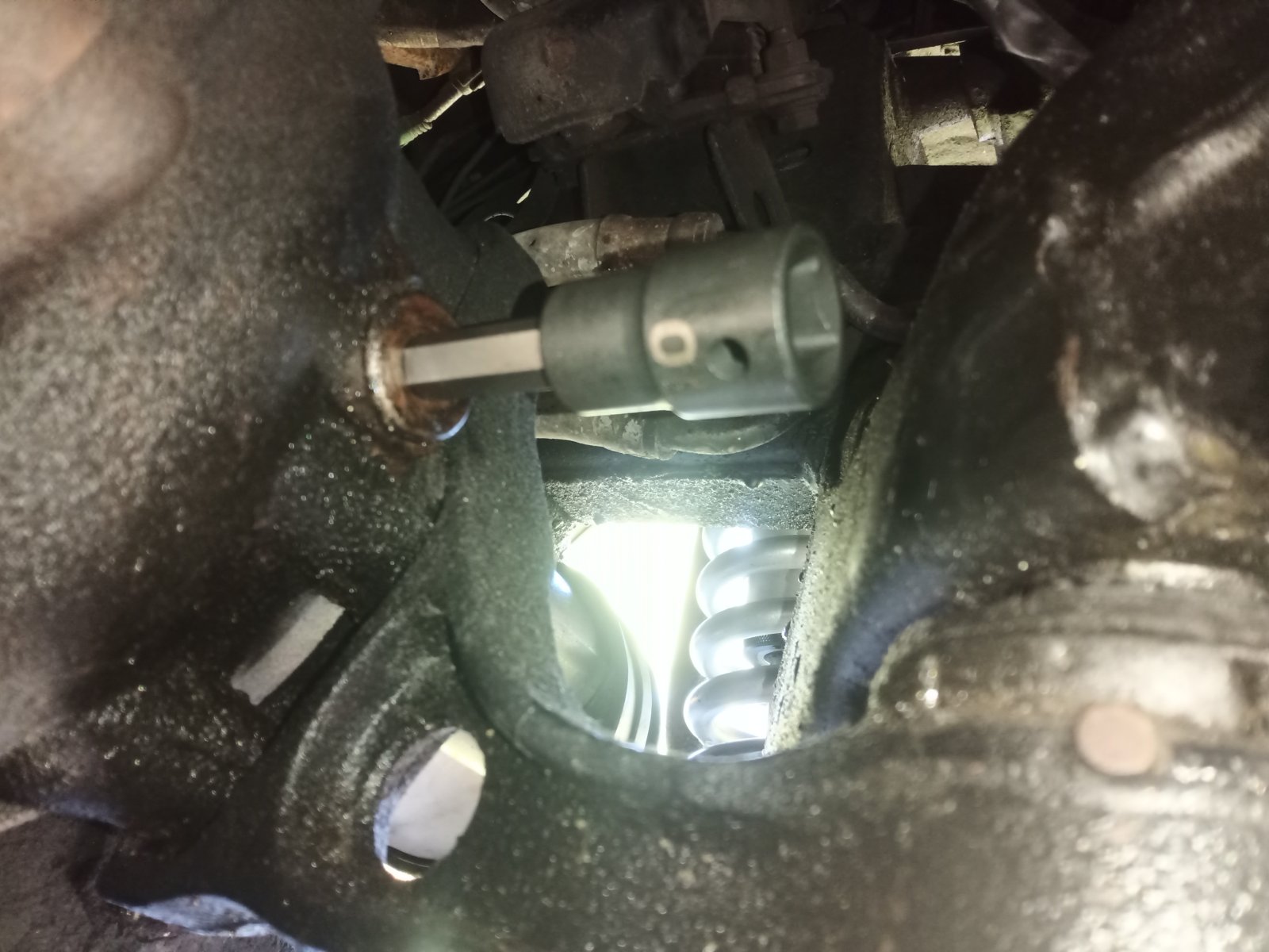

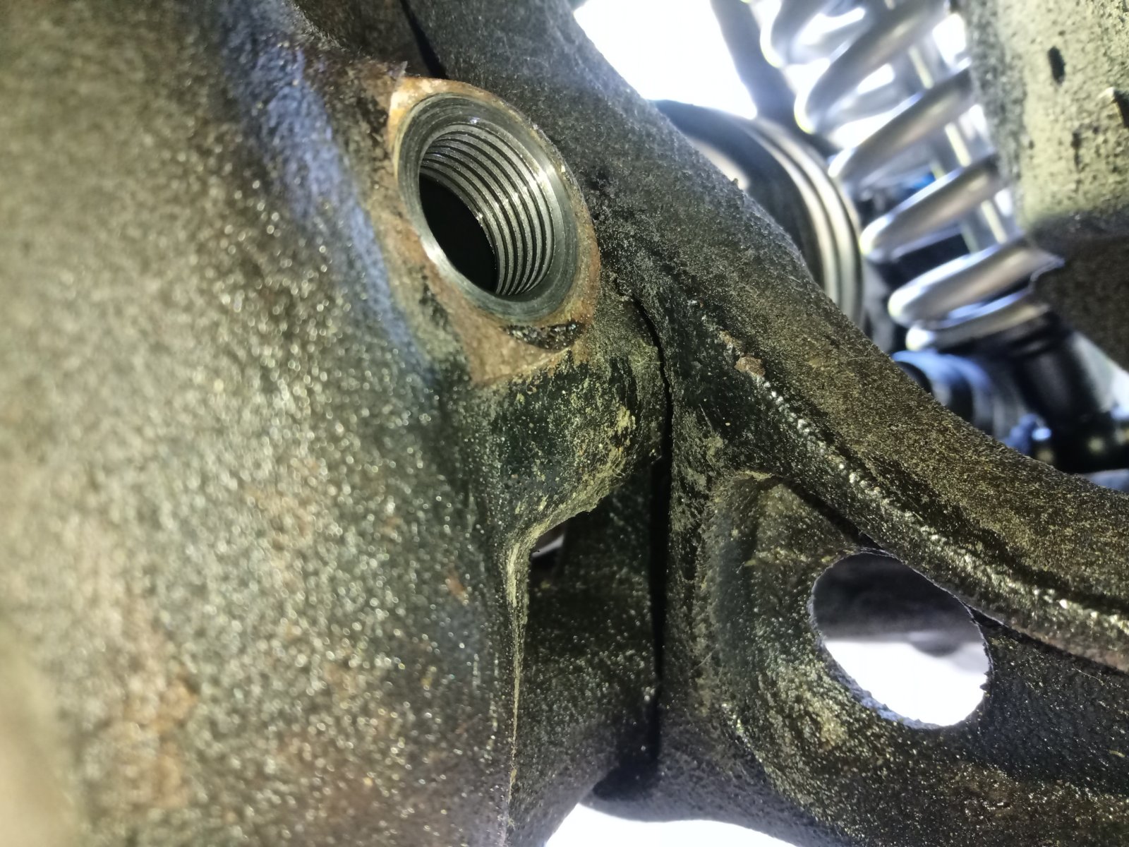

2ft breaker busted my shoulder on the drain plug, but it popped with a LOUD bang
1/2" new hex10 would NOT fit into the fill plug area
was short 16oz somehow in that front diff
that's like a WHOLE 1/2 quart!
Maybe leaking?
perhaps... but 1/2 qt is major leaking in a thousand+ miles
i think they did not check level and refill to full or just change it because obviously the FSM was NOT followed... STEP 2

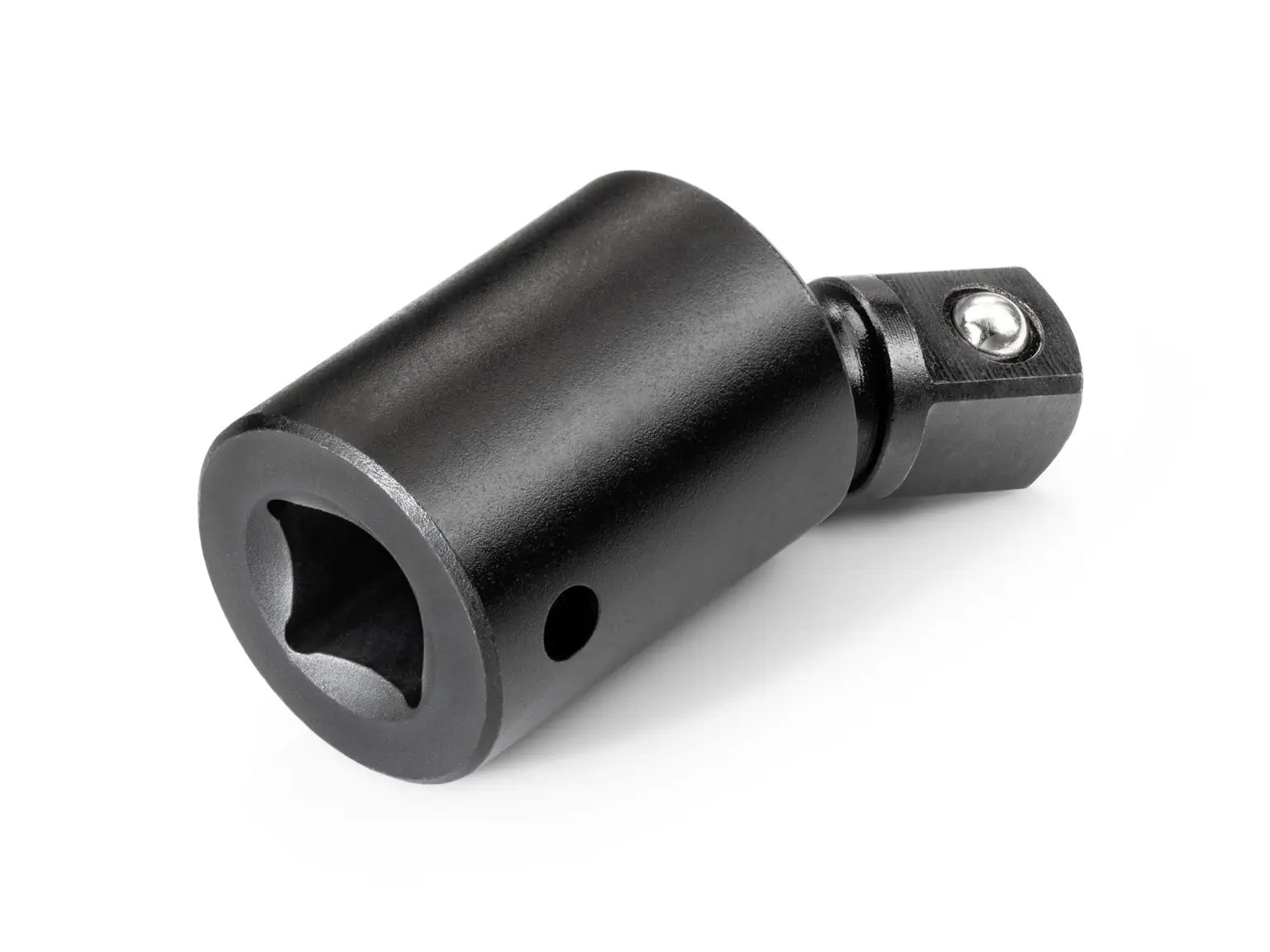

so i bot this for that front diff and didn't even need it or could not use it because of clearance issues
can i use it elsewhere? if not then out a dozen dollars :confused:

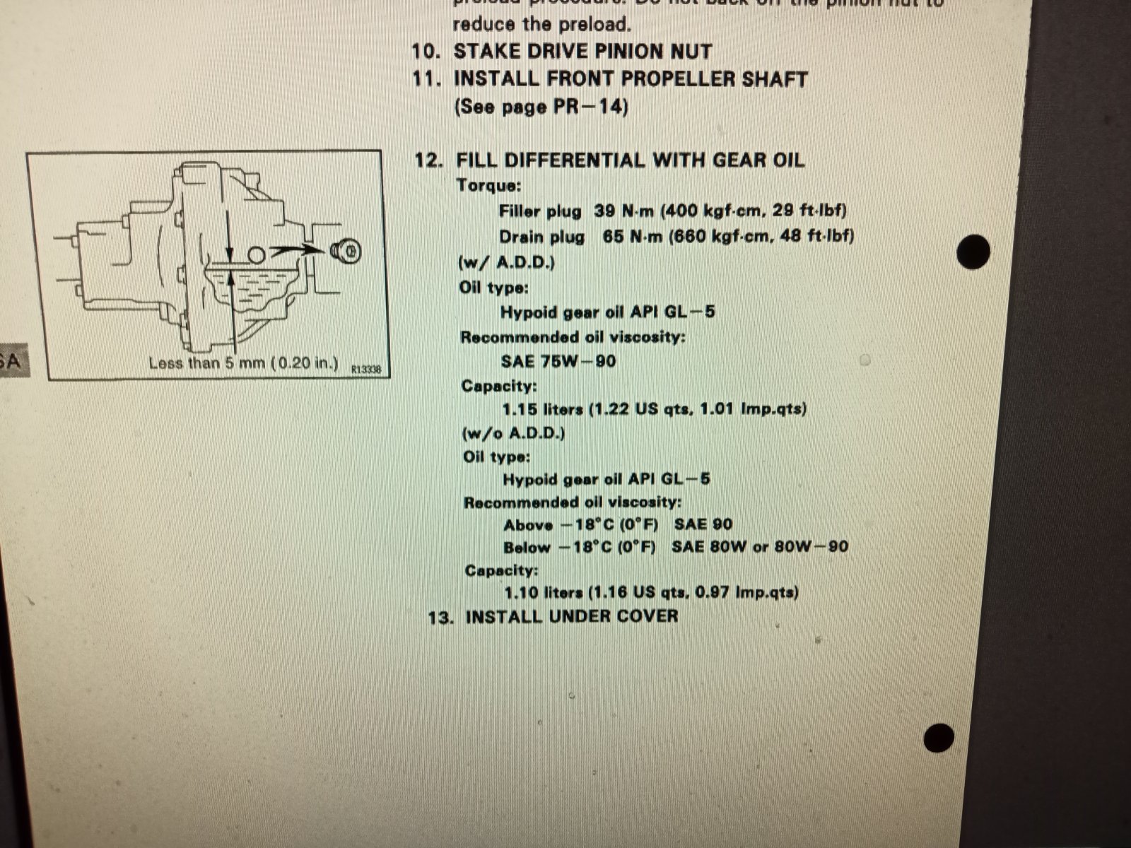

service spec from FSM on front diff
pg. 1070 SA-40
fill plug - 39 Nm
drain plug - 65 Nm
i do not have torque wrench to fit the fill so german torque spec is adequate??
capacity is 1.22 US Qts OR 1150 mL
Stubby for the win on that middle splash shield skid bolt and nut
