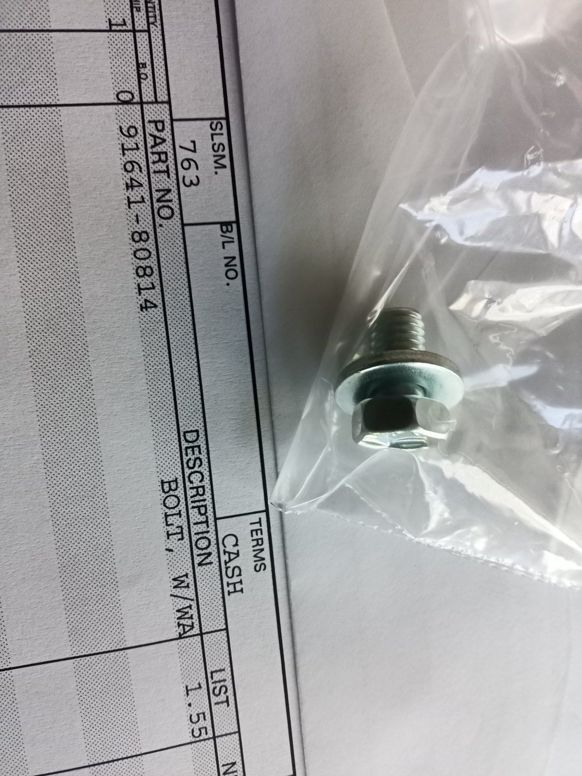

New yota bolt to replace one sucker that got lost under for that lower fuel tank shield

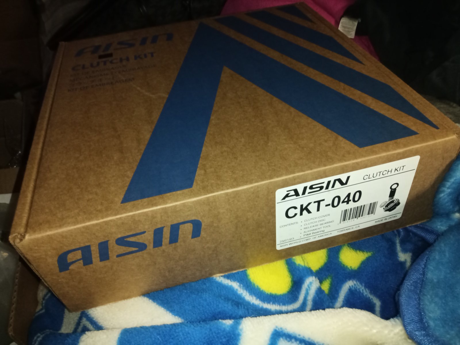

i found this clutch kit to be missing the pilot bearing, that was supposed to be included in the box :confused:

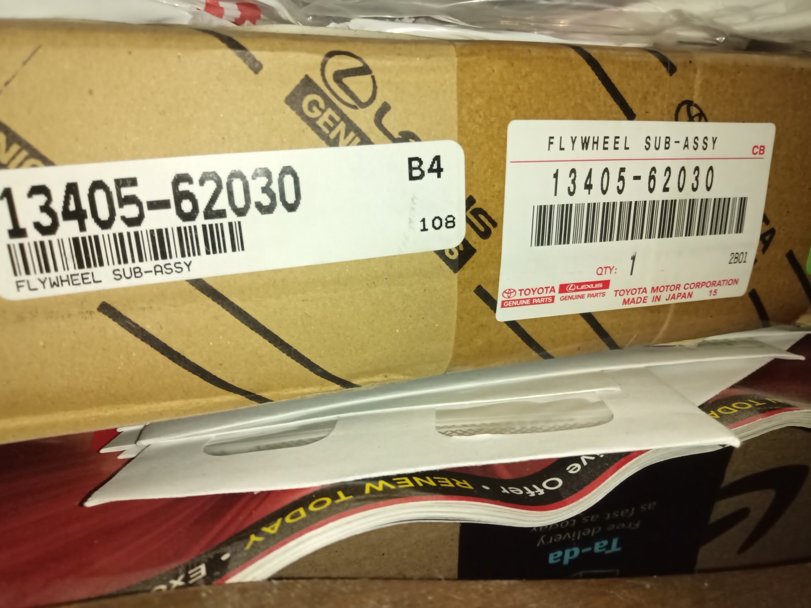

The extra things that can easily manifest are heat checked, burned flywheel. This would need to be faced at minimum (damage dependent) or replaced.

Alignment is critical on these parts. Flywheel/Clutch/Diaphragm Spring/Pilot Bearing/Trans. Plus all the friction surfaces must be pristine clean.

stoked about seeing what condition the flywheel is in if burnt or not

You can take it to the bank, that flywheel is toast needing to be refaced, or replaced.

You can take to the bank, that flywheel is toast needing to be refaced, or replaced.
