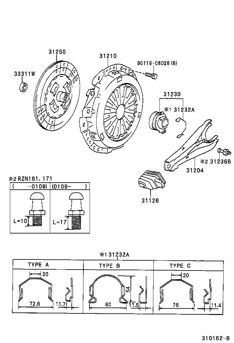

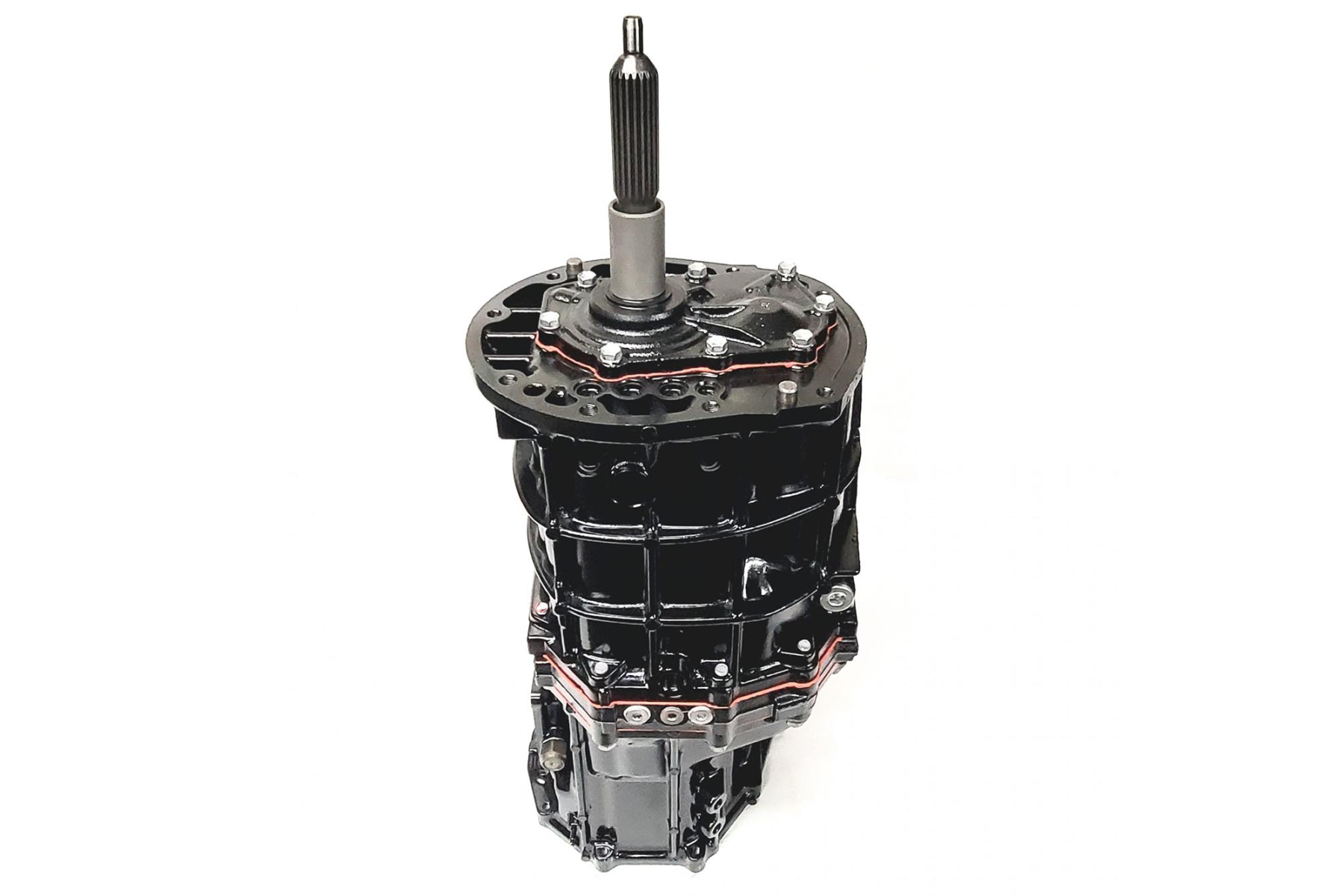

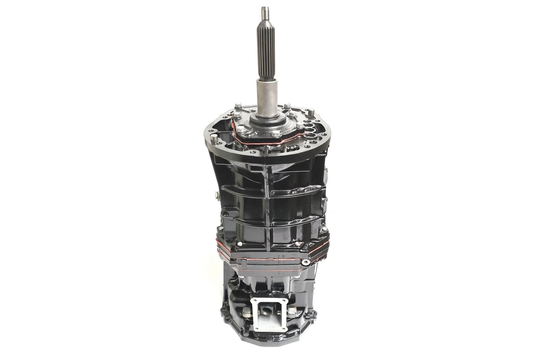

what exactly does the clutch parts do to or with the input shaft?

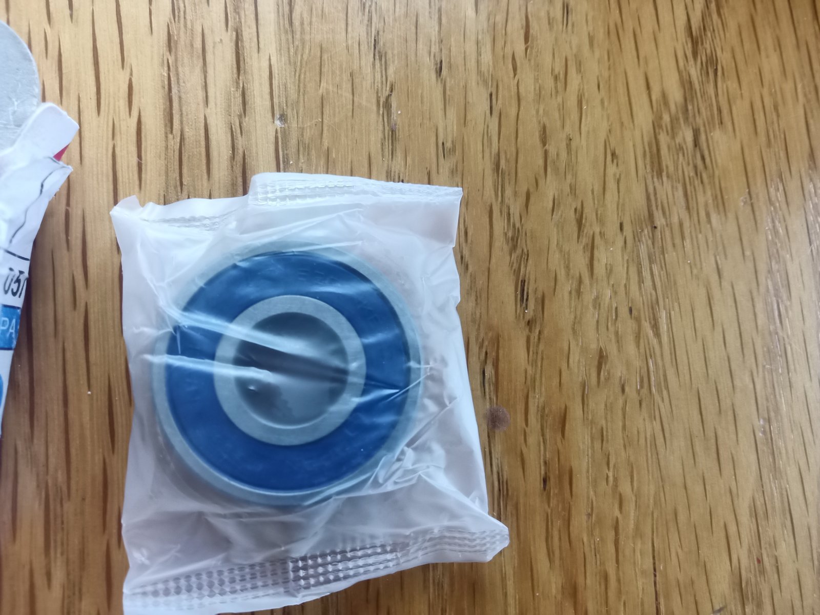

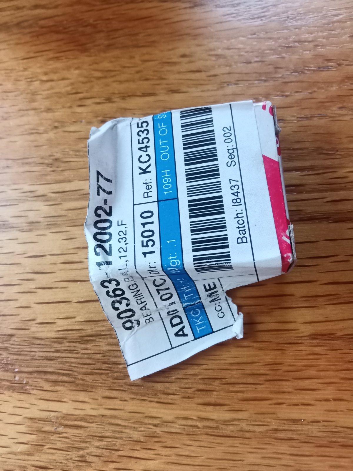

the pilot bearing sits on the tip of this shaft?
Pilot bearing centers the transmissions input shaft to the engines crankshaft, so there's no wobble goblins.
so what part exactly disconnects engine and transmission

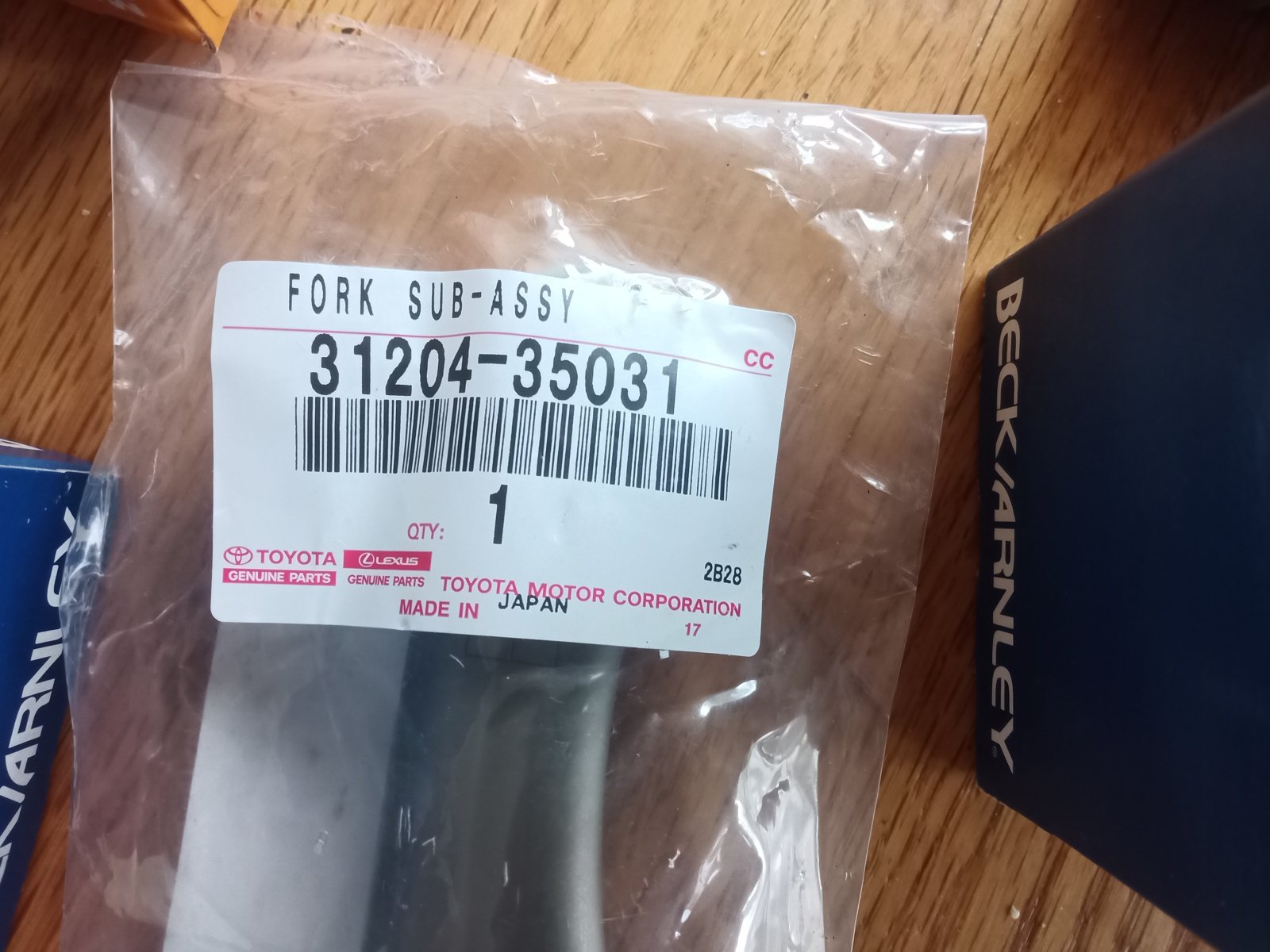

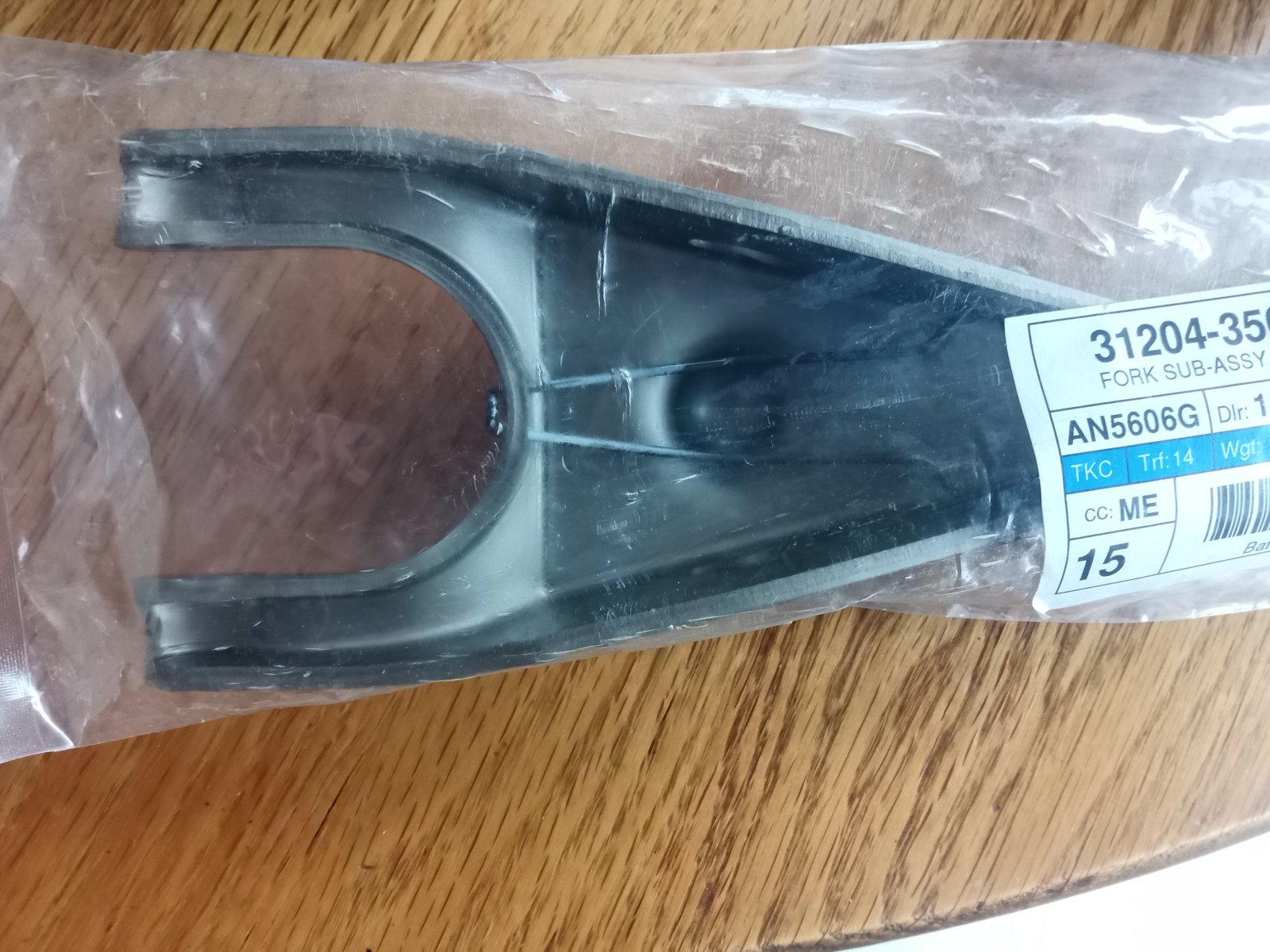

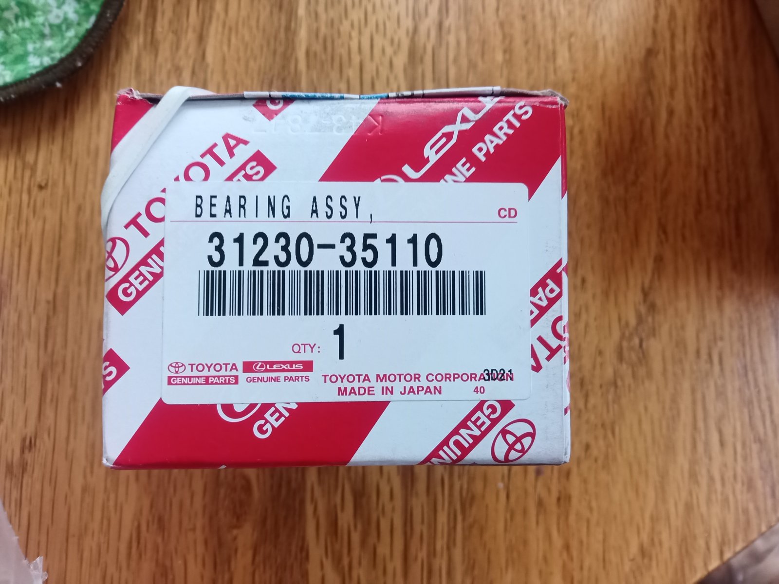

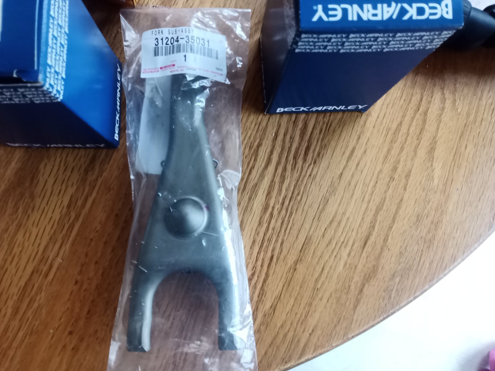

Safely wheeled it into the shop for the clutch surgery
341675 on the 0D0
