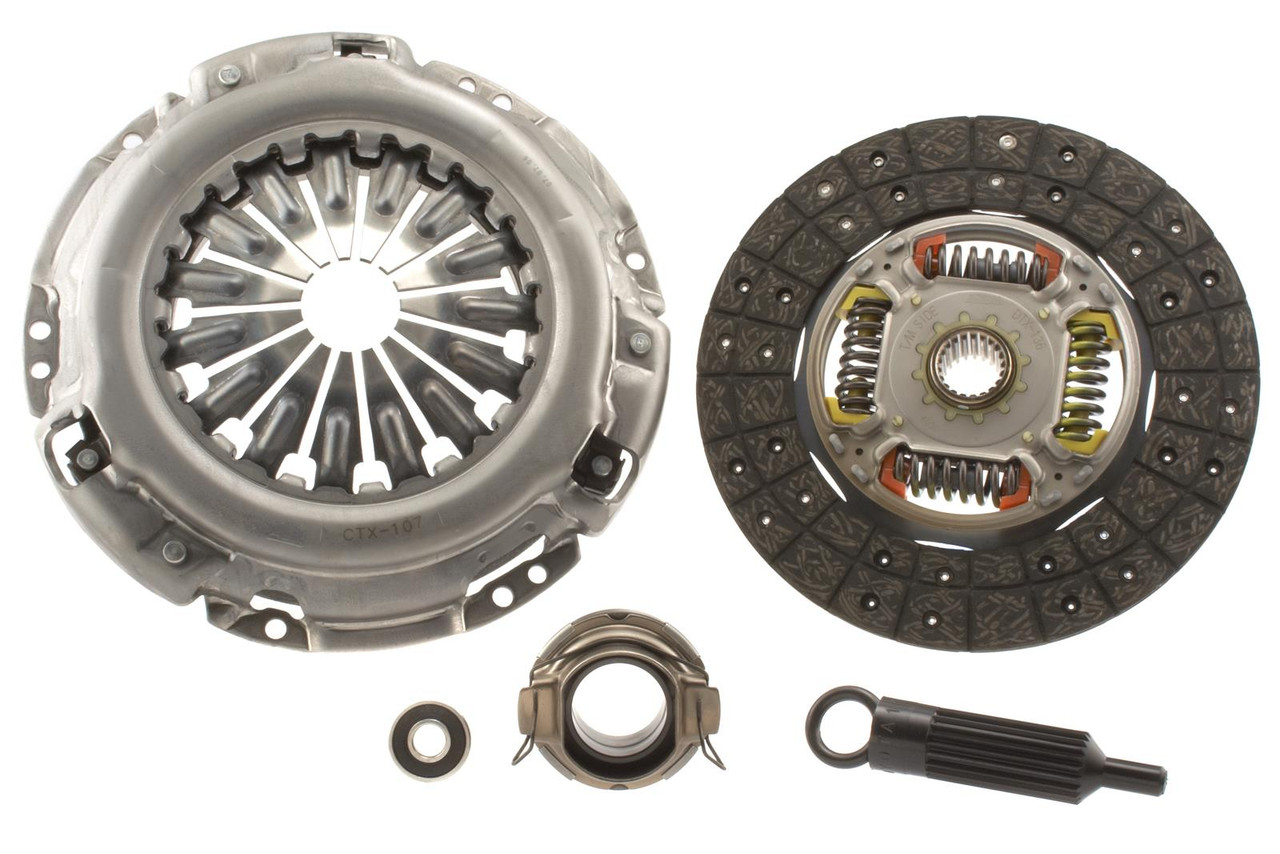

needing a new MT clutch procedure
I am not sure how transmission can get harmed from a chirpy bearing?
Perhaps a marlin cover plate is compatible with a yota disk and flywheel, I shall have to contact the guy and find what to do
Its all about alignment. A failing bearing will lose alignment allowing the shaft to drift out of position. It only takes a few thousandths of an inch to begin abnormal wear hastening damage and eventually failure.
You have stated many times there is vibration that you can not track down. I suspect its in the drivetrain with the root cause being the clutch causing other parts to have problems.
Anyhow, your truck, your maintenance. Do or don't.

Yeah it happens...the fork can crack where it pivots, or holds the throwout bearing, the bearing itself is most common to fail.

It could be a whole host of things.
Throw out bearing,
Diaphragm spring
Friction plates
Heat checked flywheel
Clutch fork
The problem could be in the trans. You have stated many times the gear shift is a bit wonky and finnicky when changing gears.
