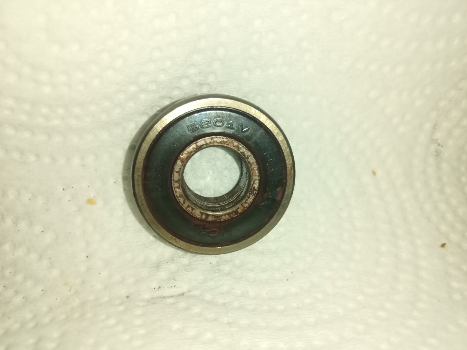

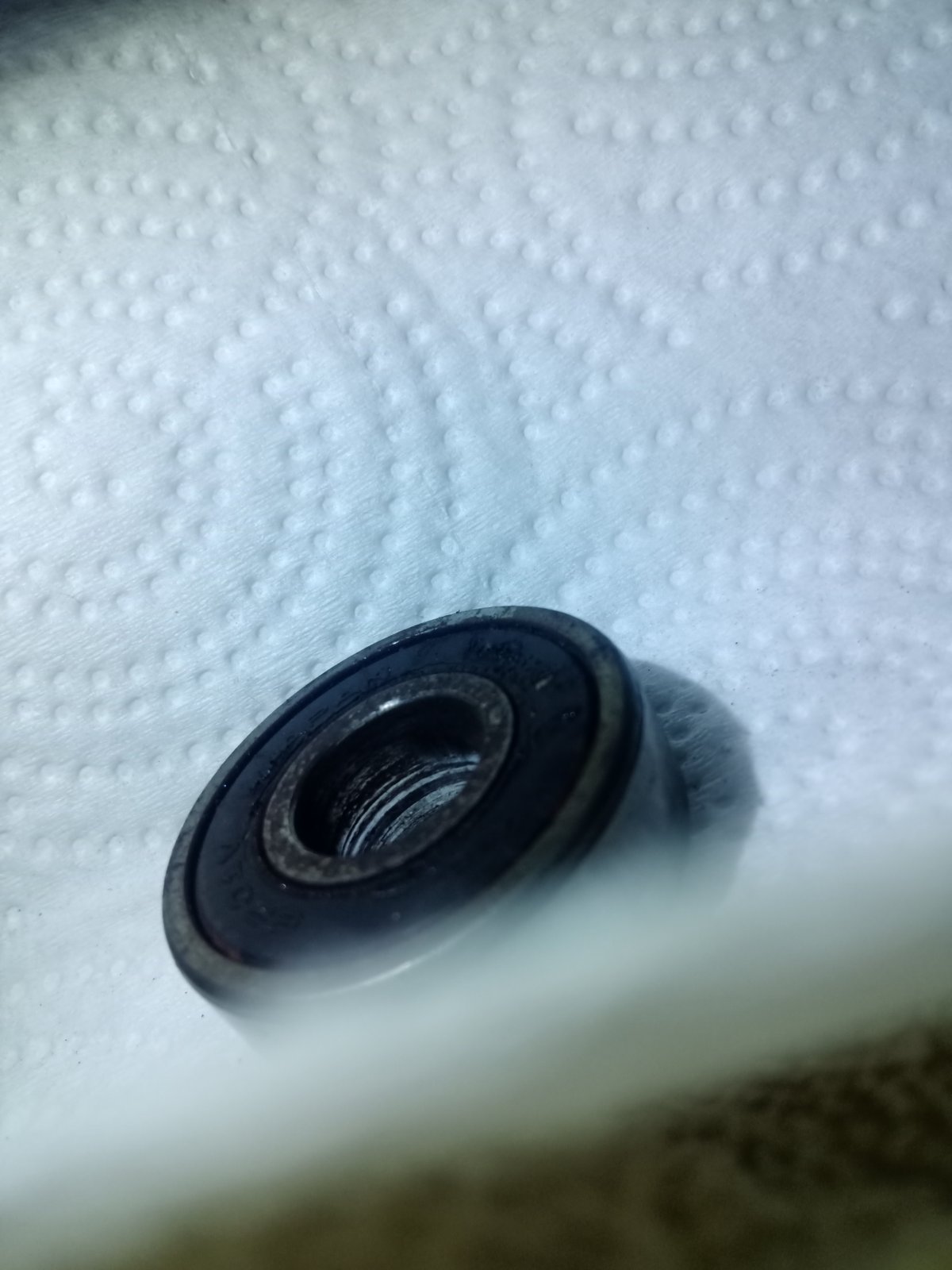

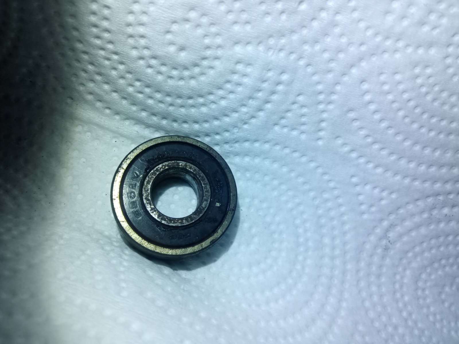

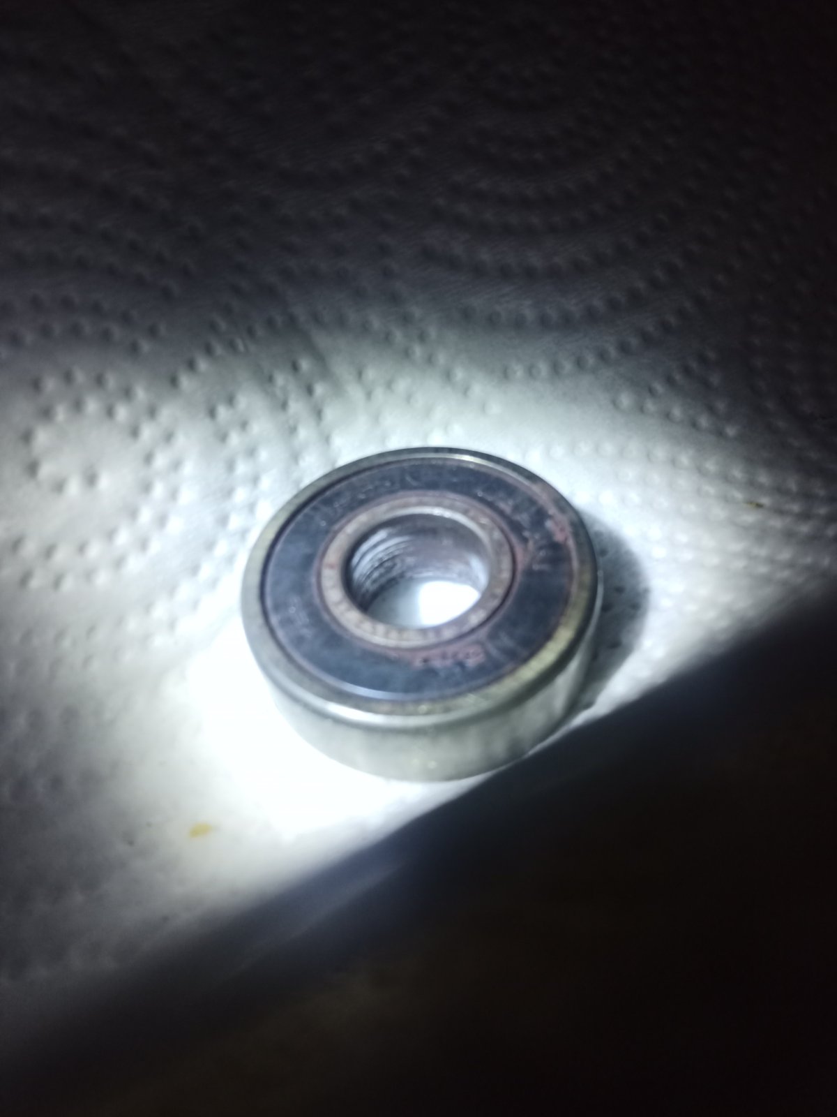

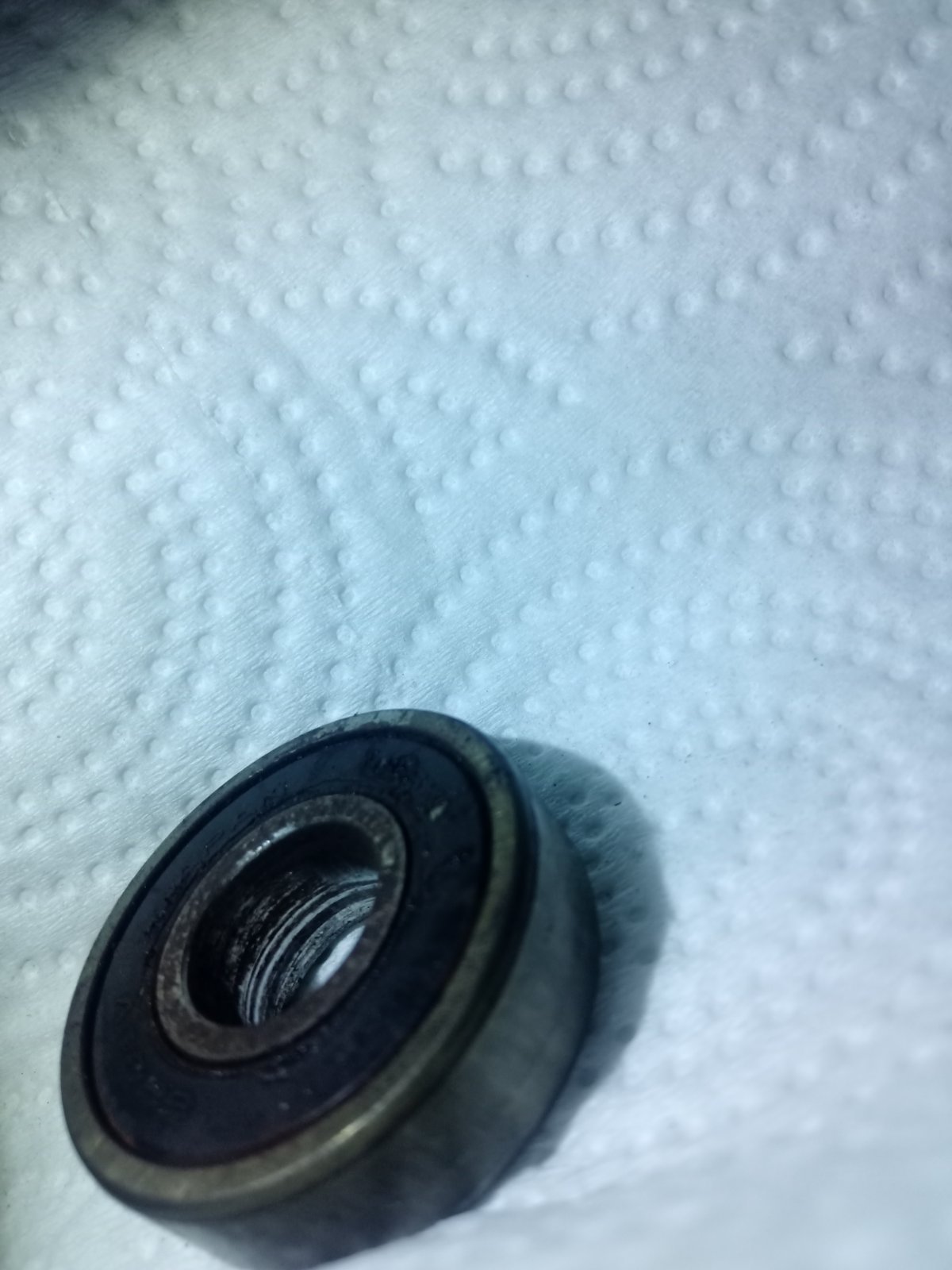

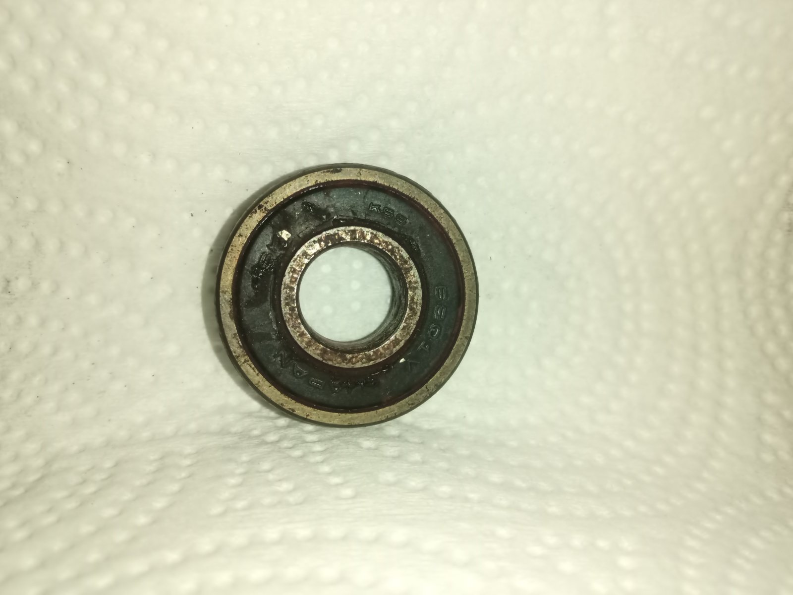

the pilot bearing...
a master toyota ASE certified diagnostic tech with much experience made the call to put me at easement with the queer rattle from 2o19
the wrong call...

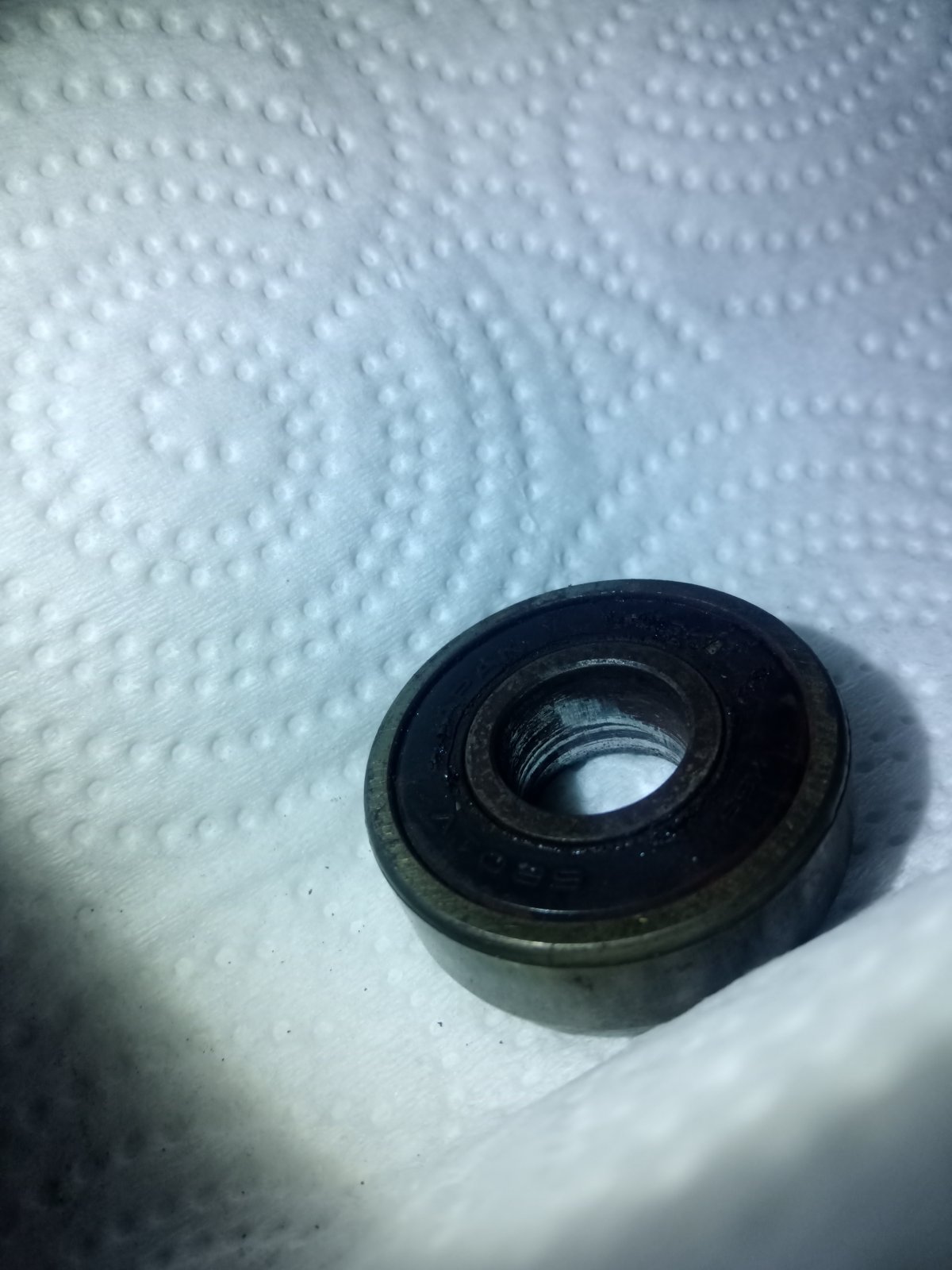

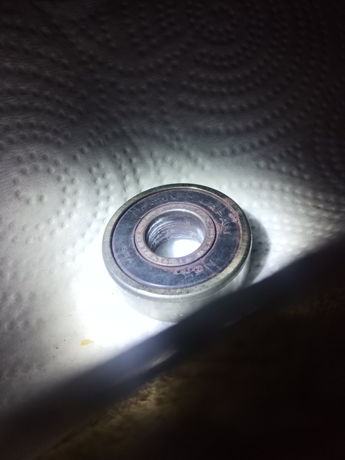

That bearing has been spinning on the shaft. Its either locked up or near lock up or the shaft is undersize.
I'm pretty sure when you rotate the races you will feel notchyness or gritty.......
It was due for replacement many many miles ago.
That is a common angular contact ball bearing of the 6201 size, probably with dual lip seals on both sides. Very common, very inexpensive.
It was probably making the noises heard
BUT! Nobody but I ever heard these noises
The expertly trained diagnostician that inspected said no problem found everything working as it ought
FML
That bearing is in the same family of idler wheel bearings my snowmobile uses for the rear skid. Like said, they eventually get rough, and noisy before they go tapioca. Most of the time, you'll never know until it's too late when they're used in an application as in your truck. Nothing lasts forever.

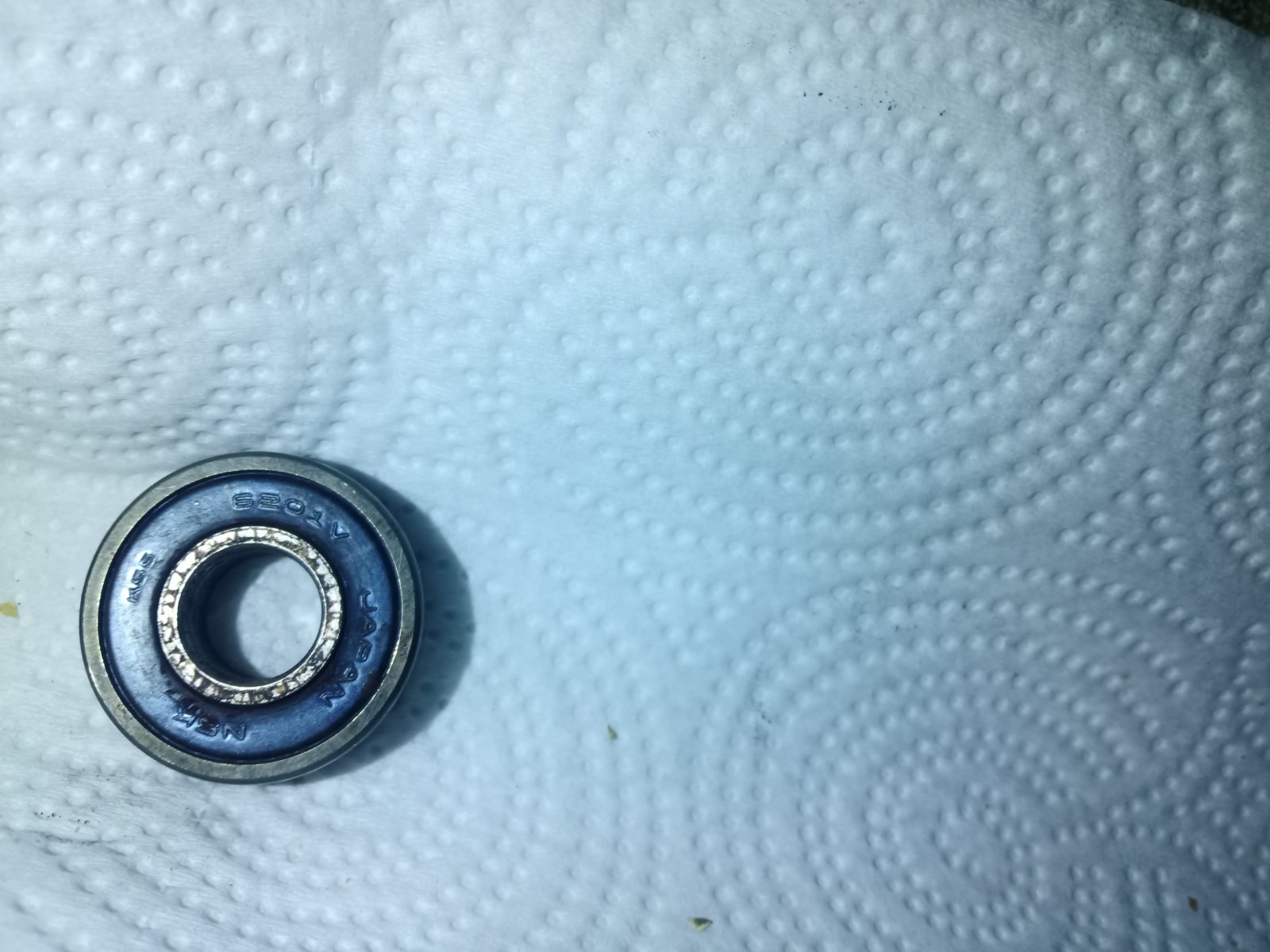

? new OEM pilot bearing ?
1100 miles wheeled onit
its in the 20 degree range today... quite cold out
driving the new clutch around for a bit, warm it all up
get back and leave engine running
put transmission in neutral, let clutch out
hear a noise in the very cold
push clutch pedal in noise goes away
let clutch release out noise comes back
is this the pilot bearing making this noise
should this noise be heard on a new bearing?
the noise is not loud loud but it is definitely there
