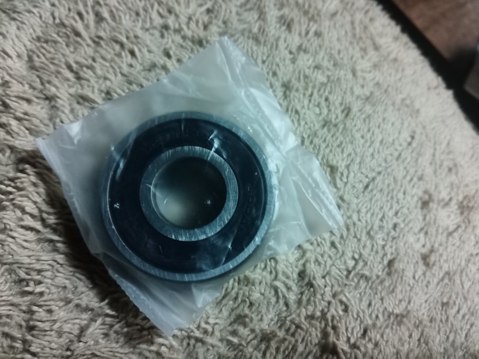

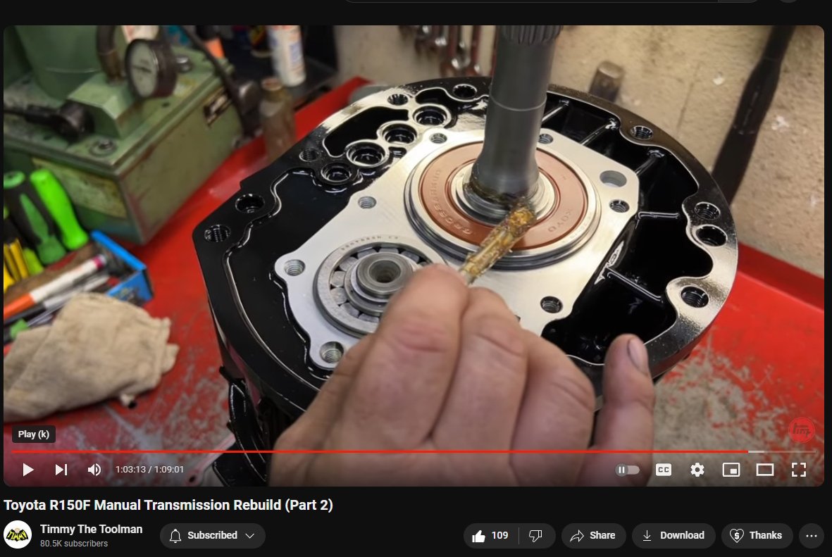

below this is the new bearing on rebuilt
should that be no wobble wobble
