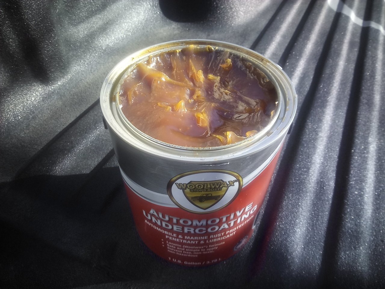

Dude forgot to do the spare tire. I'm not that impressed, vs the cosmoline I did on my truck over 3 years ago. Let's see his truck then....his truck will need a major reapplying. As far as fluid flim, it didn't hold up as well as this guys wool wax, vs doing ff on my tundra.
have i posted pics yet how the regular WW and FF failed in the rear wheelhouse of my truck after the hard run in the rain over 200 miles in Iowa a few years ago
the HV WW has stayed put for several years but has built up a nice layer of dirt and road crud but never washed off yet

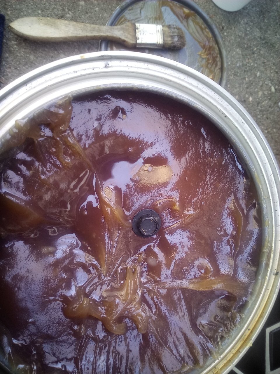

lasting protection that is somewhat easily removable (takes some effort) is WW HV
but collects dirt and is a bit messy to the touch, especially in summer when its soft
