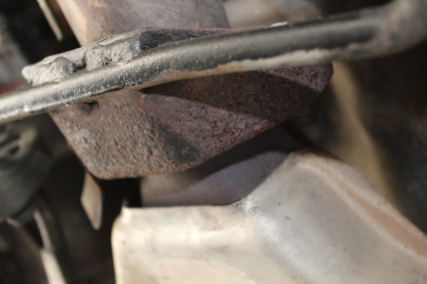

I had the opportunity to check the test spot of black cosmoline I sprayed on the cat mount weeks ago
It didn't smell that I could tell and it appears to be holding up well, just a little hard to the touch.
The rest of that cat mount is very crusty
Maybe it needs a little sanding then cosmo application
Or just spray the cosmoline right over the top of the crusted?
You need to wire wheel, or wire brush all the crusty stuff away, use a rust converter, then some paint. Once cured, you can cosmoline it to your hearts content.
i do have some very high temp VHT paint (cost 50$ for a pint!) for it but it won't adhere to rust that i am aware of the cat mount is in a very tight confined area to get at easily with the truck sufficiently elevated
doing all of that is very overkill if the cosmoline will sufficiently just cover it up make it look badAzz!
a pic could help, i can try to get one or two shots
Use a good oil based paint.
here is a pic of what i am looking at on the cat mount
maybe that piece the black cosmo is sprayed on does not get all that hot, i have never tried touching it after a hot run lmao
it connects to the rubber mount hangar things so perhaps it does not get hot, i never thought about that, where is my head at o_O
Even a high heat resistant paint is going to eventually fail. It's just the nature of the beast when it comes to exhaust components. Your lucky its lasted that long.
