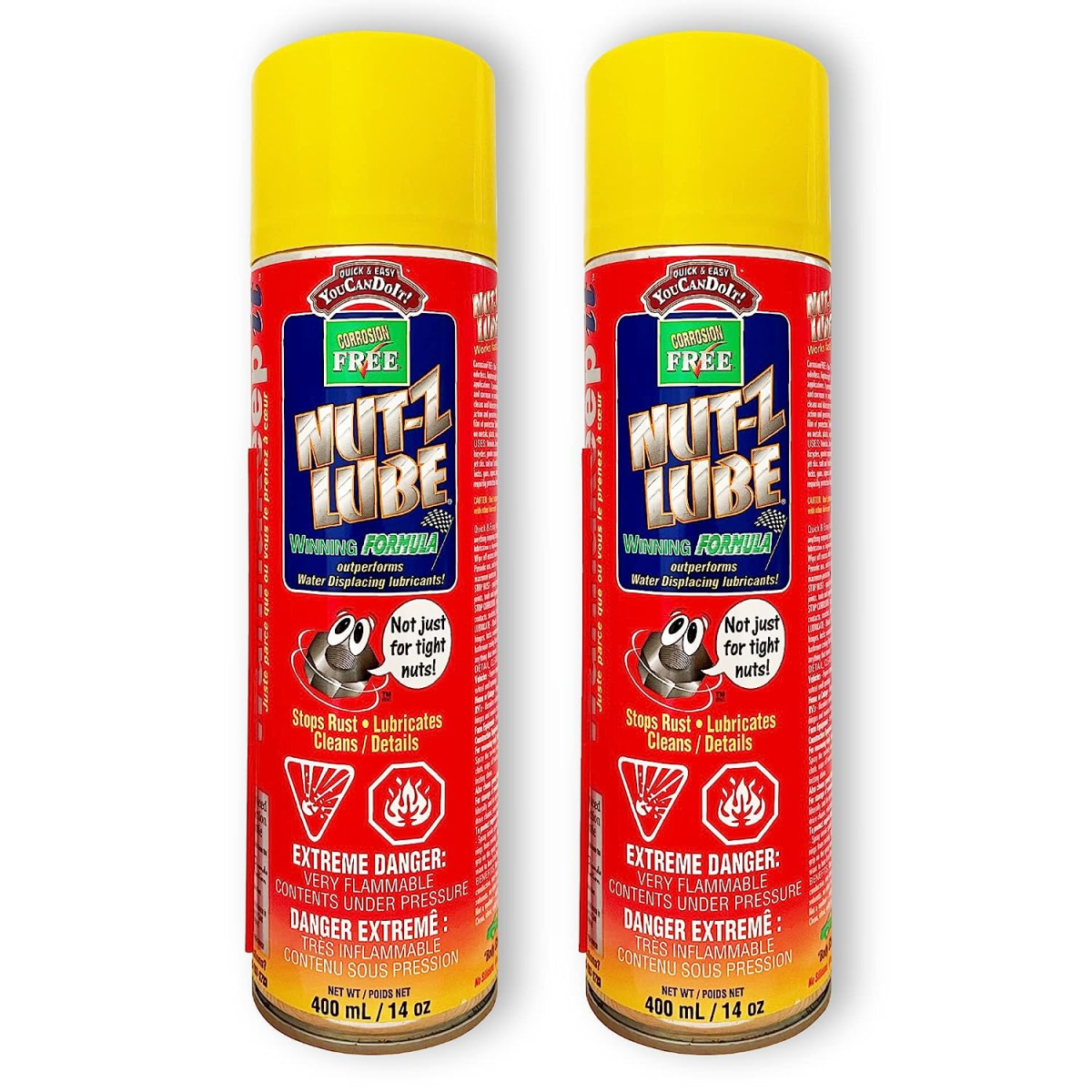

They do make the best penetrating oil though! PB Blaster
I like PB Blaster, it's good, but in the early to mid 90s, when I got into restoring Triumph sportscars I found something better. Haven't seen it since. It was in a purple can and was labeled as a Castrol product. When sprayed, it was a thick foam, like shaving cream, then started slowing liquifying. The liquid lubricant would then penetrate down into whatever you wanted lubricated. Come to think of it, and mentioning the Triumphs, I got that stuff when I ordered a bunch of parts from Rimmer Brothers in the UK for my 62 Triumph Vitesse Sports 6, small chassis Triumph, originally had a 1.6L inline-6, dropped a built 2.0L inline-6 in its place. Had triple Weber side-draught carbs. Have I ever mentioned I love inline-6's?
Anyway, just checked their site... No dice. Don't have it anymore. You could put a little bit on top of a bolt head, it would work its way down the threads, and in about 12 to 24 hours be all loosey-goosey.
I've mixed 50/50 acetone, and marvel mystery oil, and brushed it on rusty bolts....in minutes I've been able to removed the seized up bolts. Recently used the mixture on an old Honda snowblower that had some real crusty hardware in it needing to come out.
