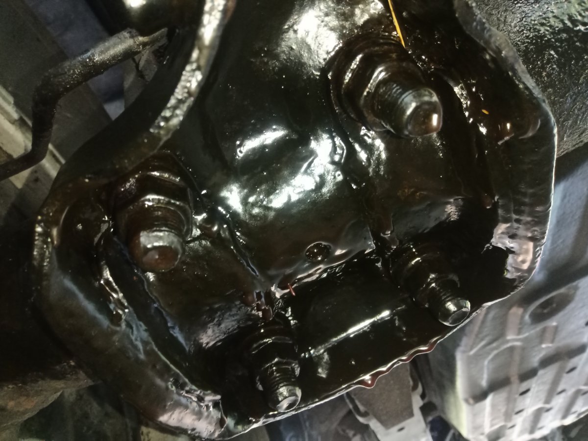

Undercoating
Looks pretty encapsulated. Where the rest of your suspension parts?

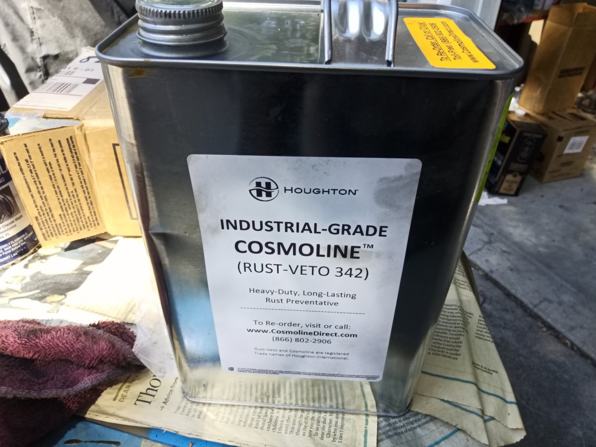

Gotta get a wand, or gun, and spray it on. Hope you power washed any wool wax away before applying the cosmoline. If you don't it may cause a reaction. The cosmoline won't dry...just stays greasy, and drips...at least thats what happened when a buddy applied cosmoline over fluid flim.

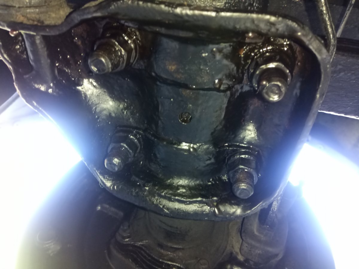

i mentioned earlier (or thought i did!) that most all crust was abrasively removed from the back of the axle housing 3yrs ago and i put 2 heavy coats of chassis primer,
so the crust is very limited to tight areas i could not get the blaster gun into... going to hunt for a pic from years ago if i took one
the black WW just looks real crusty LUMPY :(
I used fluid flim and it didn't do well here in the northeast on my tundra. Our wet climate causes it to wash away being lanolin based. I've had real good luck so far with cosmoline. I save the fluid flim for my lawn tractors mower deck.

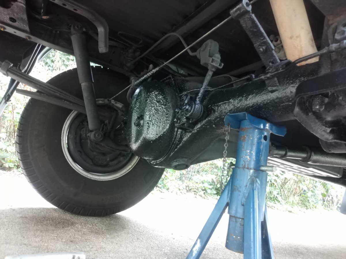

It was pretty much a noon to 6pm job when i did my truck, and it was a very hot afternoon crawling around in those 3M coveralls. I think i sweated over a gallon.

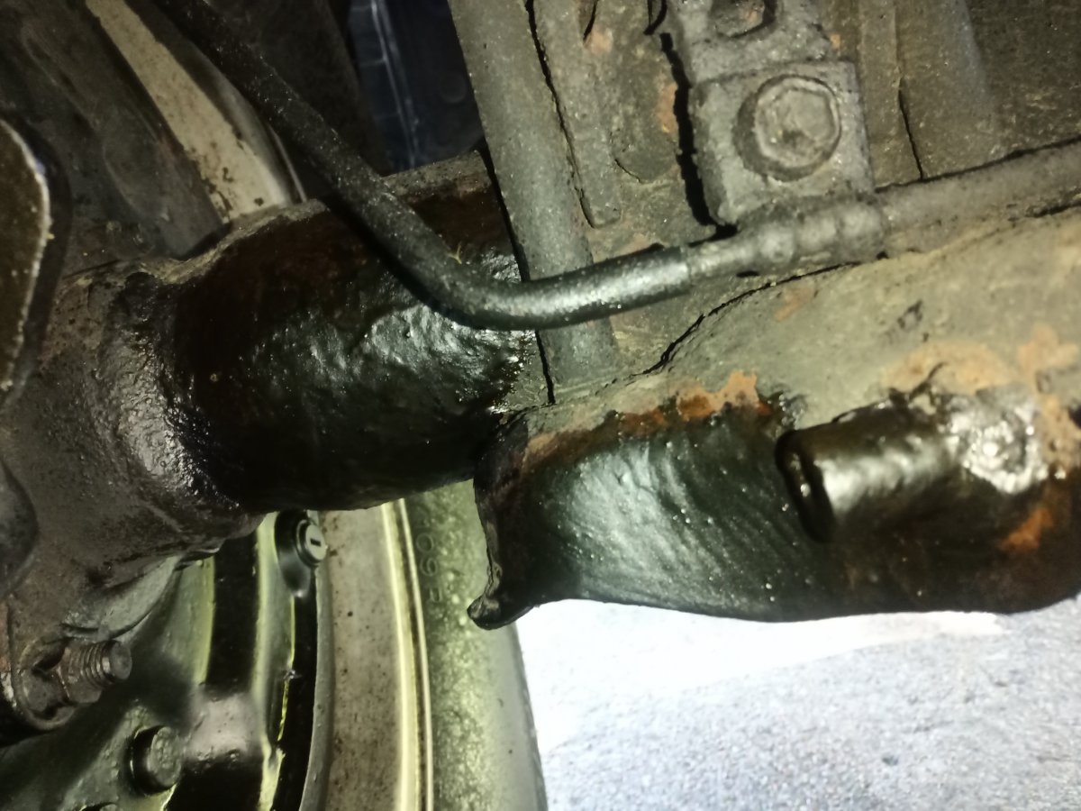

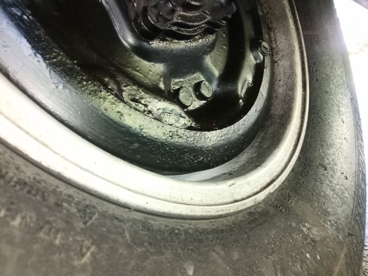

Can you take any pics to show how yours turned out?
This job I did looks good at a distance but up close with a light it's a waxed lumpy looking
No pictures, but i worked with a newly painted chassis/frame...it was a new truck, so imo this was much easier to do. All i can tell you is its not lumpy one bit. Still looks like a fresh painted chassis. I hope to keep any rust at bay long as possible, as it gets real bad here quick.
