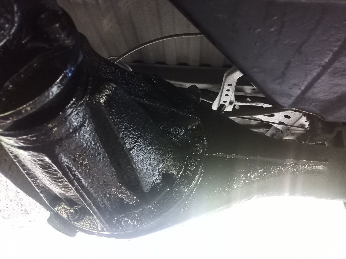

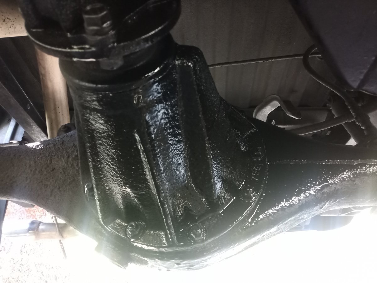

Undercoating
I'd be carful where your spraying that stuff. I don't think you want it creeping into any oil seals like i noticed on the differential pinion gear.
oh no! :(
i tried to limit the overspray cramped under there stretching to reach at it
and i don't even know what pinion gear is, i shall have to research that!
oh no! :(
Its in your differential where its bolted to a flange that ties to your u-joint. Theres an oil seal around that flange. Last thing you want is this cosmoline collecting any dirt causing abrasion with that seal as the pinion gear spins the driveshaft. If that seals ends up leaking fluid you'll likely know the cause.
cosmoline is going to attract dirt now??
i thought i was trying this product to get away from all of that mess :confused:
...got the first bit of mild rainy driving with it yesterday, over 50 miles, the water should bead as a wax would? and keep its slick look
Dirt will build up on a cosmoline coated surface just as it would on a bare frame. There's no getting around it. People go to car wash's. I don't wash my trucks, but i am careful where i spray cosmoline. Idk, if you'll ever have any issues, but you certainly don't want to try, and create one.

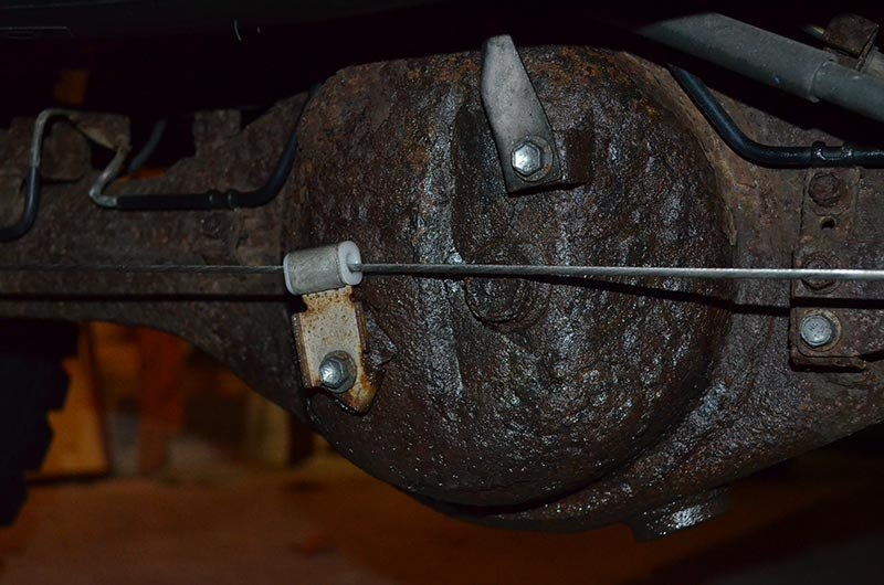

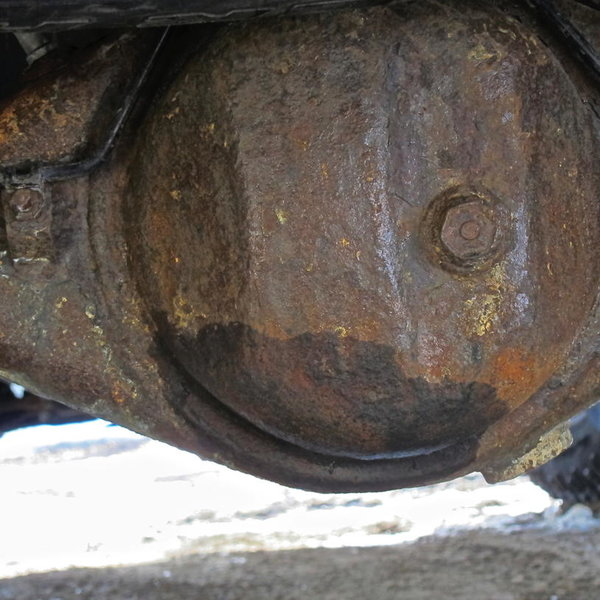

axle housing parts can rust through!!! i have seen pics of saturated rear diff gear oil on the back cover where the fill plug is at (not sure what that part is called)
this is from Maine
this is not mine LOL
just a random web pic from the state of NH
this report of a Gen1 in ChicagoLand
