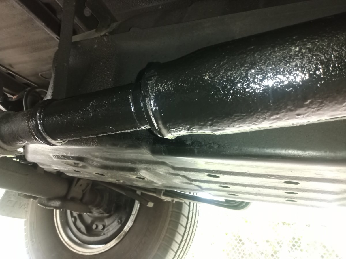

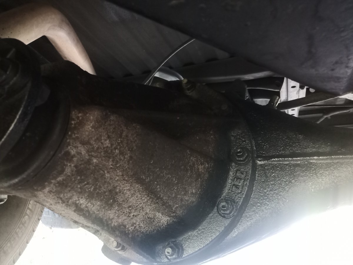

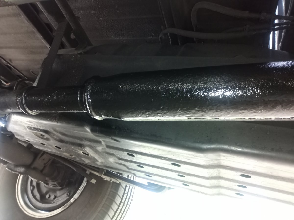

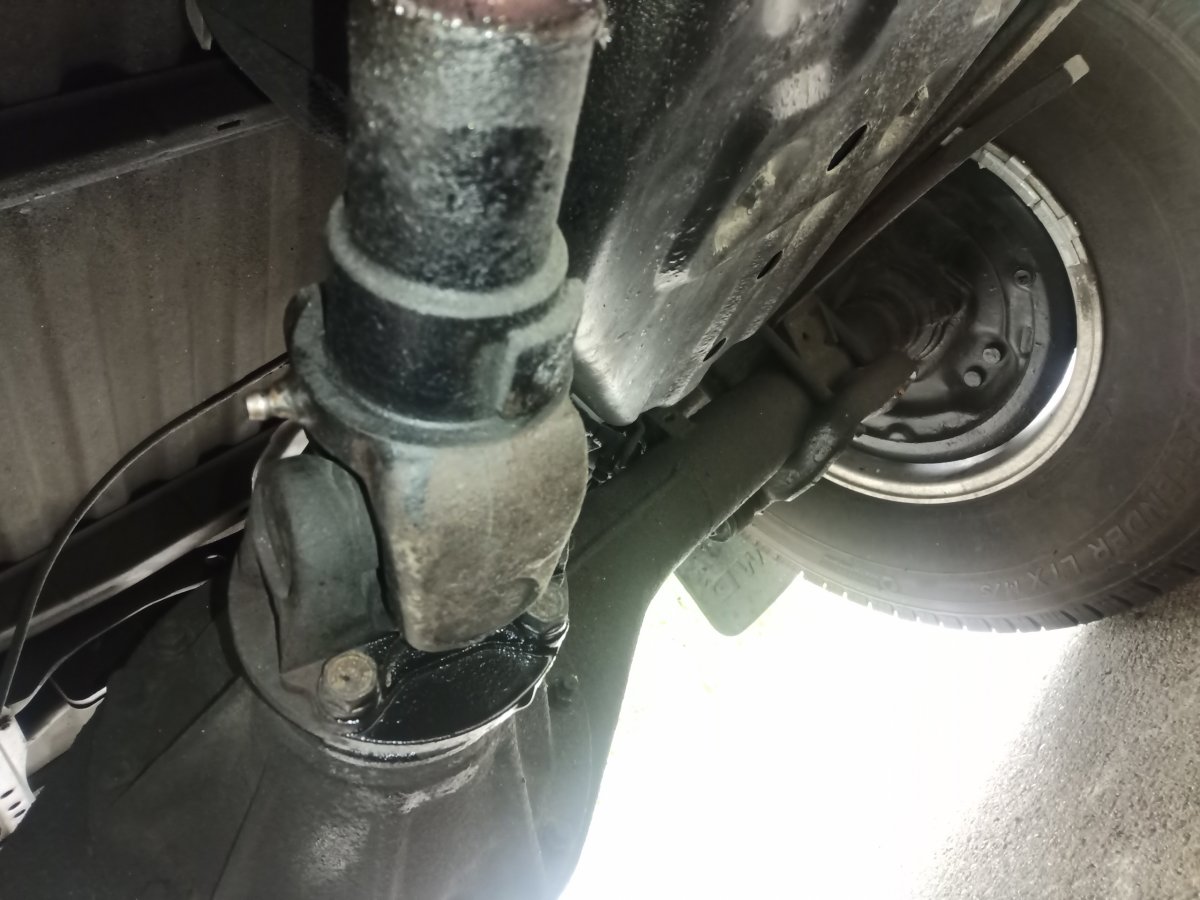

Trying some black cosmoline on that weathered driveshaft
It's definitely drippy
There were no instructions on how cold it can be to properly apply, it's barely 50 degrees out this morning
IMG_20221015_111650_391.jpg IMG_20221015_111604_213.jpg IMG_20221015_111521_122.jpg IMG_20221015_111358_833.jpg

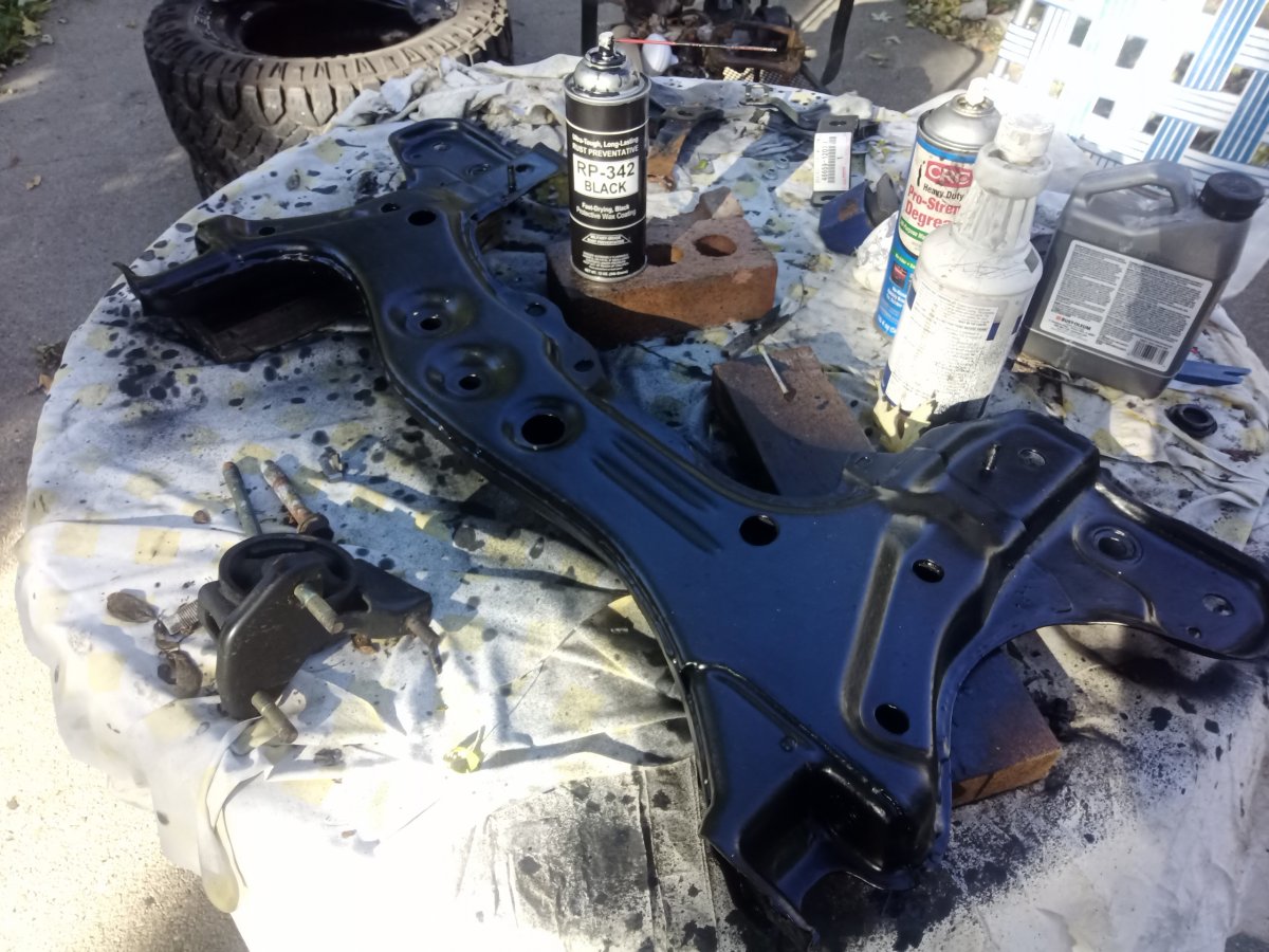

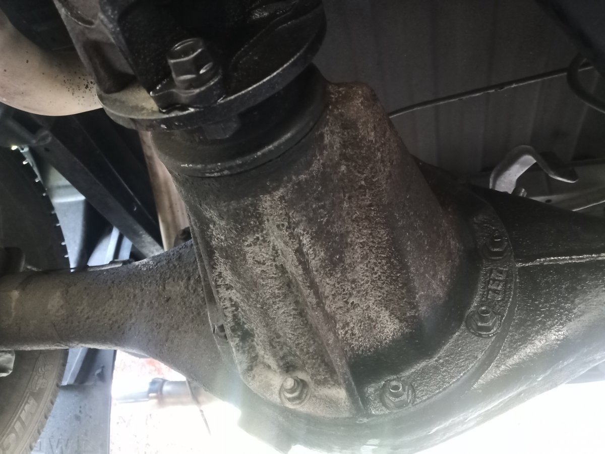

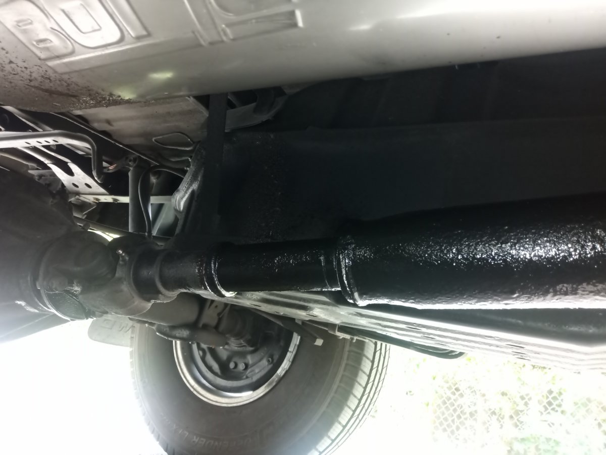

black cosmoline on the engine cradle for the old Corolla
Next up are the new moog control arms and OEM brackets
Don't forget to do the insides.:rolleyes:
All in all that subframe was not caked in rust, just a little around the edges that I could tell
I abrasive blasted that off to clean metal long awhile ago and put some chassis paint on it last year
Brakleen to the rescue lol... I can't breathe underneath here cough cough
It removed all that dirty WoolWax that did not blowoff
And now I shall coat with magical black cosmoline potion to make it good looking hopefully
