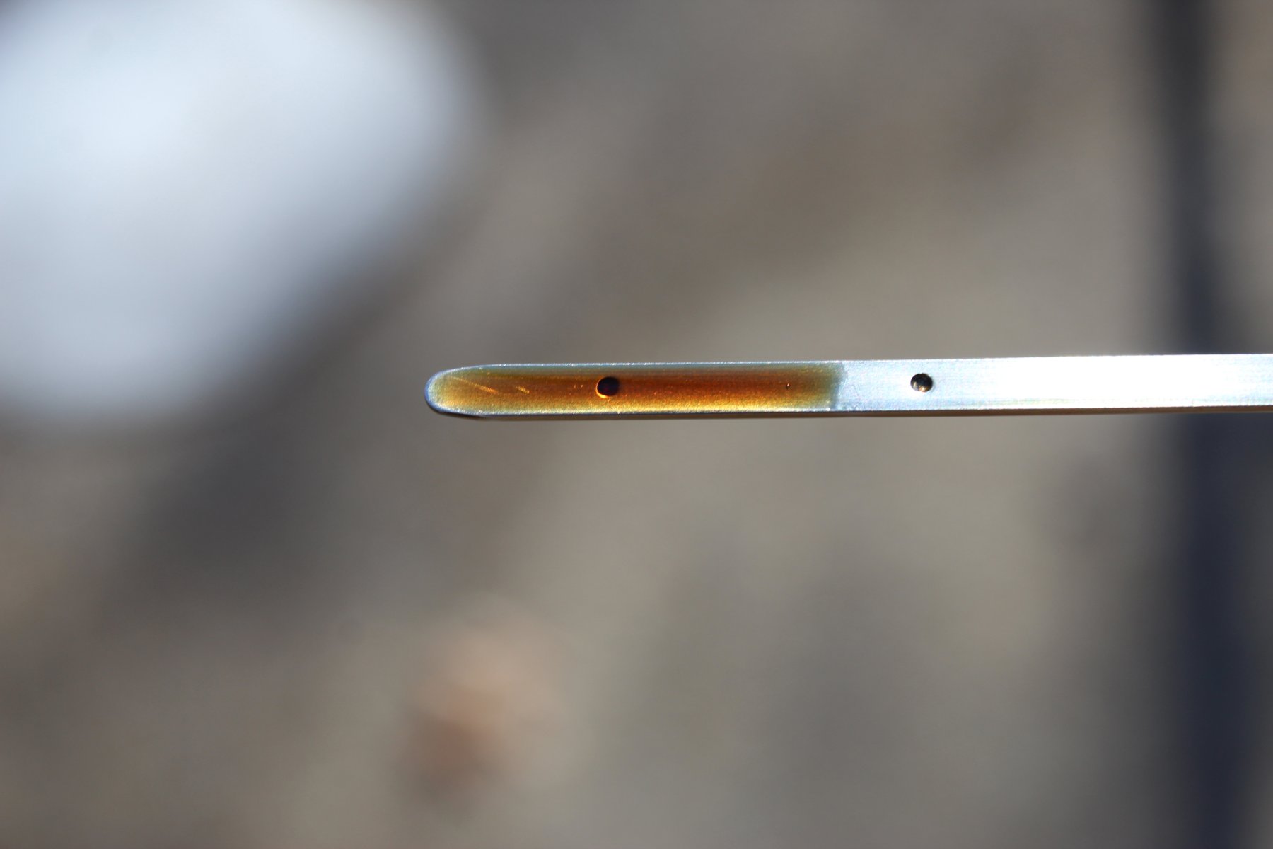

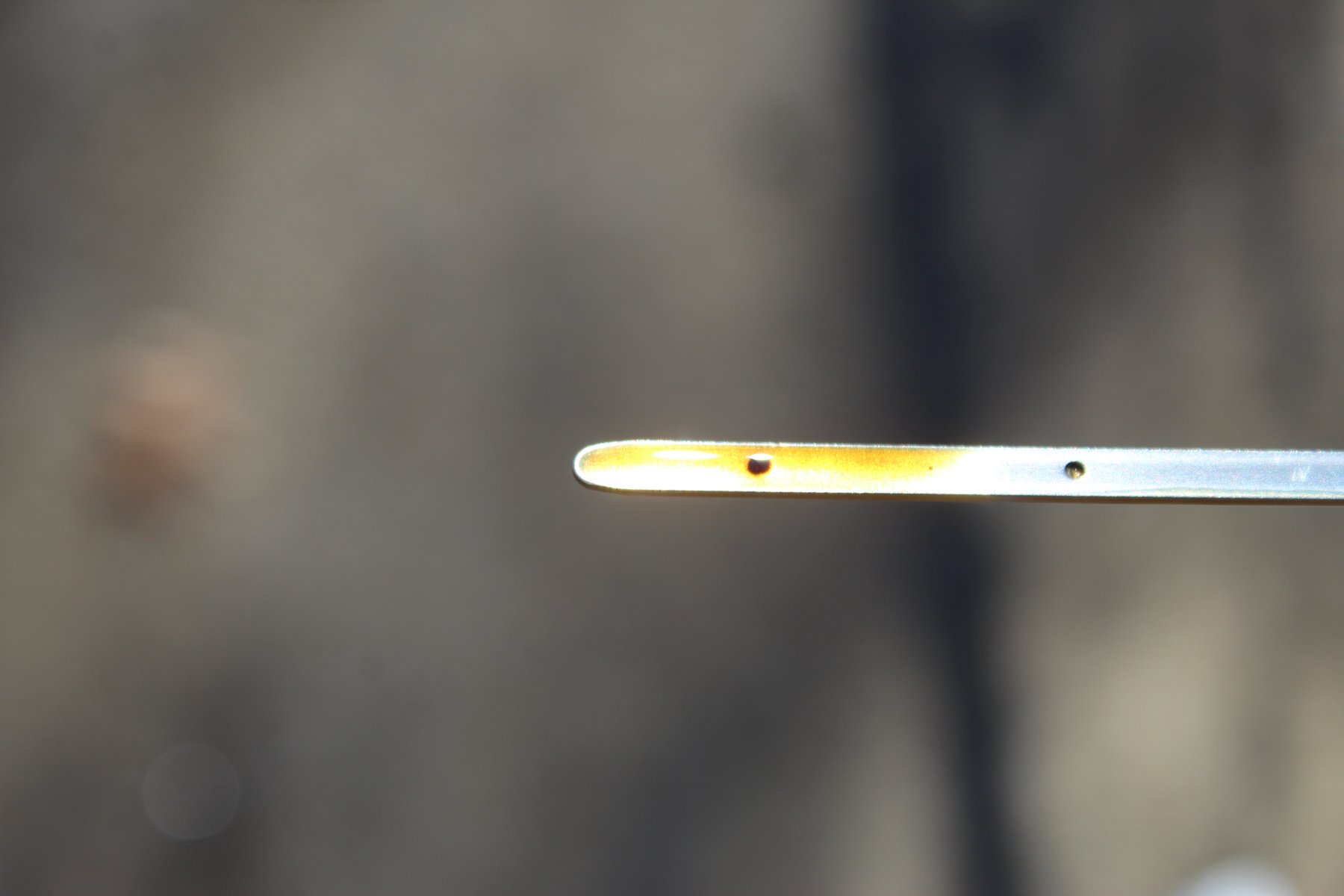

FWIW, no one can determine the condition of oil using visual observation. Shoot, some oils of the same viscosity and different brands have different color fresh from the bottles.
