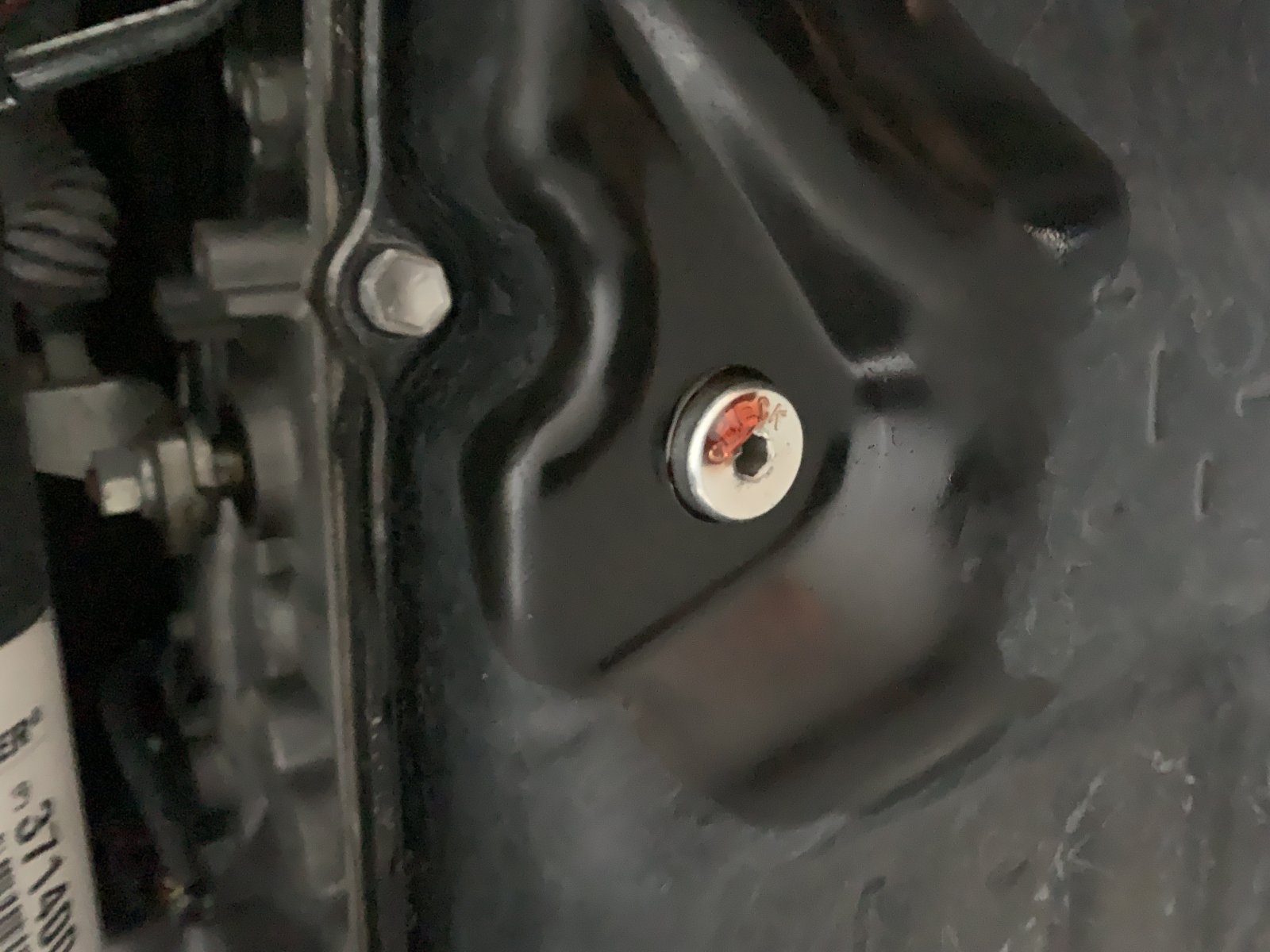

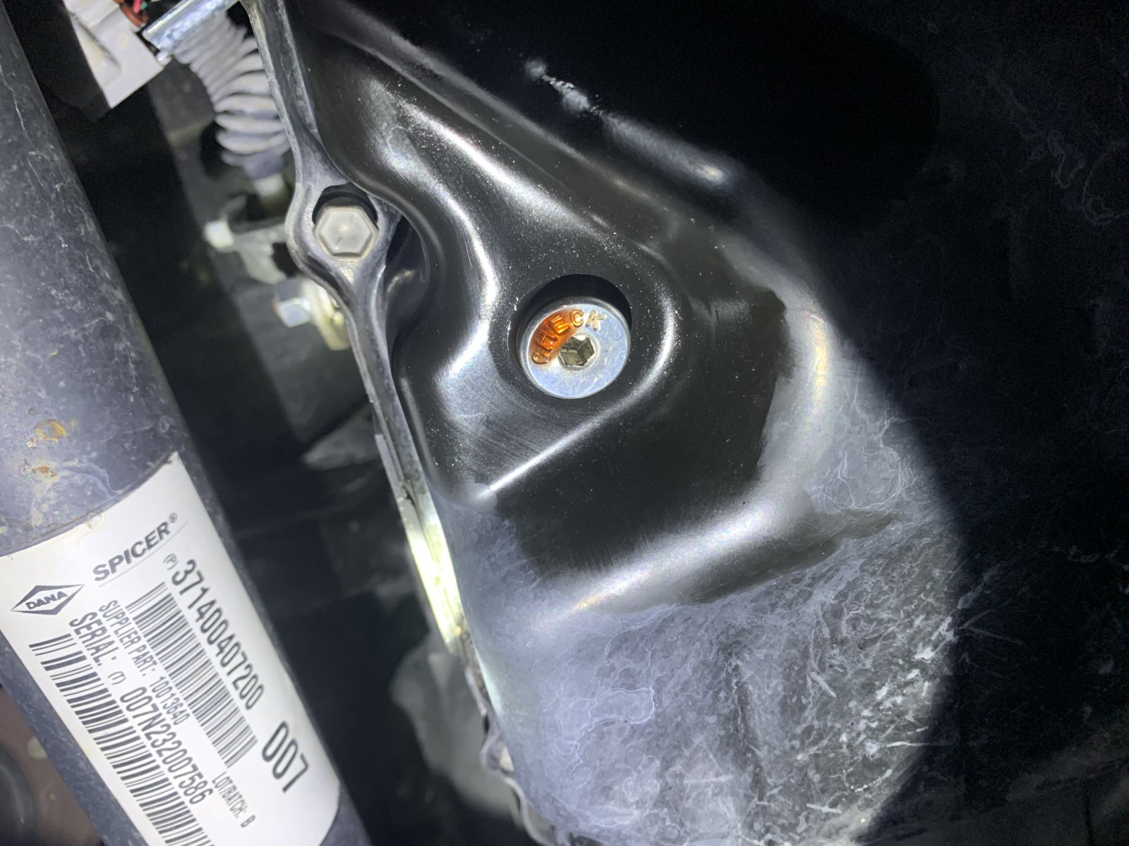

Well just had it towed back to the dealer. Leaking ATF from the bolt he removed to check ATF level. Didn’t replace the crush washer. They are going to keep it and try to get the Toyota field rep out there this week. At this point I don’t even want the truck back. I’ve never regretted buying a vehicle. Very disappointed in Toyota right now.
Surprised that original crush washer is leaking. I've never had to replace them in my tundra when changing the transmission, or other gear oils.
All of the instructions I’ve seen for checking ATF levels say to replace crush washer. Not sure how else fluid would come out of the check.

Are you sure they even put the old crush washer back on?
No not really. It is possible. It could have fallen off while he was holding the bolt. He took the bolt out, we stood there and watched the fluid drip out, he put the bolt back in.
I know when I did my tundras fluid, many times the crush washer would stick to the transmission, or other components that I was changing the gear oil in...then fall into the drain pan unnoticed by me. I had to go fishing around in that stuff by hand to locate the crush washer. I never bought new ones.

It is still at the dealership. Haven't heard anything. Last I heard still waiting on the Toyota field tech to check it out. The dealer did say they drained and replaced the ATF and put a new crush washer on. So the leak should be fixed. On some FB group there are several people saying they have the same issues.
