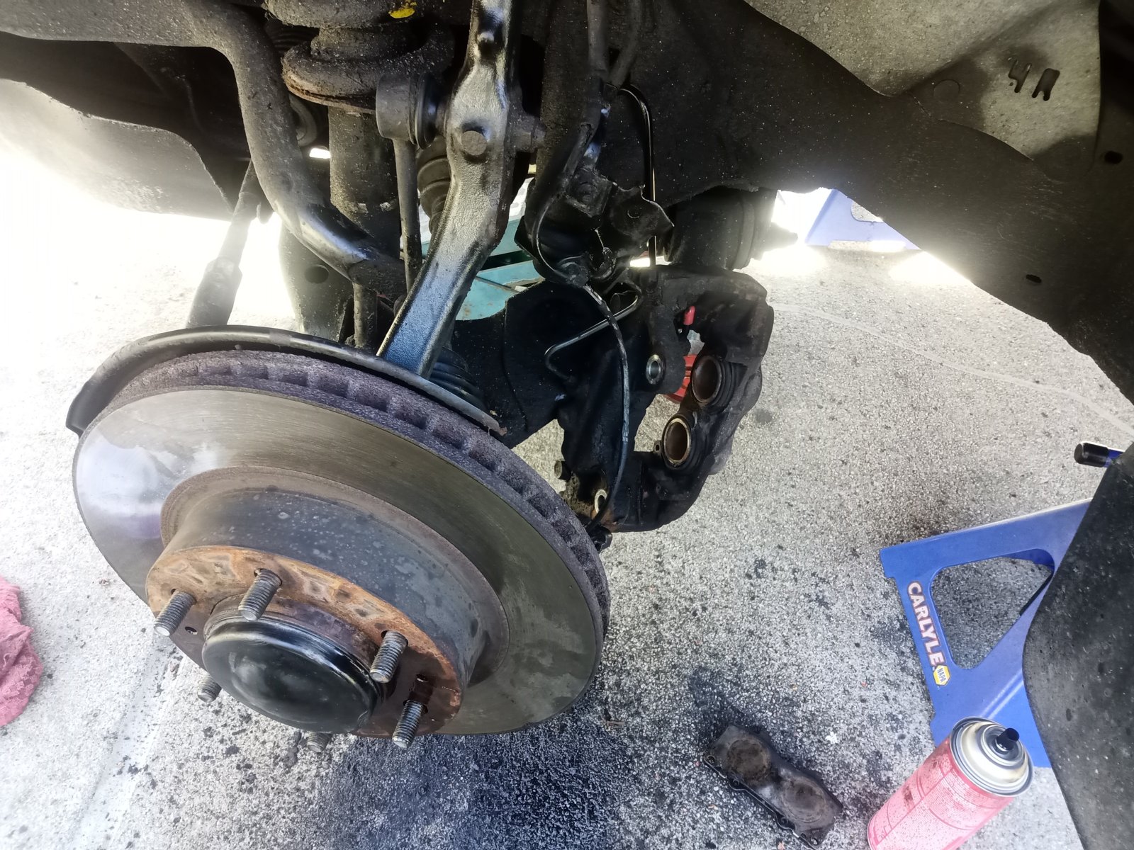

front brakes + rotors on gen2...
Most taxing part today was again trying to get that abs sensor plug out
I kept jamming the screwdriver in and tug tug tug
Just wasn't budging much
So if I broke it will the abs warning get lit up??
It's connected to the caliper somehow?
Or the brake line bracket
Or I really don't know now
I saw it unplugged in that uTube video
Those pistons were quite crusty inside on the passenger side also
Probably have to monitor that for seizure
Big coin to pork out on the next brake rotor change
Then why did you need to move the sensor. You can carefully move the entire caliper unit without messing with the abs sensor.

I had to replace the calipers on my tundra....they were noted for going tapioca like that. They weren't all that expensive buying remanufactured, or refurbished units...worked better as before.

Less than 50$ each??
Umm....I think the locking tab is a push DOWN and not a pry up.
Push the locking tab down, wiggle it and firmly pull. Don't gorilla arm it. There is a weather seal on the connector. The seal is probably filled with silt and fine dirt from the miles of road schmutz.

Caliper for my Gem2 was around $150.
The girlie with the ink in the uTube stuck a pocket screwdriver in there to remove the plastic connector
