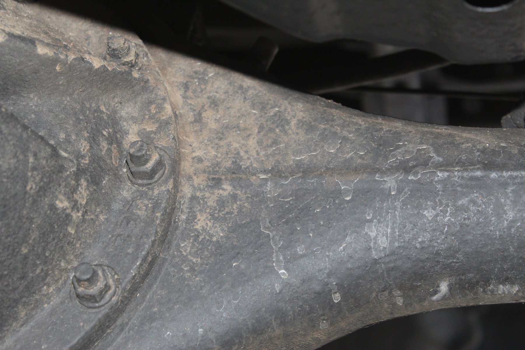

it looks like tar or rubbery gunk to me!
FF would have all kinds of dirty gunk onit, yes?
Fluid flim that doesn't wash away will attract any dirt to stick to it making it look like someone slopped grease, or roof tar on it. That chassis appears it didn't see a ton of miles on wet roads over the time its been owned.

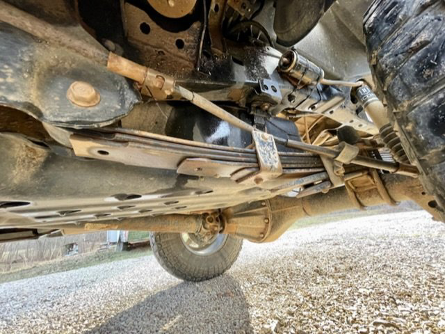

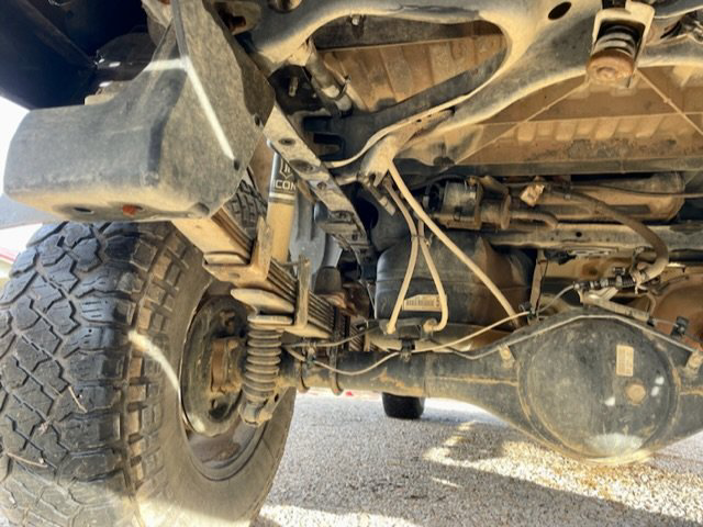

2o19 Missouri taco
St Louis area
No undercoating
Truck is for sale at 73k miles
this is the black cosmoline after a good amount of winter miles
looks like just dirt and white salt crust onit
will it harm the cosmoline any to wipe it clean with some wd40 and a rag or two?
shine it up some!
Wd-40 could remove the cosmoline completely as does paint thinner. You have what appears salt spray and dirt. I get the same on my truck but it seems to eventually wash away when I travel wet roads. I never wash my truck. I'll let a good rain storm do it.
