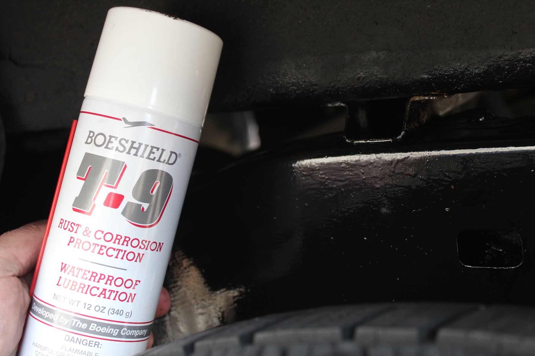

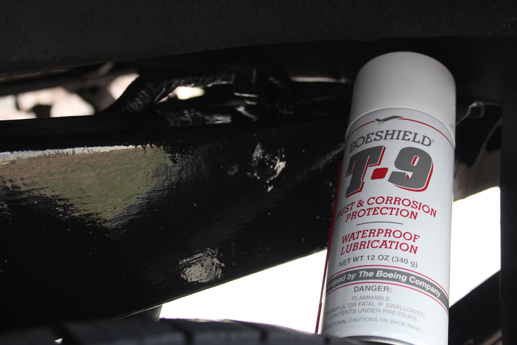

After getting done with the afterwinter dirty tacobed scrub I spritzed the hose on the area that I applied that boeShield on the frame in wheelhouse area
It beaded up real sweet just like wax should
Hopefully it will last a lot longer than wax. I use to spray heavy duty silicon on my older compact 4x4 toyota pickups, but after a rain storm of two, you were back to square one.
